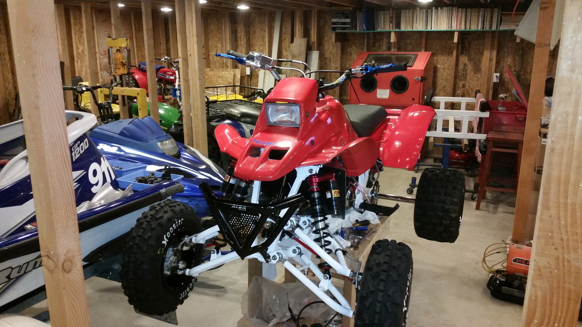

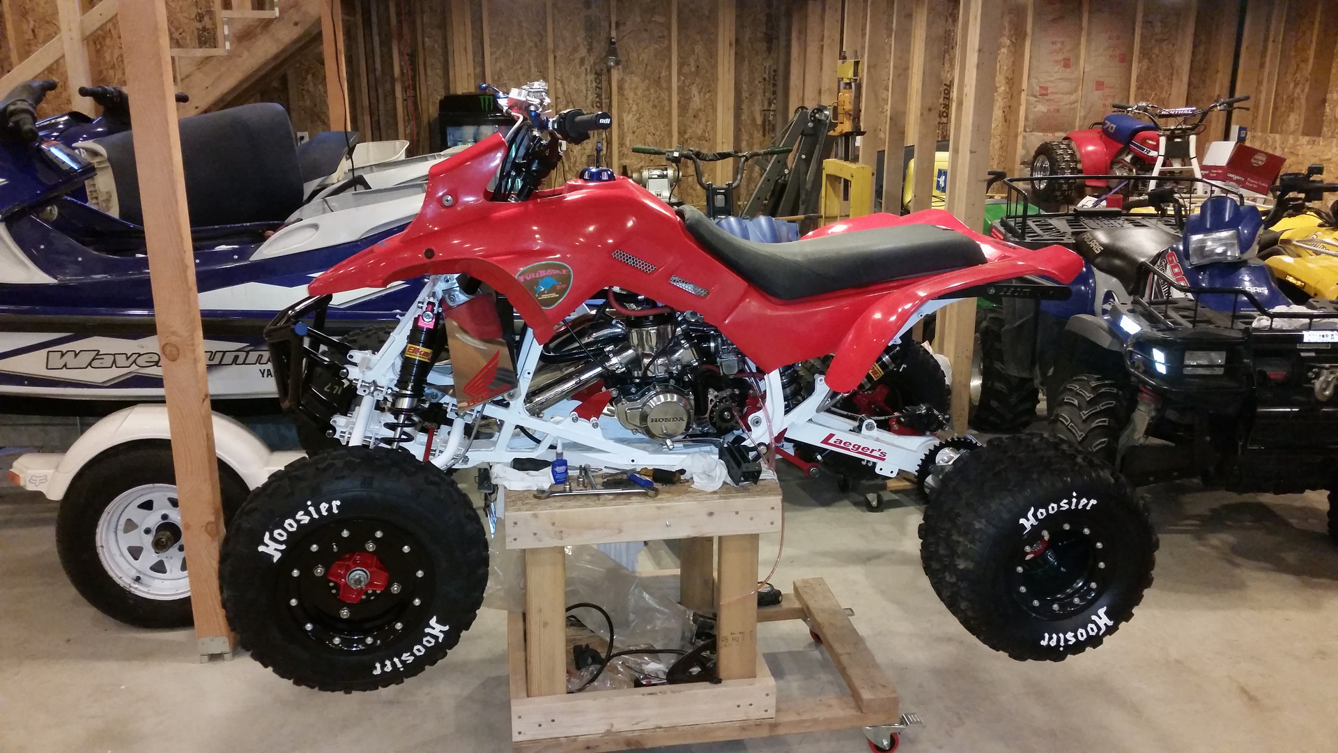

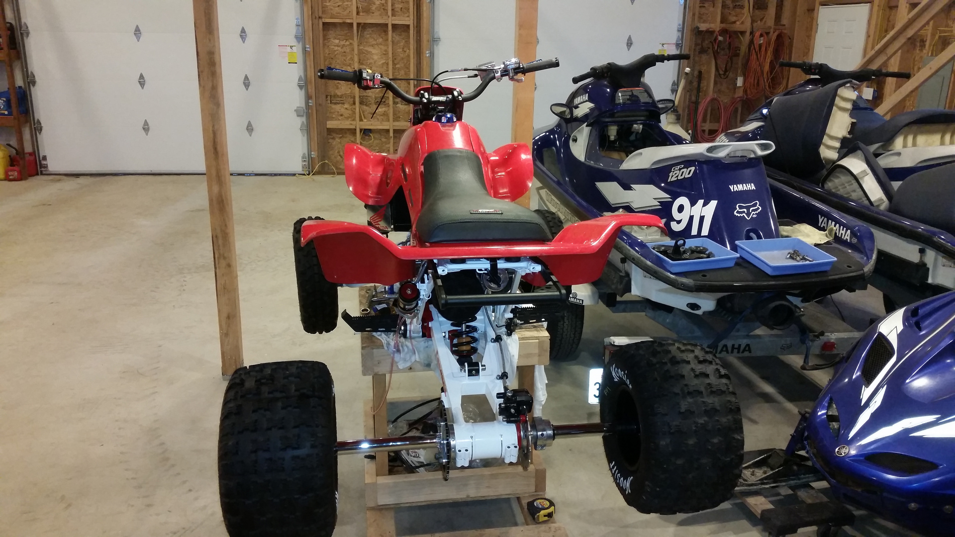

« Reply #31 on: February 21, 2016, 08:52:27 PM »
Not getting a whole lot done have some other things done  so here is where it stands

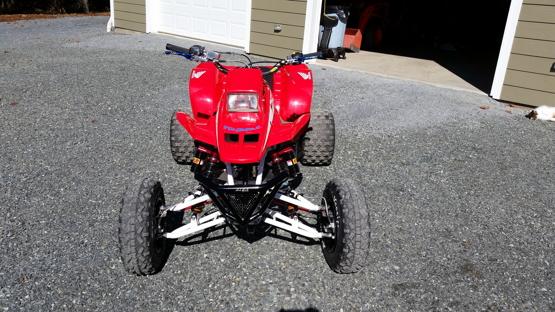

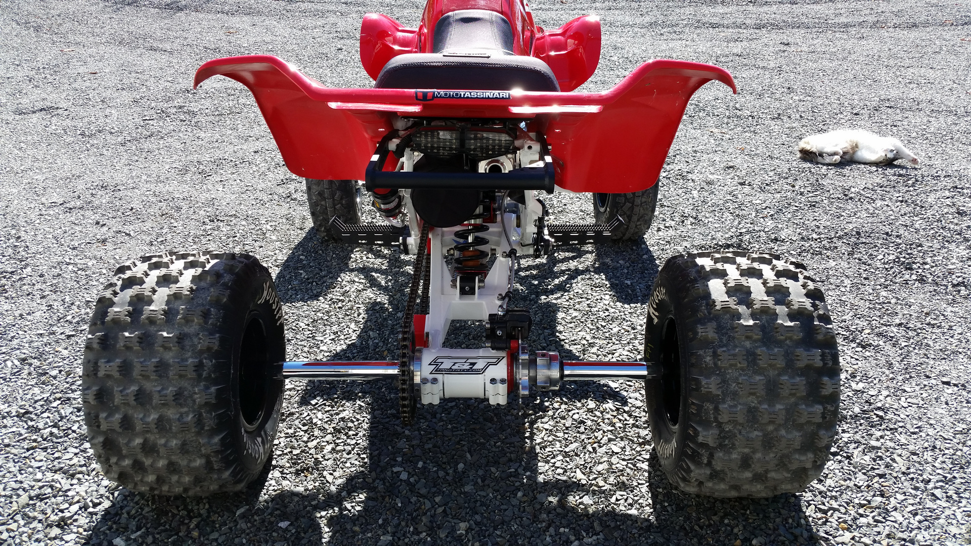

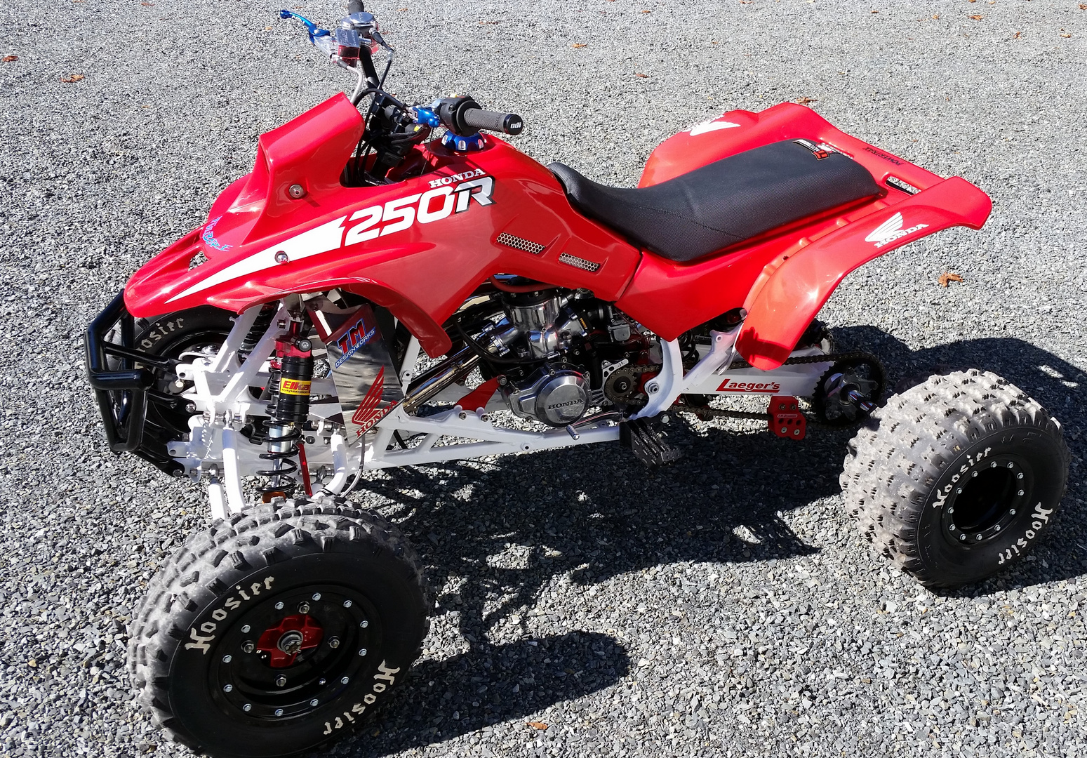

Offline 250rmanpuma
Finally done
« Reply #34 on: September 18, 2016, 01:07:42 PM »

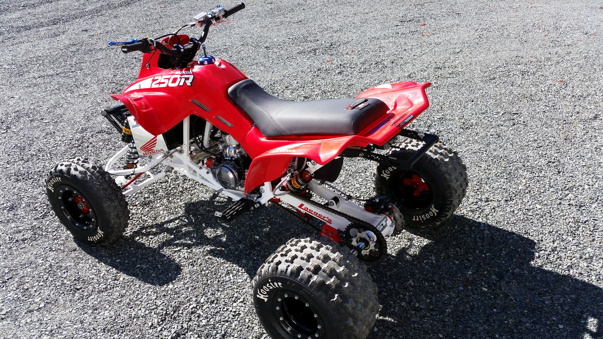

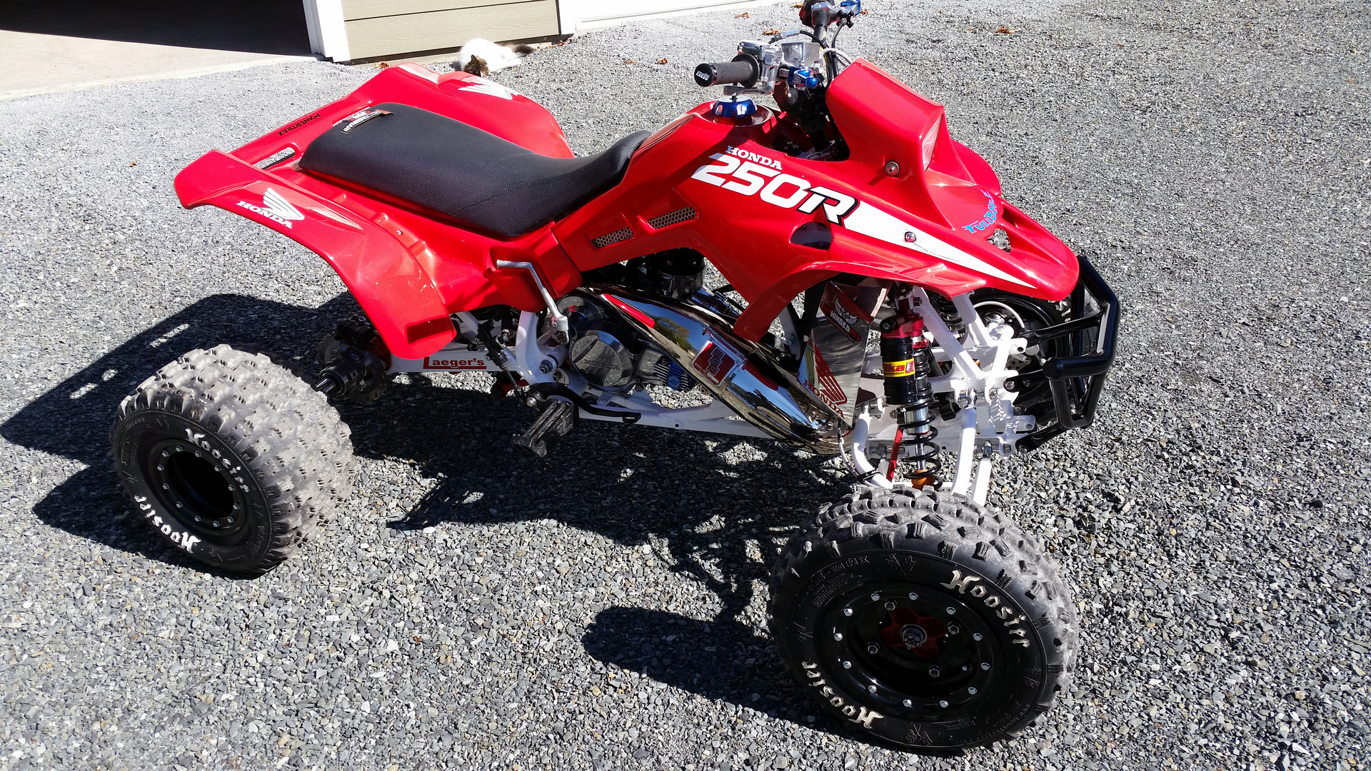

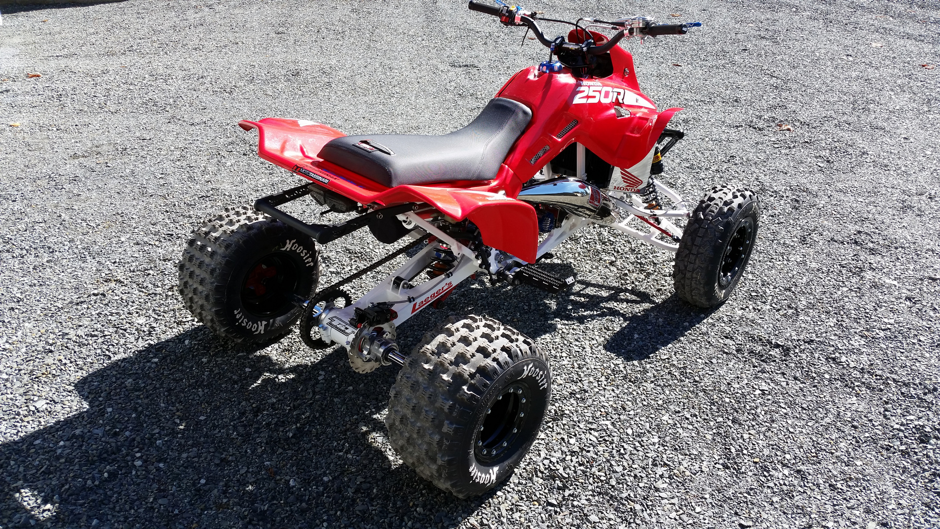

Ok,  Finally I got this bike 100 percent complete.  Had a electrical issue I was dealing with for months.  ATVguy got me going.  I am running 110 as I did a compression test and Im at 200 psi of compression. Here is a complete list of mods.
Frame: Stock
A-Arms: Full Flight +2,+1
Shocks: Elka Stage 3
Front Hubs & Spindles: 400ex
Front Brake Calipers: Yzf450
Wheels : Alba Beadlocks
Swingarm : +2 Laeger
Axle : +4 Durablue
Body: Old School Full Bores
Electrical: Stock plus 4 degree advance
Pegs : Unhindged ATV pegs
Carb : 41MM TM Mikuni Flat
Intake:Cone with large air filter
Exhaust : CM ESR 9 pipe
Motor :  Ported .50mm over with CR Head gasket.
Clutch: Hinson
Tailight: R6
Front Bumper: Alba TRX450r
Rear Grab Bar: Unhindged ATV
Reeds: V-Force Delta 3's
