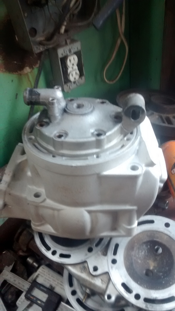

Offline Rupp250
Saber 569???
« Reply #8 on: November 22, 2015, 09:35:26 PM »
This is my sphinx head on a liger. Just for size comparison.

Quote from: Rupp250;61223
That's insane how much bigger the liger cylinder is compared to the sphinx. And the cr500 liger is a 97 mm bore if I remember right compared to a 78 mm on the sphinx. 95, 97, 98 mm bores are ridiculous. I can't imagine what it's like to pin the throttle on one of those when the motor/carb is  dialed in. Socket popper. Lol. Must be like trying to ride a rocket.
