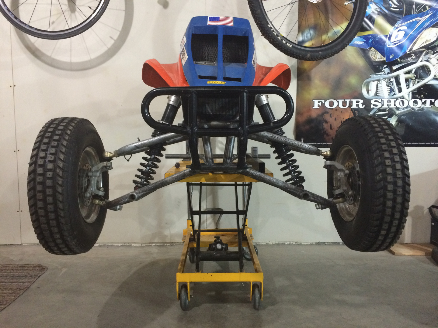

Latest chassis project Integrated Shock mounts Yfz front end for my 500 Ice quad.

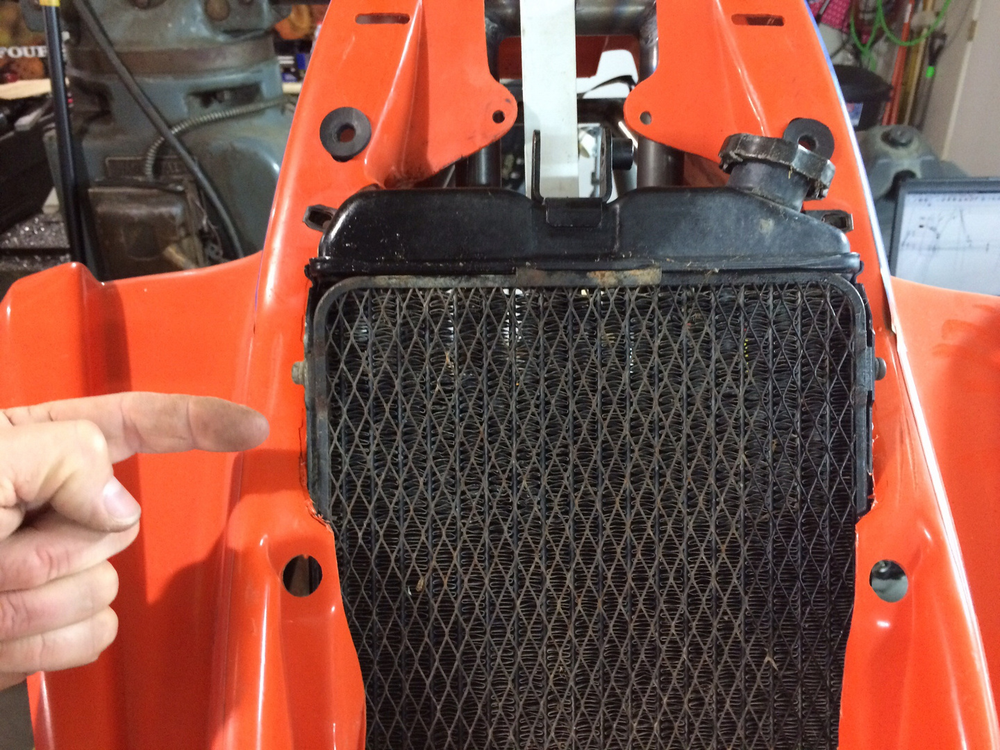

What do you mean by "integrated shock mounts"?

Like this
Shouldn't be too long now. Making good progress.

I see, that's definitely new to me. It's looking cool.

Nice. What's the benefit of the integrated shock mount versus the typical shock towers?

It will allow me to run the larger zilla radiator pushes the frame rail out wider.

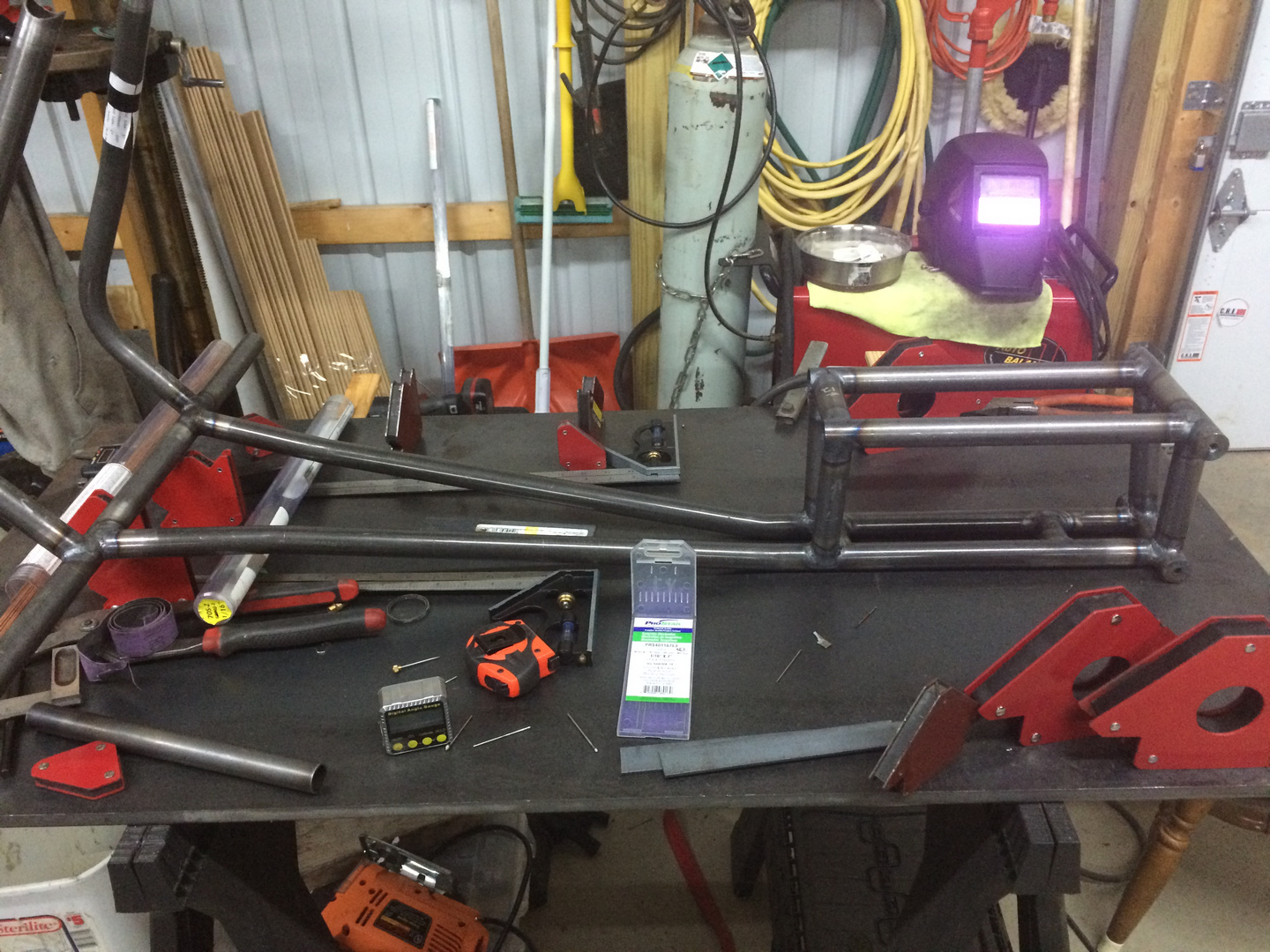

How are you doing your layout?  Are you using tube bending software?

Used jd2 to calc the bends.

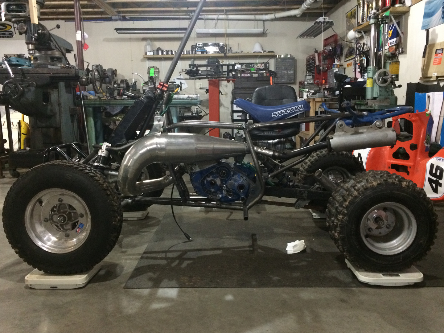

Looks great Carl, what pipe are you going to run on it?

Not sure on the Pipe, Have a Hall on loan to Ill see if its going to fit and clear the tire screws. I worked on rear suspension linkages yesterday so far TRX 250r or 450r are looking really promising, but the top of shock sits way high in the frame and Id like a straight shot from Filter to carb so Im waiting on a Raptor 660 linkage I just bought for 10 bucks on Ebay.
Should be some new pics this weekend hoping to have it finished up.
