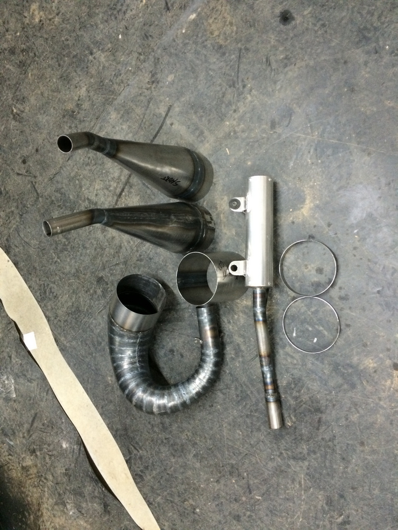

Actually Just got back to working on it. Changed a few things from the original plan. Ill get some updated Pictures. I had Dynoport build me a NEW test pipe and I picked up a few hp, I was waiting on a Linkage to try, going with a Cr 500 I had intended to use a No Link for Simplicity, but none of the Angle or mount points worked out. That's been the biggest holdup.

I had a sectional test Pipe built. theres about 10 possible ways to assemble the pipe not including sliding the Dwell anywhere in between min and Max.
This is the same engine I have I run for a Few years on the Ice with varying success. I was Fighting a Engine heat issue. this pipe cures that and makes more power with a lot bigger stinger ID. I can fit the reducer I have over the stinger on any of the other pipes I have tried. Very happy With the result. Now I can add some new porting and maybe a Bigger Carb to.
Hoping to have the chassis done in the next Couple weeks, we will see what happens.
