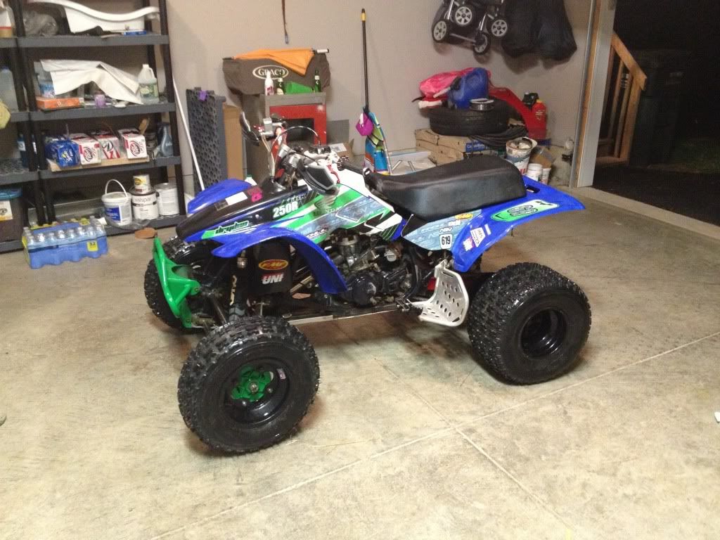

Ill play. Nothing spectacular but there off a raptor 660. Need to cut off some of the unused mounts.

Other than taking unused stuff off Did they bolt right up?

Not really. Had to grind some off the left side heel guard it was hitting the frame peg mount. Used some spacers on the left an bolted to the chain roller. On the right side I used some aluminum flat stock from the silencer mount to the heel guard. I also have pro armor maxxi mizzer Ltr foot peg extensions.
