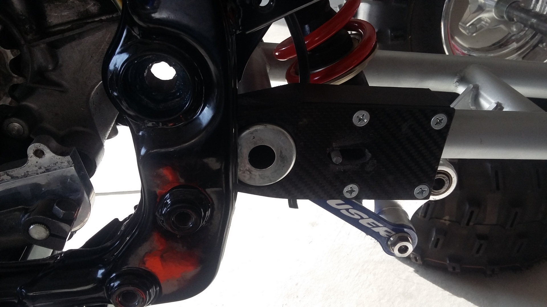

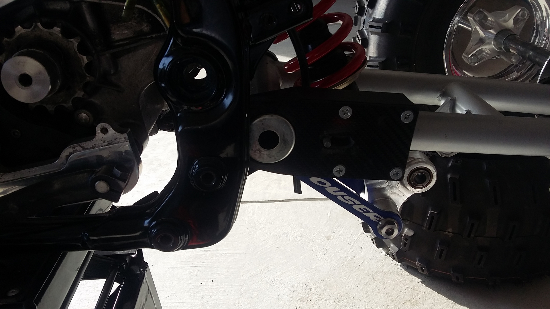

custom chain slider (prototype):

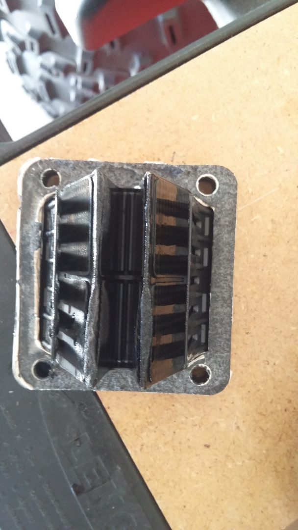

looks like a backfire caused this damage:
I believe this was caused from the use of a cheap $13 coil to troubleshoot wiring.  any other thoughts?

« Reply #81 on: November 29, 2016, 04:55:06 AM »
I made progress.  I think the smart carb is the problem.  I tried 5 different metering rods and got no real improvement.  I tried my 38 a/s off the 250r and it ran better despite the carb set up for a a bigger cylinder.  I got a 35 a/s on the way.
New Project: YFZ/Banshee Hybrid
« Reply #82 on: November 29, 2016, 09:59:01 AM »
Quote from: jcs003;70981
I'll bet money the Smart Carb was your back fire reed killer John, only way they may work is with two one to each cylinder. If you're running a 2 into 1 how is it a smaller cylinder set up then your R?
