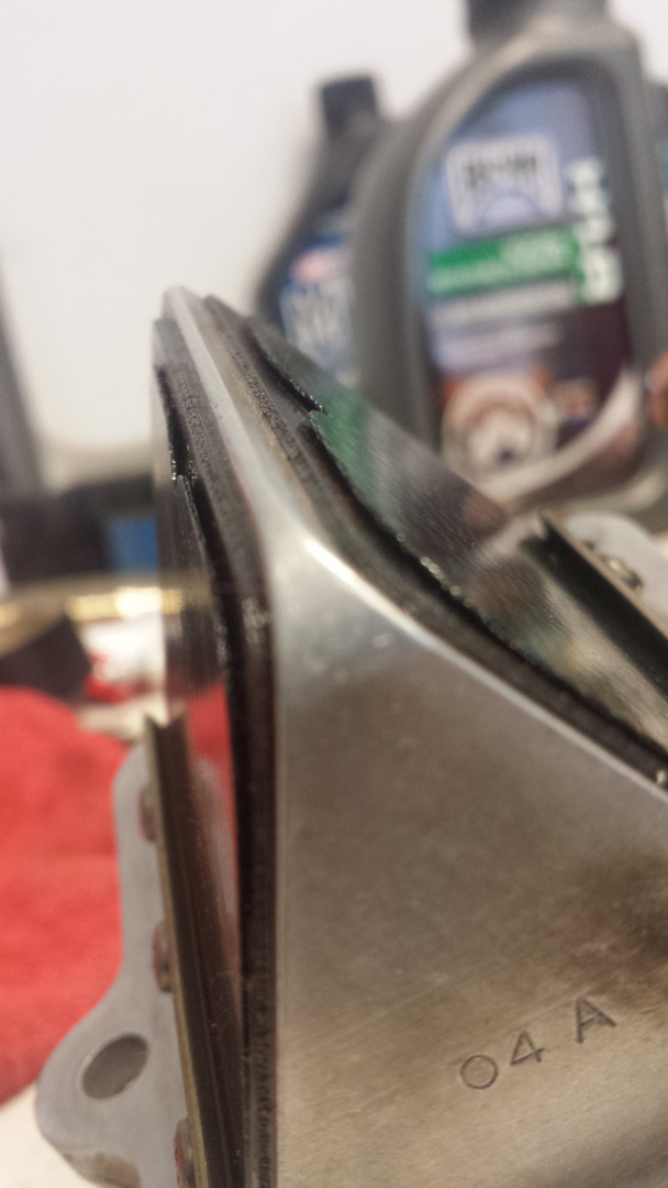

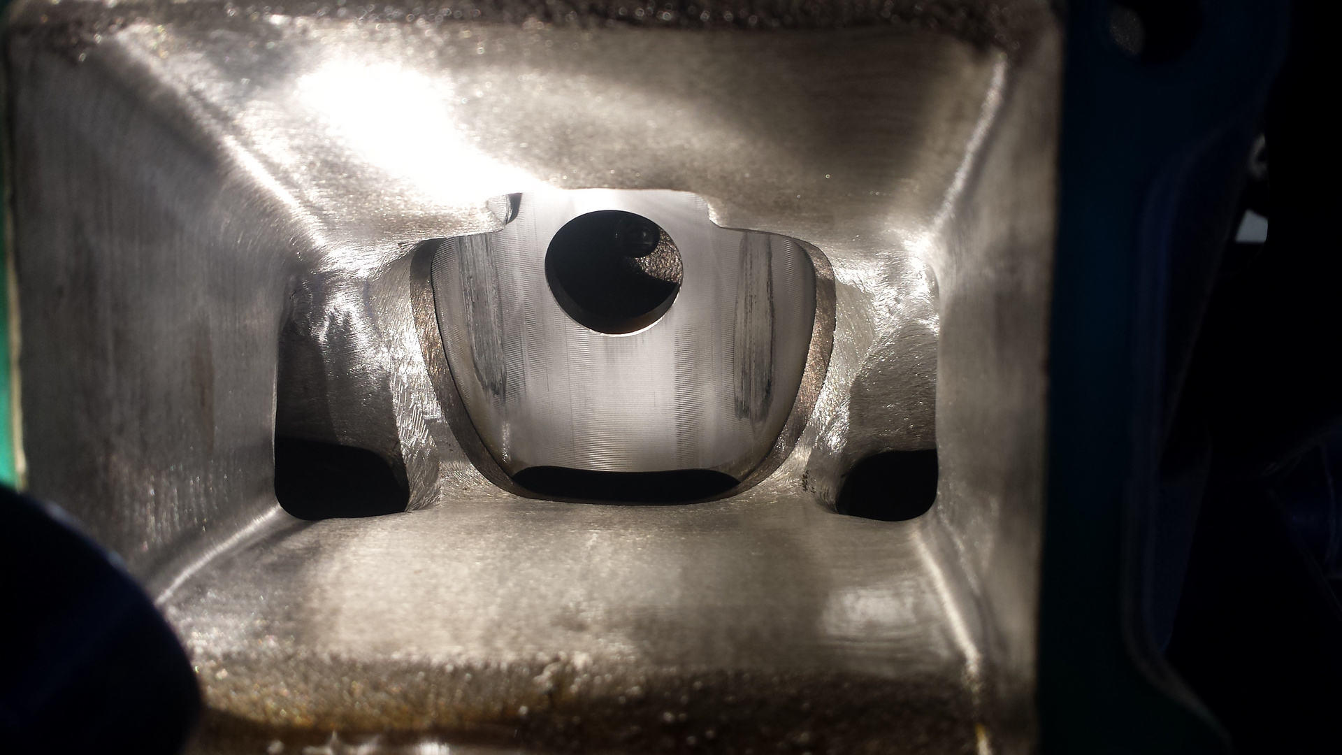

Heres a picture of the reeds. they are slightly bend up and I can fit a .015 feeler gauge under the tips. Can I flip the reeds over to make them seal or should I order new ones?
Also look at my piston. Looks like four corner wear, ive always warmed up the bike before riding. Do I need to replace this piston?

The reed petals may have some slight fatigue but is more likely they need the grit removed from the fulcrum point.  The reeds are just a one way air valve and petals like yours will completely close the instant the crankcase mixture tries to flow backward.    There is reversion in any intake tract and some wetness in the air box hose is normal.
The marks on your piston skirt is the result of an old "4 corner seizure".  It is not normal ware.  I see a lot of 4 corner seizures on the 310 big bores because the recommended piston clearance is too tight.
Carburetor theory says the needle jet is not suppose to flow fuel at closed throttle, but it will and can affect the pilot jet size and air screw setting especially on closed throttle deceleration.
If your pilot jet needs to be excessively small it may be the result of a worn needle jet or needle.  This diameter may be too small and just needs the straight portion of the needle to have a larger diameter.  Ware in these two areas is very common because the aftermarket Keihin carbs use bronze rubbing bronze and causes accelerated wear to the needle and needle jet.  The OEMs that use Keihin carbs use dissimilar metals for the needle and needle jet.  The OEMs use a bronze needle jet with a hard anodized aluminum needle and they last forever.
