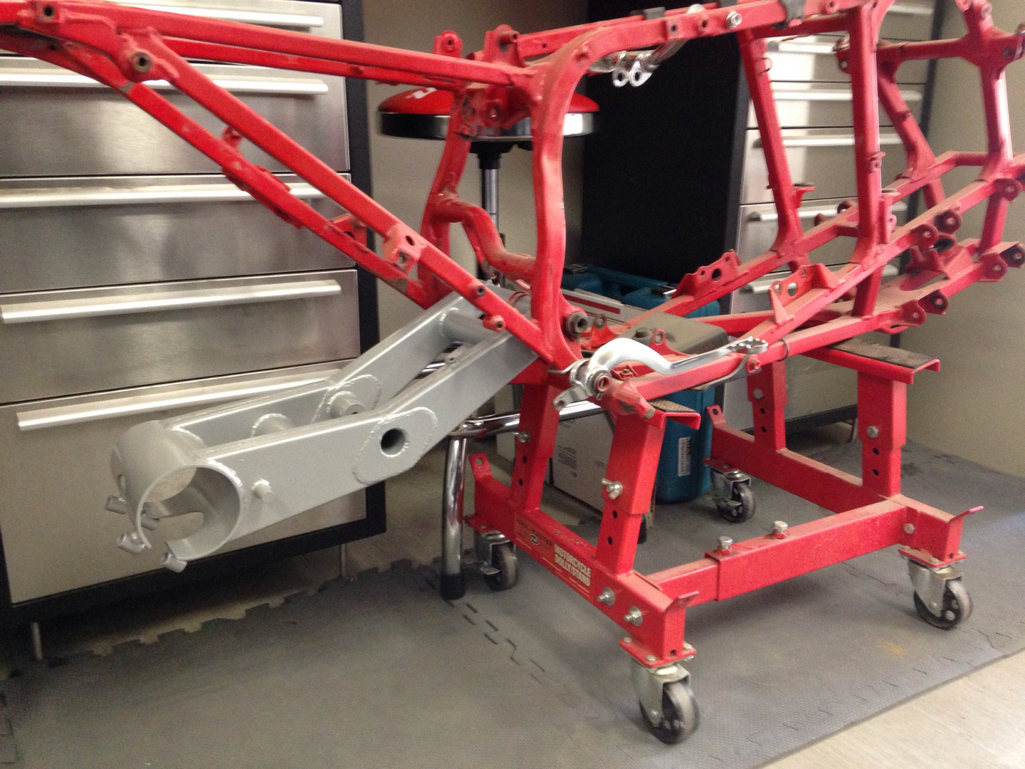

So i have been putting a lot of my effort into my XC bike this year. I have purchased a LT front end, went back to 250R spindles from 400ex. Raised compression on my XC motor, new plastics and graphics, new Tires, RPM XC Dominator axle, and 9" shamrock rears from my 8", new bumper. And coming soon an auto clutch i hope as well.
Here are some photos from the update thus far. Need to get my graphics on and do some testing. I have already been running my recently built XC 450R with a lot of success. I cant wait to get my 250R out there. I may even try to get out o the IXCR series in Indiana for the all 250R class some time.
Here is the bike last year. And its progression through the year. Also a shot of my 450R, it is getting a matching graphics package as well soon.

hence why im putting a full coverage graphics kit. The only other option was to buy new maier which was only $100 cheaper than these. So... price is a wash really.

Have u rode the Motowoz rear yet? I'm surprised u didn't want to switch to cr500 or no link rear. Happy with the stock link?

Still have a Axis rear and stock link. Cant find a no link swing arm, and Im not ready to drop the coin for another CR500 link frame. So im doing what i can with what i got.

Koq (kids on quads) makes a no link swingarm. It's reasonably priced. Not as nice as a Roll. I've had one about 3 years now. Hoping to finally buy the shock this year.

Ya i seen that. I may go that route. I have dumped enough money for now.
