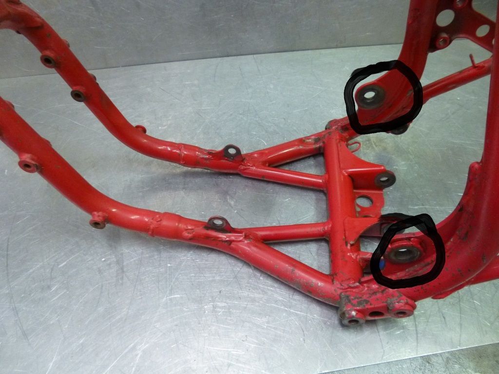

i just went and looked at mine, i have about a 1/4" between swinger and cases. without a doubt having the weld built up that far will make the weld touch it, but was the original cause of the swingarm bumping the cases to begin with extreme frame flexing, or worn out swingarm bushings? i kno this pic is an atc frame but the same idea applies, how much if any slop is in these holes i circled?
I took the dremel with a grinding wheel to the weld last night and put that "groove" back in it. I didn't make it as much as stock cuz I wasn't sure how to deep to go without messing it up and I finally got it to clear! I pulled my swing arm off when I welded the motor mounts and yes the main swing arm hole is perfect. Originally it did crack from bad bearings. I don't have quiet as much room as in your picture but it  Should be all good now. I will re assemble everything today and get this beast running by the beginning of the week
