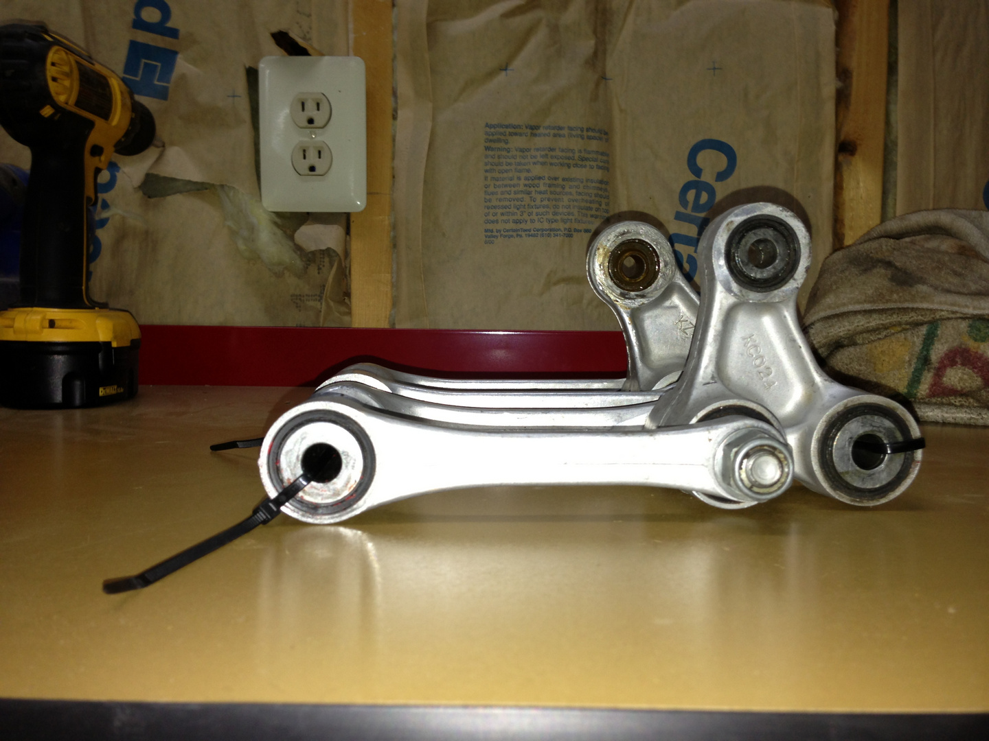

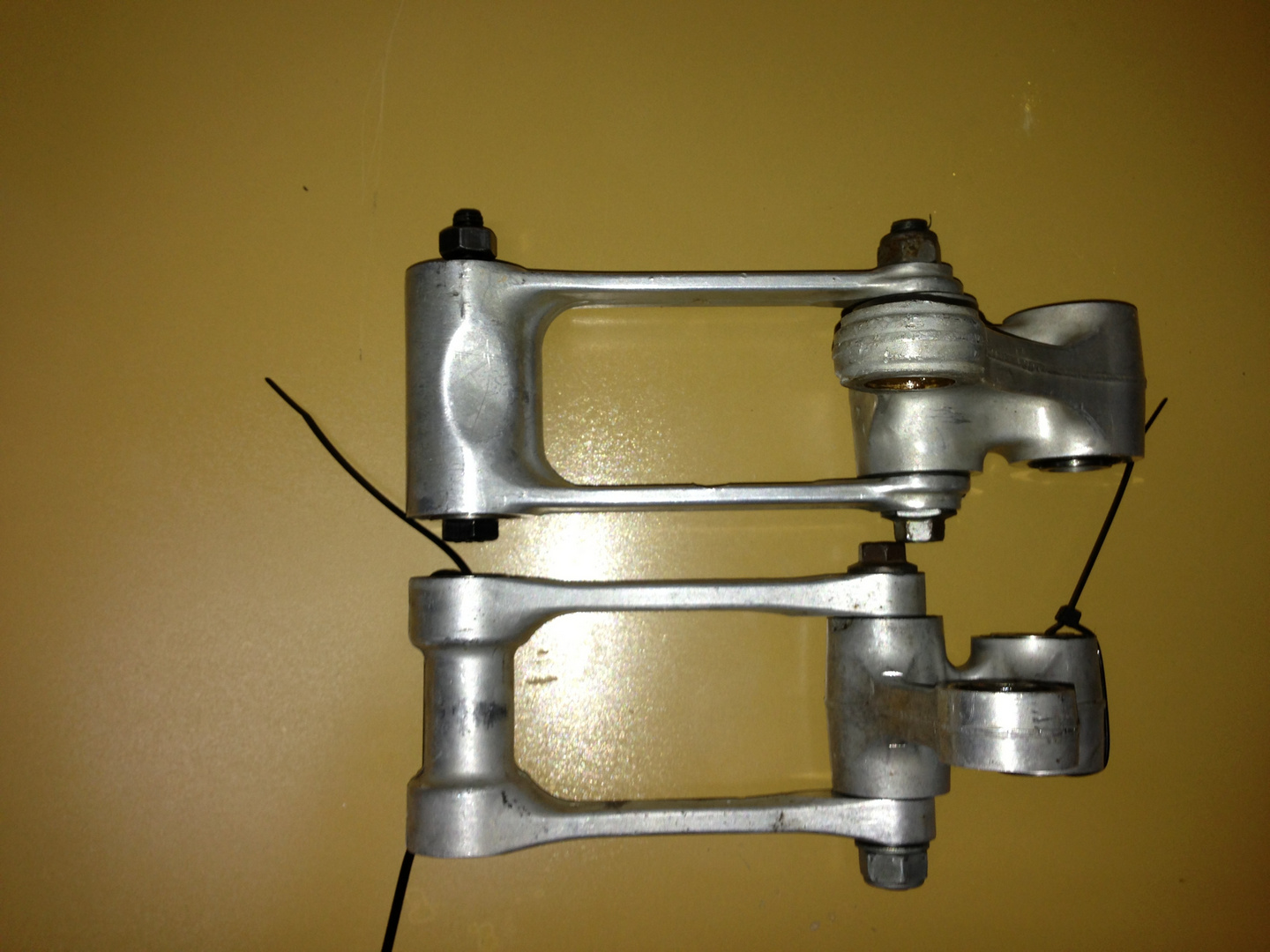

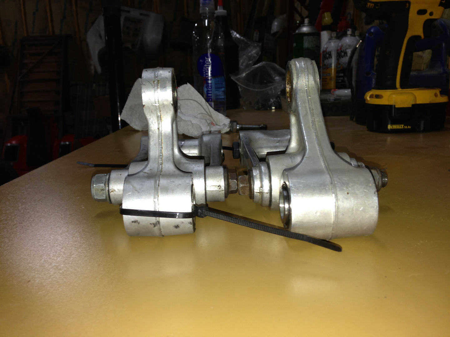

Offline 89Longrod
CR500 swingarm - who is building these in 2016?
« Reply #13 on: April 12, 2016, 11:58:34 AM »
This is a comparison photo of Cr500 vs Crf450 linkages I took a few years ago when I was building my quad. The one back one/right side is the cr500 linkage, I cant remember if the CRf fit sorry :/
02 Predator narrow frame cr500 link,Pro-trax,Fox.
