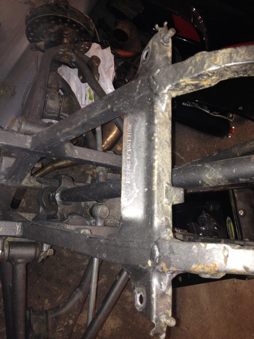

Searching by the VIN number, I saw that it was from 88... Also, the VIN is located where the 88/89 usually is, but I can be mistaken... Oh, and I know now that this quad has parts that didn't come with it (the swinger is being a pain in the bu.. to take out).

your pegs bolt on correct ? thats what it looks like in the pic , can you post better pics in this thread ? it would suck to buy the wrong frame being so far  away.

It's an 88 if you look it has the rear engine mount for the frame, it looks like someone put in an aftermarket 86/87 swingarm.

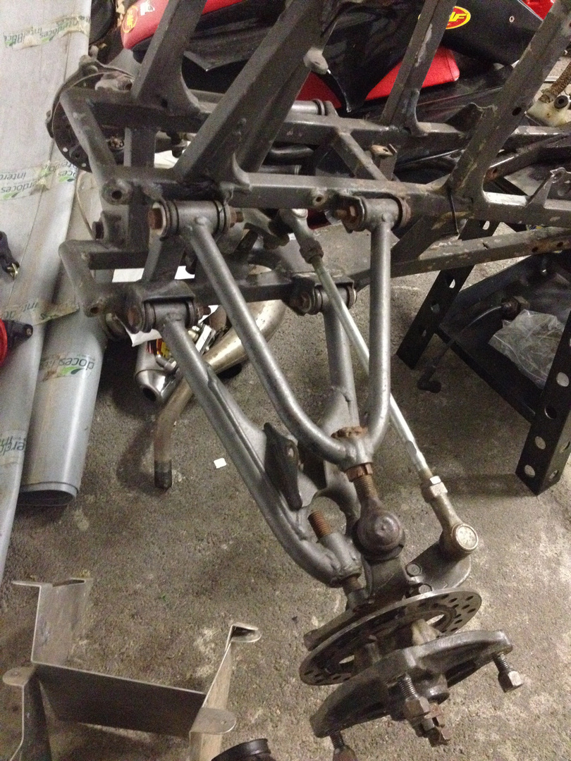

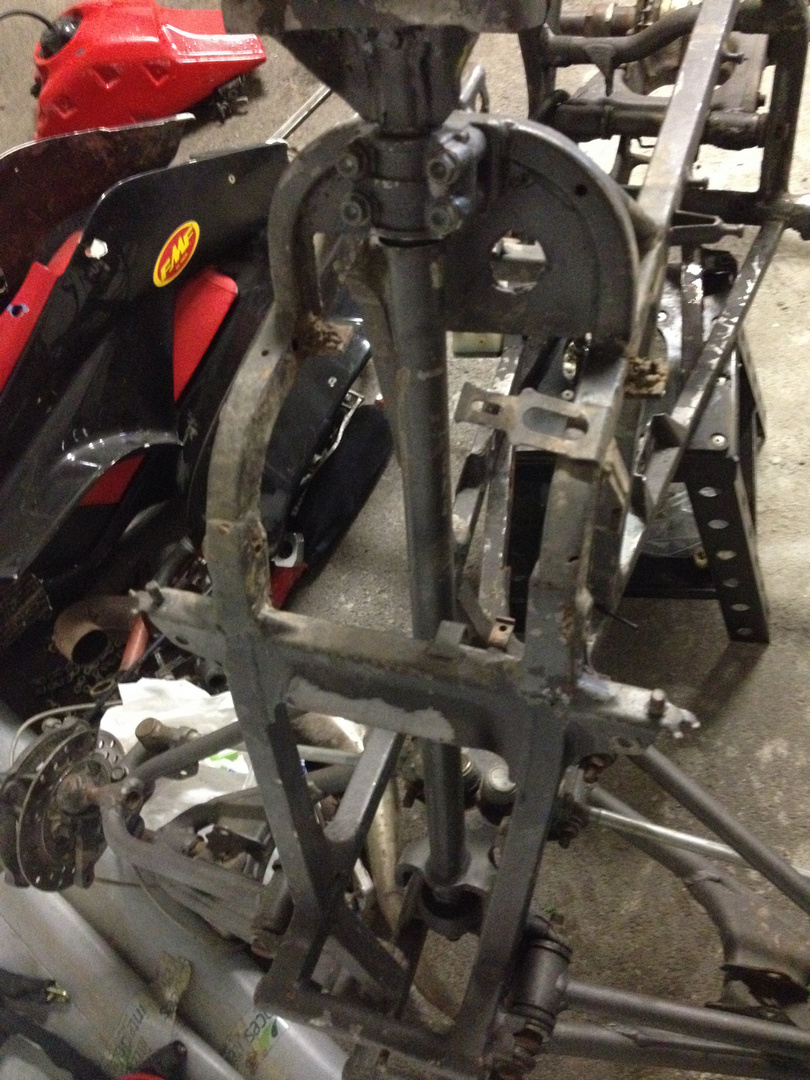

I took some pictures. Hope they help.

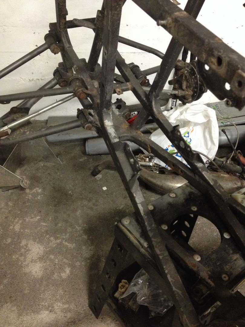

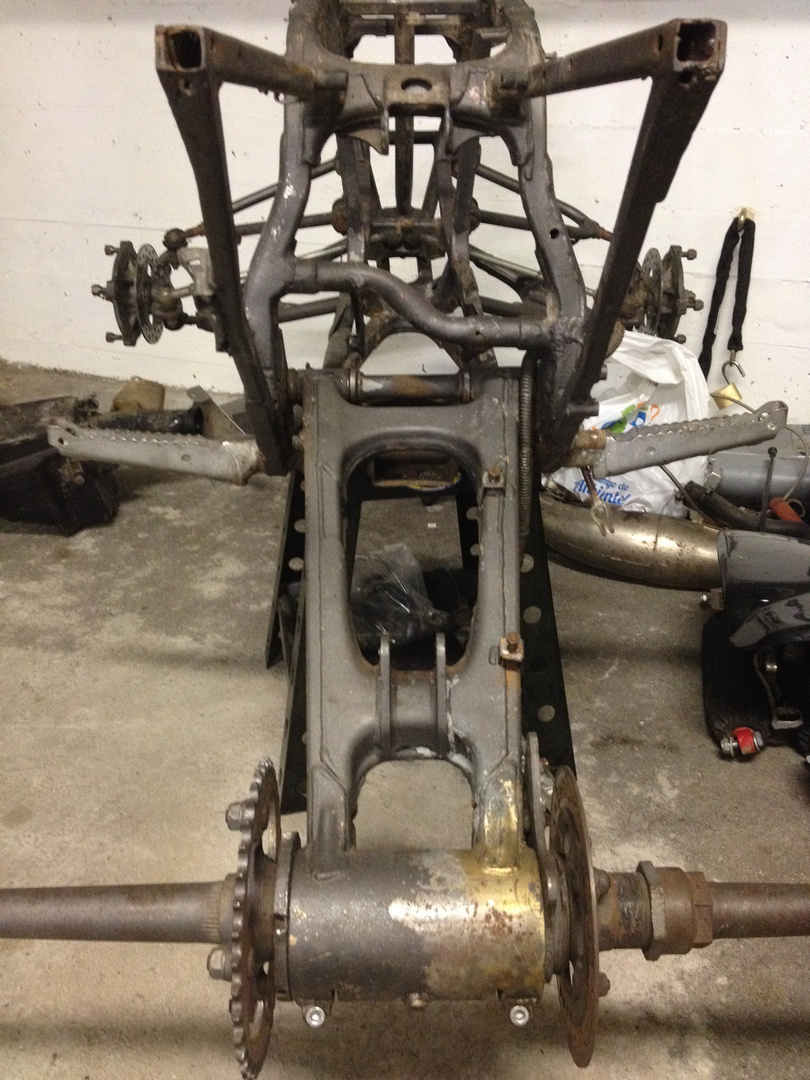

Here's a few more.

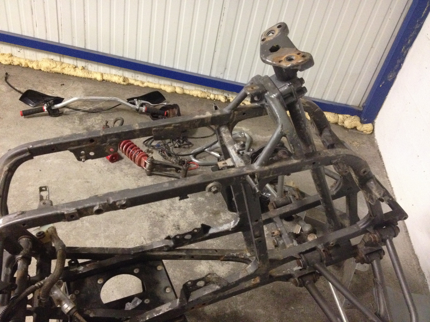

And, last ones.

I see why ya want a frame
1988/1989 OEM TRX 250R frame
« Reply #14 on: May 29, 2016, 12:49:47 AM »
A-arms, spindles, hubs & rotors look like OEM 86. Swinger is OEM 86-87. You can make a spacer or cut the top tabs off an 86-87 rear engine mount to fill the space between the bearing collars. Looks like the rear seat mount has been cut off the frame as well.
