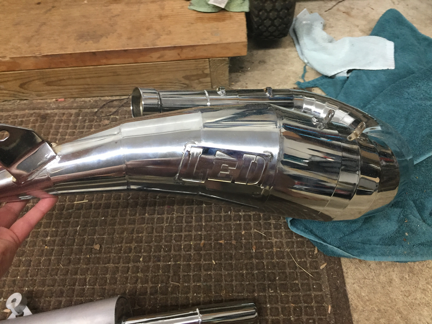

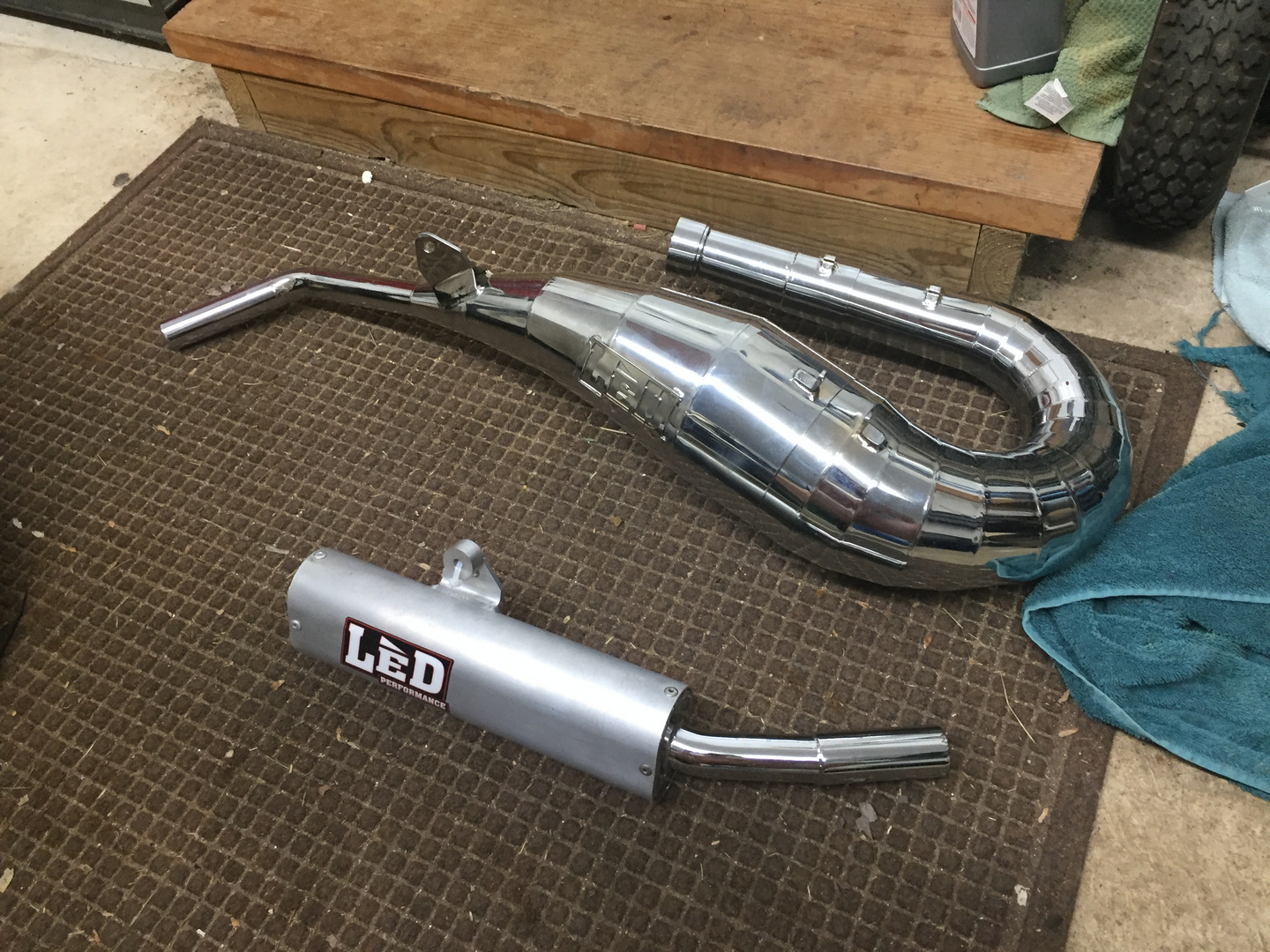

Quote from: zcarlson12;67989
Looks like a great start Ryan. Those cases are sweet! Pics of the pipe please!
Here ya go Zak.
Offline christph
Project "Phoenix Rise"
« Reply #20 on: June 03, 2016, 11:34:03 PM »
Damn, that is a bad-ass looking pipe.  Is that their 350G model?
