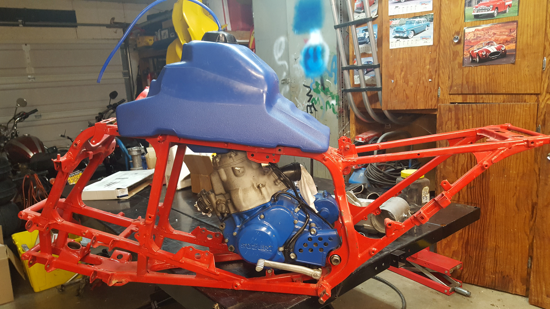

Have the Zilla apart and the motor in the frame. Working on the front mounts. Talked with Arlan on Thursday, it will be a hand built custom pipe. Dropping it off in a couple of weeks to get the pipe built. Meanwhile a lot of cleaning and painting of parts.
What all is done to that cylinder?
Offline rjt500r
TRX/Zilla build
« Reply #26 on: October 22, 2016, 11:04:37 AM »
Quote from: Skeans1;70310
Reinforced ears and reed cage, O-ring head, head shaved, Jerry Hall dune port, V-2 reeds

« Reply #28 on: October 22, 2016, 01:32:11 PM »
Is it just me but seems like going to have clearance problems with the oversized tank
Offline rjt500r
TRX/Zilla build
« Reply #29 on: October 22, 2016, 02:13:52 PM »
Quote from: hickwheeler;70313
Clearance issue, yes, problem ,no. I will have to heat and reform the tank in a small spot for the spark plug. Or I could run the KTM short plug, but I will most likely reshape the tank.
