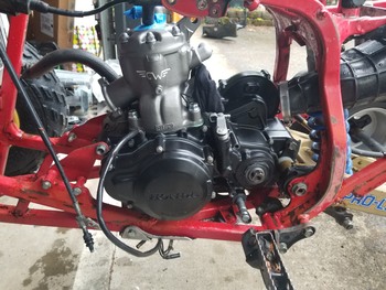

OEM paint on cases
PJ1 high temp rattle can on cylinder
Still has the rough casting texture.
I leave the boot rub marks on the stator cover to show I actually ride it.
Offline evaneyeball
Re: how to paint cylinder
« Reply #12 on: February 20, 2020, 10:29:18 PM »
i think you might be missing something to ride it starts with c and ends with hain.
