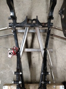

This particular area of the frame sure takes a beating. It is the lowest part of the frame so it takes licks from whatever we plow over. Also being that it is the lowest moisture settles here and slowly rots the metal from the inside out. The lower motor mounts are also welded to these rails so any vibration your motor has gets transferred here. Lastly the OEM metal is thin! Check the pics

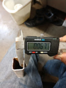

Cut out what needed to go. The stock frame rails are metric and actually rectangular not square. I don't recall the exact size off the top of my head. The closest i can get to the OEM size is 3/4" square. It is close enough that i would confidently say most people would never know a repair was made. I chose to use 1/8" wall. I didn't clean off the burrs in these pictures but you can clearly see the wall thickness difference.

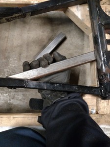

New metal. Checking for fit.
My tables are not exactly flat so I put scrap down and clamp everything to the frame to keep it square. Something i found interesting was that the two lower frame rails are not symmetrical! I found this out by comparing the lengths I cut out. They were not the same length. Looking at the frame i also noticed the old welding marks differ from left to right. I made my new frame rails symmetrical. The motor does not sit dead center in the frame. It is actually offset. I never really gave it much thought before. Front motor mounts have bends in the something like this //. It all makes sense if you look closely. Motor is off set so everything else follows suit.
I use a set of dummy cases as a jig so everything lines up correctly. Head mount, swing arm, 86 rear mount since this is a 86 frame, new lower motor mounts, front motor mounts, i even use a head gasket and head torqued down. While all of this is installed I, tack everything in place and check fit once again.
All tacked up.
And that's a wrap folks.

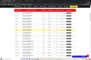

quick search i found this. 2' section is $7.38. I would like a little thicker wall but this would work.
