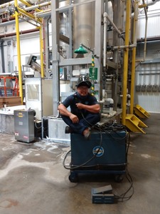

Since im posting pics of my mug his one more along with another old machine i use at work. Miller DialArc HF. I use it mainly for Tig. This machine sat for many years uncovered in a warehouse till i came along and asked if I could try it out. Its a total BEAST!
