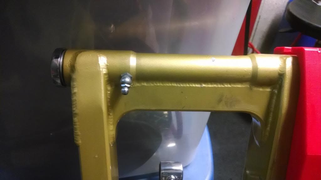

I got lucky! I took my swingarm off to check it out and look what I found! I still needed to save my chain slider for clearance, and replace all my linkage bushings, but I think this saved me from having to do the mod?
 Thanks higgy
