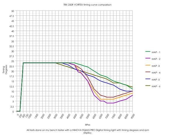

Here is a 250R VORTEX these have 10 maps built in them, unfortantly during the short time I had this my bench tester burned up a circuit board and I did not get all 10 maps
