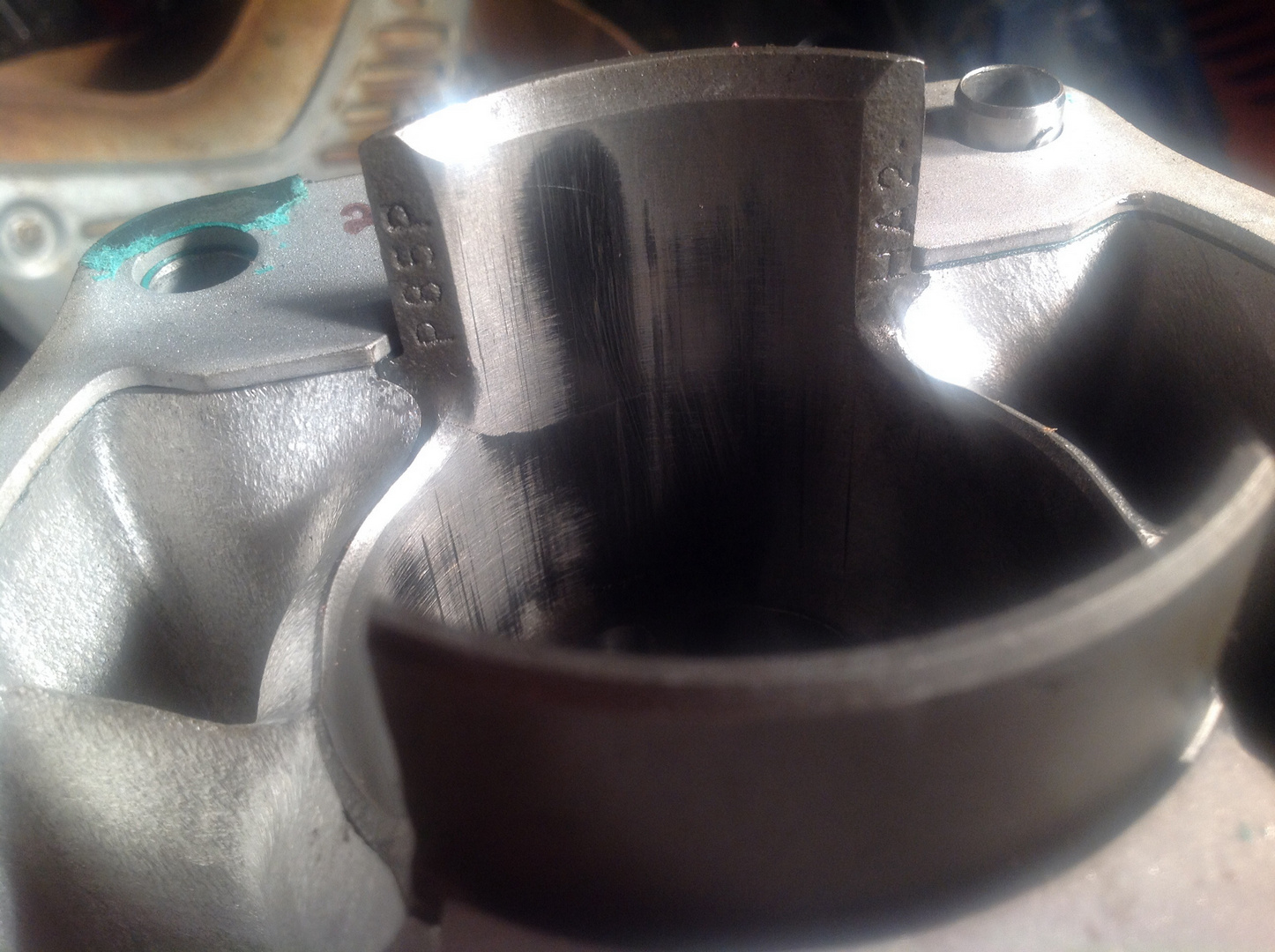

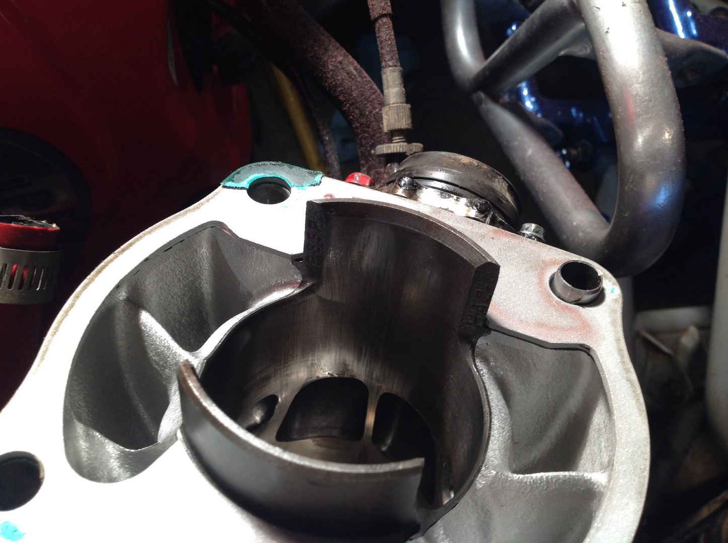

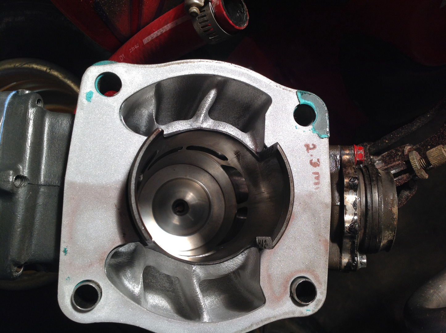

Where should I send cylinder to be resleeved I popped the top end off a motor I bought and noticed it had a crack. Or should I get send it and get it nikasiled. Would like to know who ported or built the motor the person I bought it from said a known builder In South Carolina. Has a really small spacer plate and nice looking porting would like to get it redone by the same builder.

Quote from: Daniel370r;29123
Where is the crack?  Plating will not fix a crack in aluminum or iron sleeve.

« Reply #5 on: March 17, 2014, 03:52:25 PM »
It's cracked, I miced the piston and it's measured more than 68 so probaly bored to 68.5. The sleeve says 85 and the rod says ha2 6. Has a small spacer and normal head gasket and some kinda thin gasket.

« Reply #7 on: March 17, 2014, 05:02:29 PM »
Sounding like its toast going to have to get another cylinder ported.
