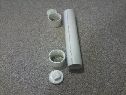

good stuff here fellas!!  I use to carry a back pack full of stuff (as mentioned in this thread) but as I'm getting older I feel too cramped to use one anymore.  what I do for items I need to take is I make up a "emergency kit/tool holder" out of  4" pvc tubing, caps and plugs.  I mount it behind the front bumper. I mount them with a split clamp bolted to the bumper  that I machined (like a 2 piece brake line clamp but obviously bigger).  I will post up a mounted picture when I can get to the bikes.  this is one I am making right now.........

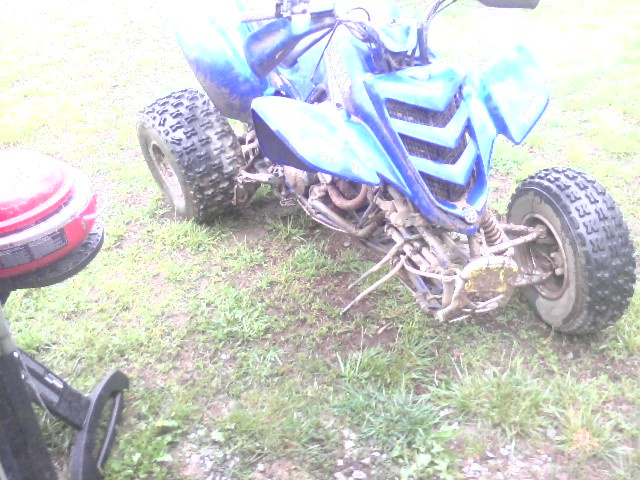

bring a cell phone and hope it works.  I've ridden trails in both Ohio and West Virginia and needed to use the phone in an emergency.  this is from a few years back on one of my riding trips to West Virginia...4th gear pinned into a tree resulted in a ambulance ride for my bud.  one extinct raptor............insured but it was a total loss :

Croat1, I always have a cell on me.  Well, I guess not with the riding jersey and pants.  Guess it's more of a reason to make one.  That PVC idea is pretty cool.  I've always liked organization though.  I like the elastic straps to hold things in.  I think it's time to pull out the toughbox full of misc military bags and accessories!

That's a great idea Joe.....i'm making one of those for sure

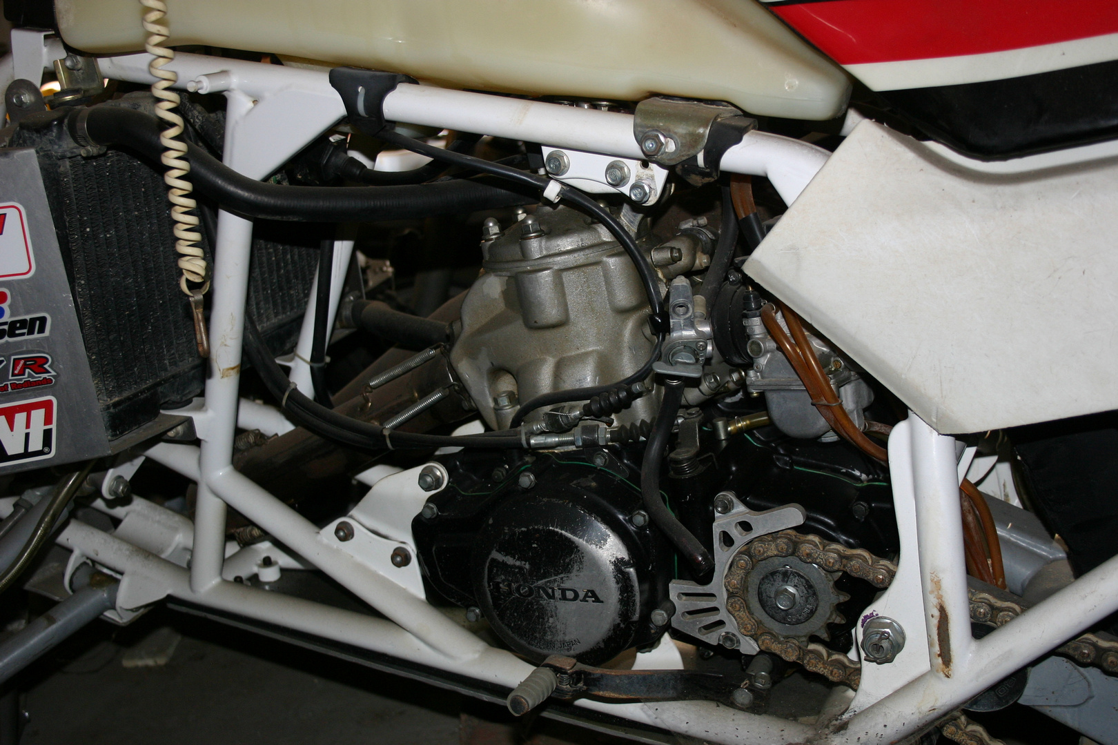

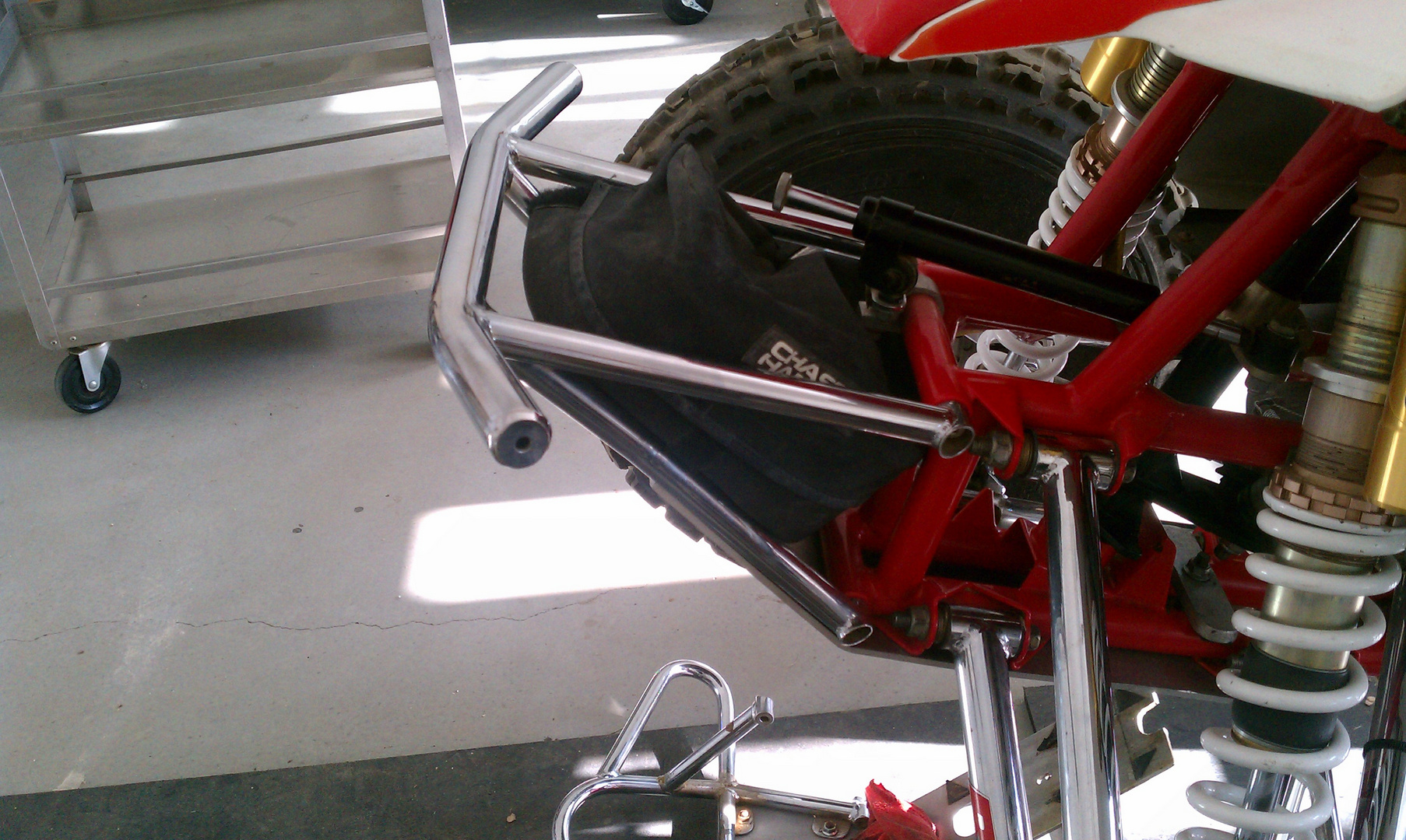

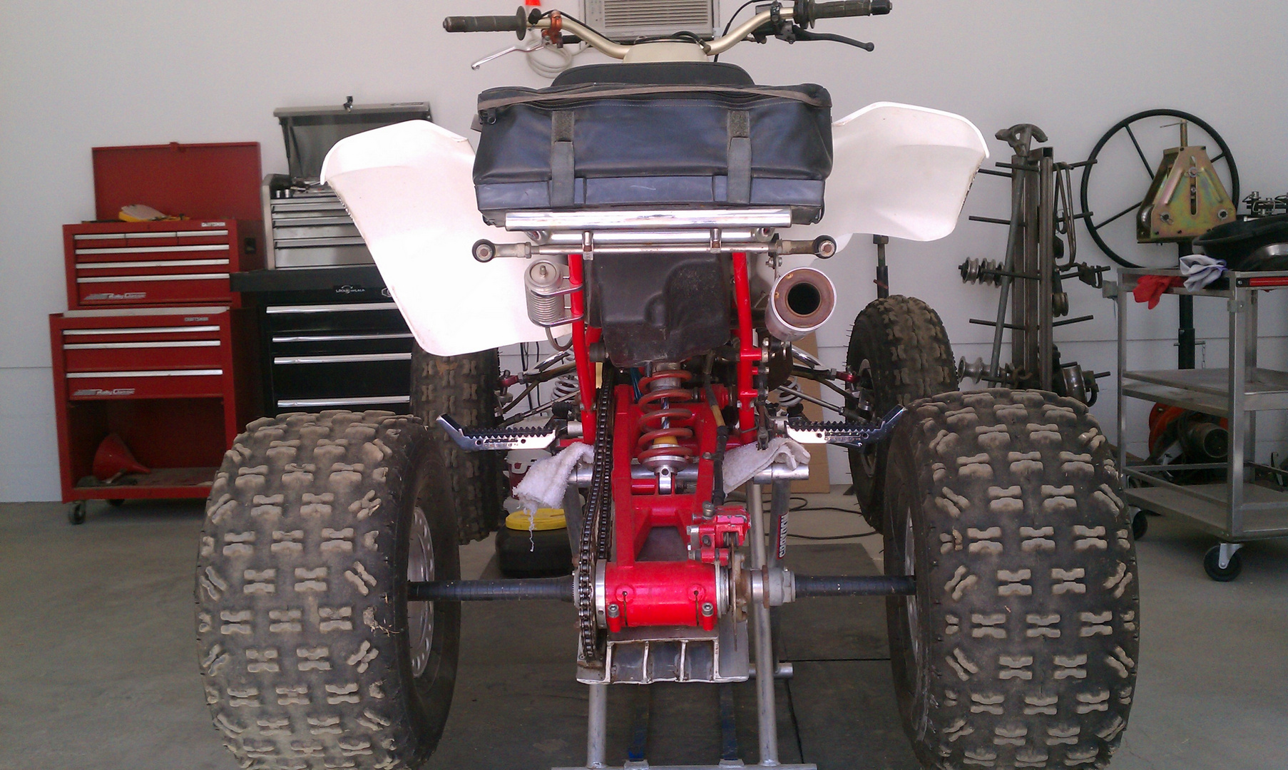

I don't like carrying too much weight on my body, except my belly, so I use a patrol pack. They stopped making these a long time ago(plus they weren't very strong) so I took one to a guy and he made a pattern and copied it out of some heavy duty stuff. For long events I made a bumper that can hold a motorcycle fender bag for the front. A bent tie rod can ruin your day so I hose clamped one to the grab bar

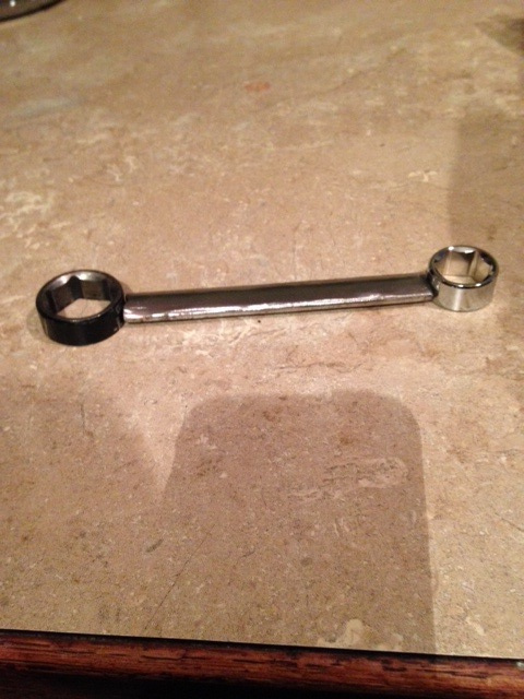

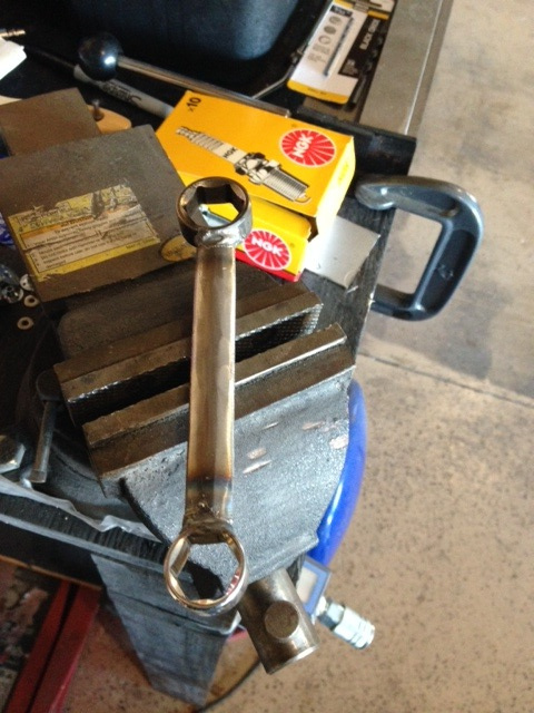

Well, I went to ****'s yesterday and picked up a sweet fanny pack A.K.A. "fag-bag" for $16.  It's going to hold a reasonable amount of stuff in a small space.  While at home depot today I stumbled across a clearance area and got some Husky brand allen wrenches (metric and SAE) for $2 a set!

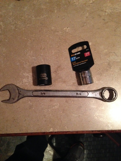

I'll have to post pics of my bag setup and what it contains but here is what I did today among many other things...
Here's what I started with.  A crap wrench, a 17mm socket and a 13/16 socket.
Here's after I cut down the wrench and smoothed it out and cut down the sockets to be used on either end.  Also provided space for the spark plug to slide through.
Here it is welded up.
I have used it.  I actually used it today while doing plug chops!  Works flawlessly.
