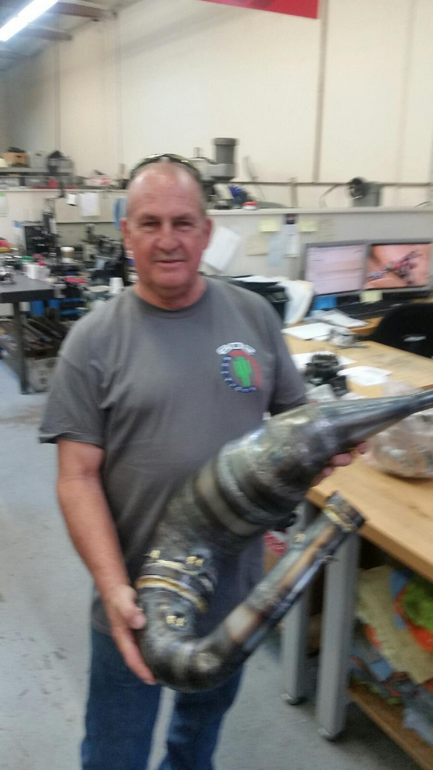

well I ended up with the pipe... since I am playing with bigger toyz I needed a bigger pipe.even got to help finish it up.... ..
Thats a nice pipe Kasey, hope it works well for you. Rob seems to be the biggest azz kisser alive! Thatz the most BS I have ever heard. Any Pipe Kenny builds will eventually be boughten.
