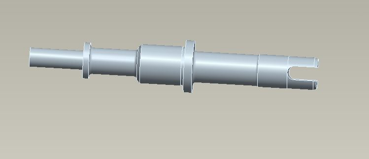

I got the shaft modeled up this morning. Am working on making the drawings. Going out for quotes pretty soon. I'm gonna get these made in 304 SS. I'm gonna start another thread to see if other are interested in the shafts or the impellers to see how many to get quotes for.
