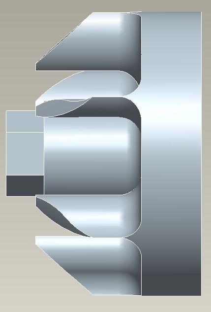

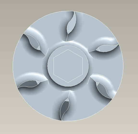

A couple pics of my first idea.

This one was modeled similar to the fins on Boyesen's super cooler kit.

Thanks for the pic, Jesse.I considered trying something like that as well. Yeah, I believe as you straighten out the fins, you are pushing more volume towards the out port. That pic helps a lot with ideas though. I may consider something like that as well.
