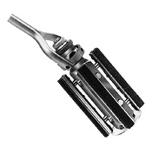

I was wanting to hone a couple cylinder's so I got a shoe hone from napa. I'm doing a 250r cylinder & 200cc 4-stroke cylinder. I know there needs to be about a 30deg cross hatch but my question is would a ball hone be better to finish off with & how would that work in the 2-stroke cylinder without breaking the hone balls on the ports?

no but I have the Lisle hone like this that I have used in my milling machine, I am not the most confident using it so I dont use it for anyone but myself. I am just a amature machinest at best :)
