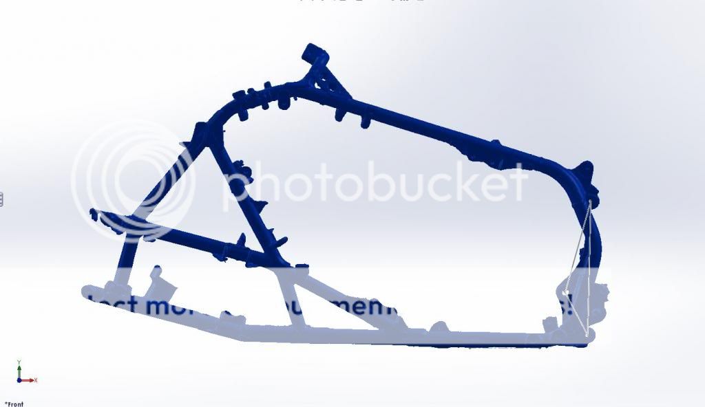

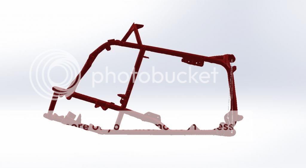

Andy I have solidworks and can do all of that.  I also have an industrial 3D scanner and I've scanned in Laeger frames, 250r frames, 450r frames, swingarms, etc... I can provide that leverage ratio and % rise in rate if someone is interested, I just haven't put too much time into as I didn't know if was warranted...

Here is just a start of what I've done.
04-05 450R Frame Scan
Laeger 250R Frame CR500 linkage

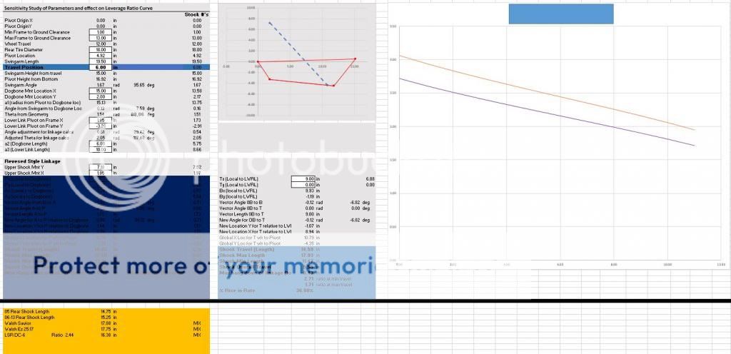

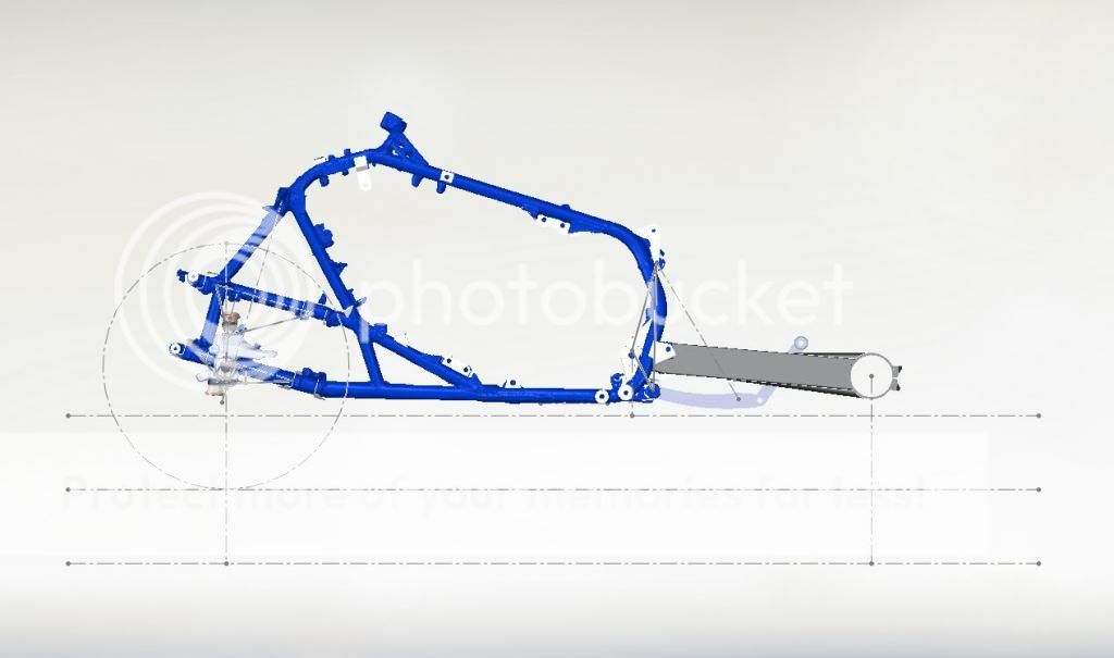

How  I layout the suspension geometry, (as an example): The 3 lines  represent ride height (middle) max up travel and max down travel.   Up  travel set with 1" frame clearance, max down with 13" frame clearance  total 12" of travel
How I calculate suspension Leverage Ratio and % Rise in Rate, I have this for all styles of linkages.

I tried zooming in on that last page but it's too blurry to read.  Very interested
