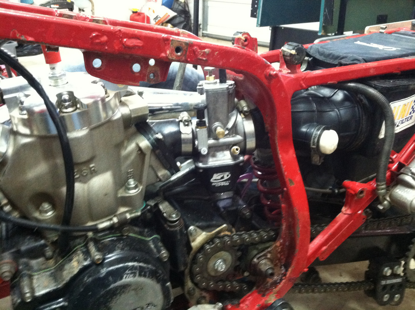

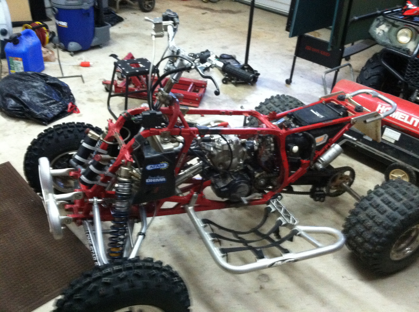

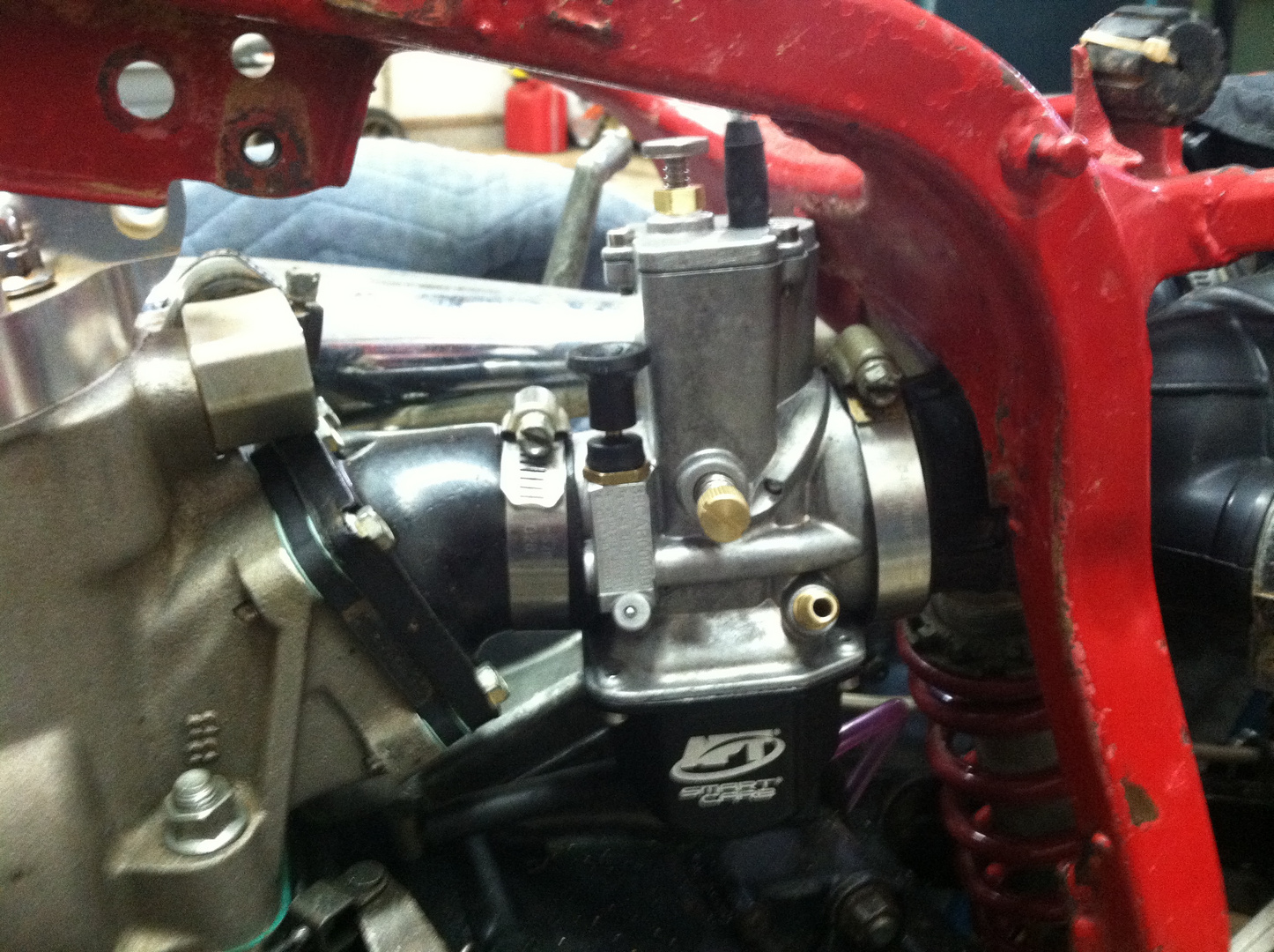

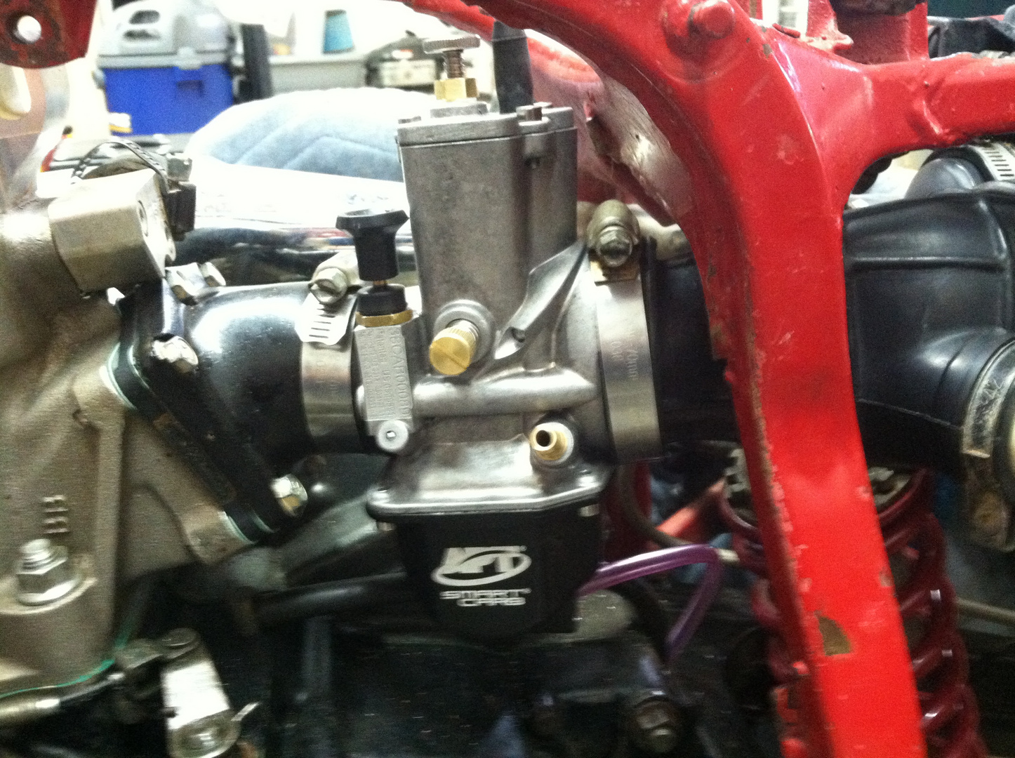

I only got a sec to open this thread with, but there will be much more info to come soon! For now, here are some pics of it installed on my R. By the way, Here is the specs of the quad that the smart carb went on:
ESR 310cc power valve
Vforce 3 with new reeds
B8es plug
CR250 ignition
14:1 CR, 110 race fuel
Sparks MX exhaust
« Last Edit: February 17, 2014, 11:51:11 AM by rablack21 »
Cast Smart Carb has arrived!
« Reply #1 on: February 16, 2014, 11:31:59 AM »

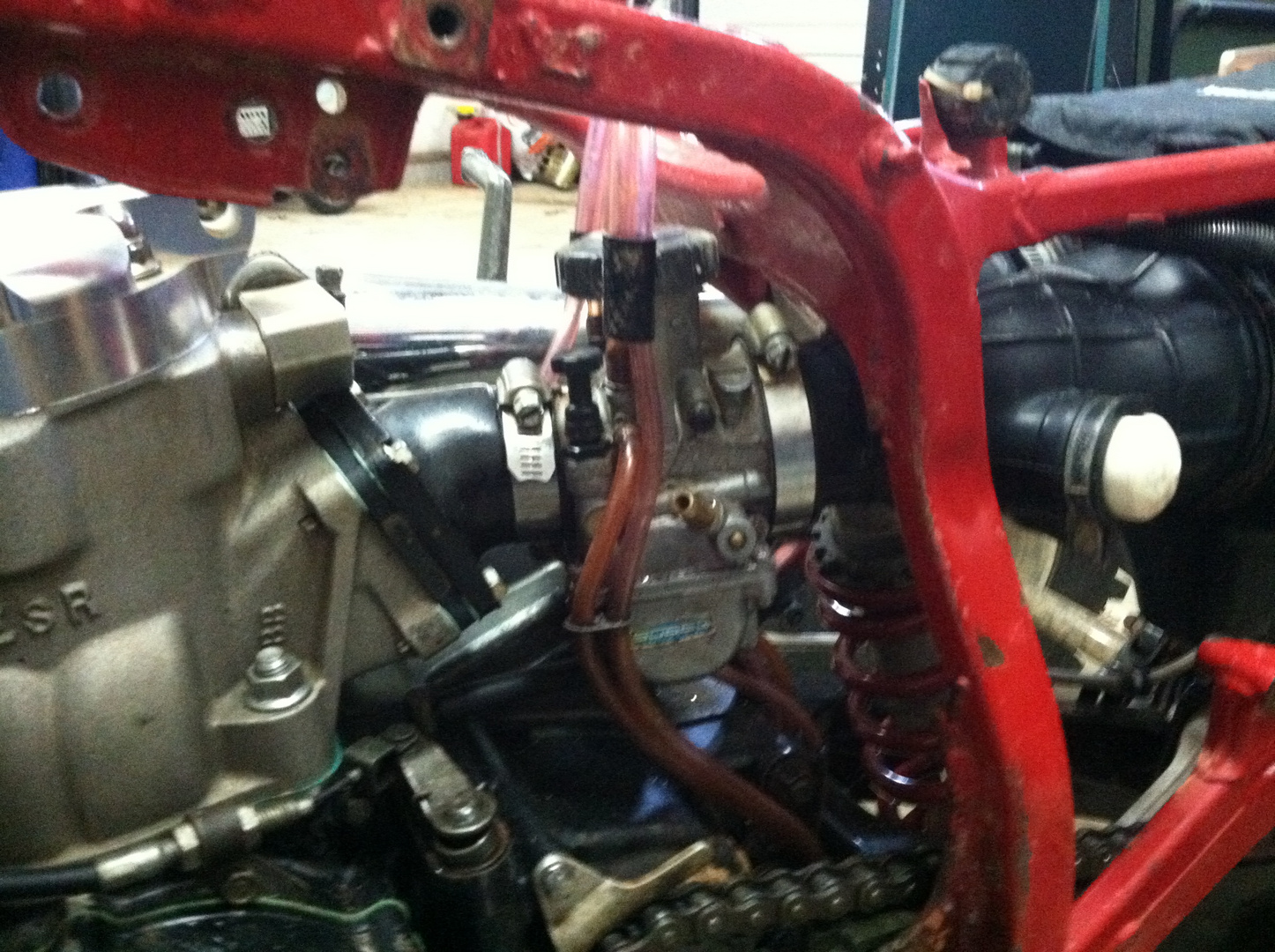

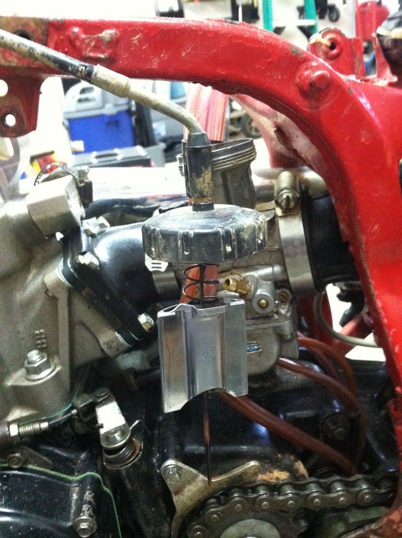

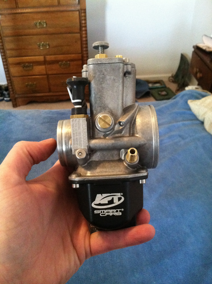

There are also some pics thrown in there of my Keihin 38mm A/S that I replaced.

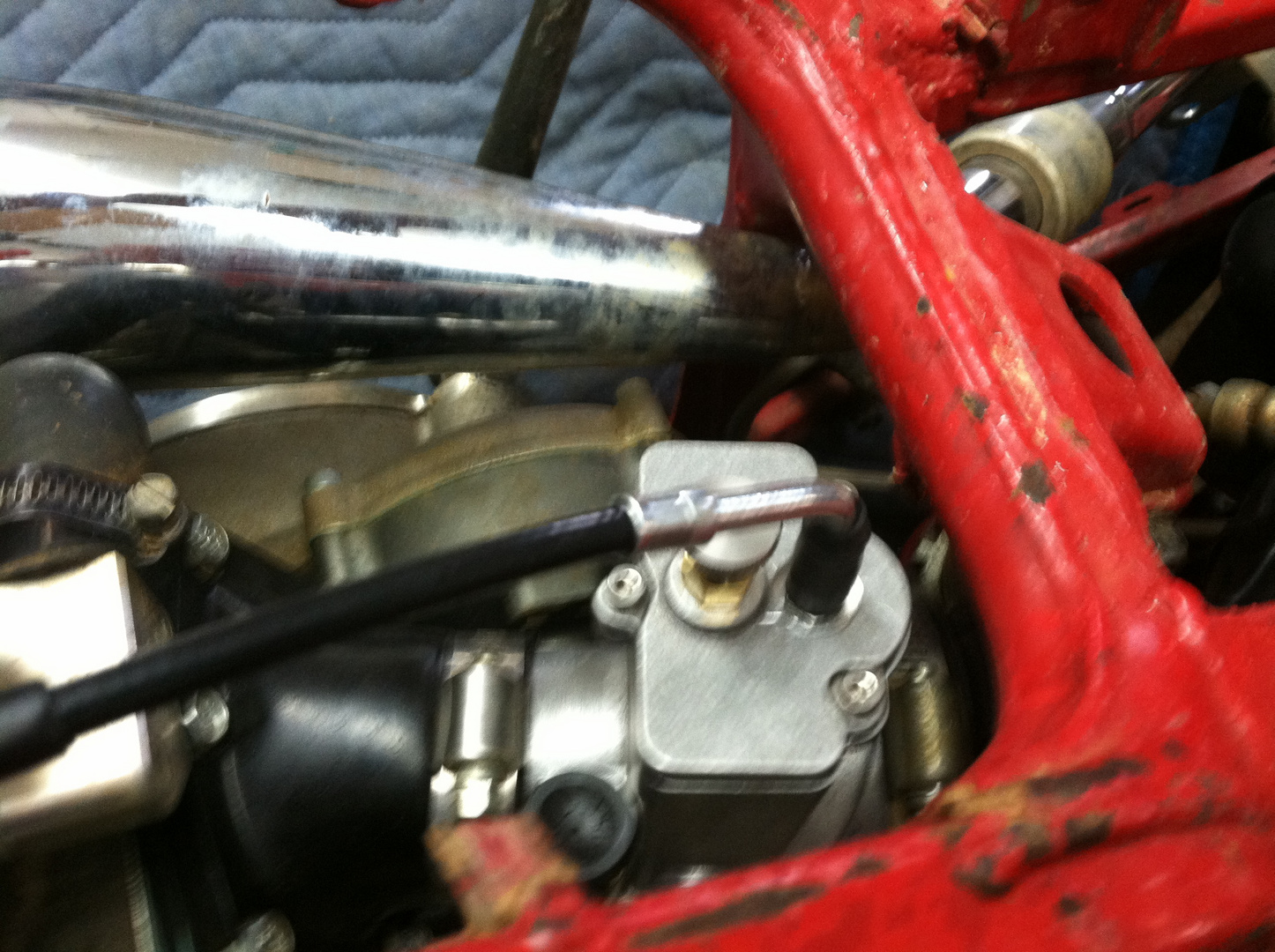

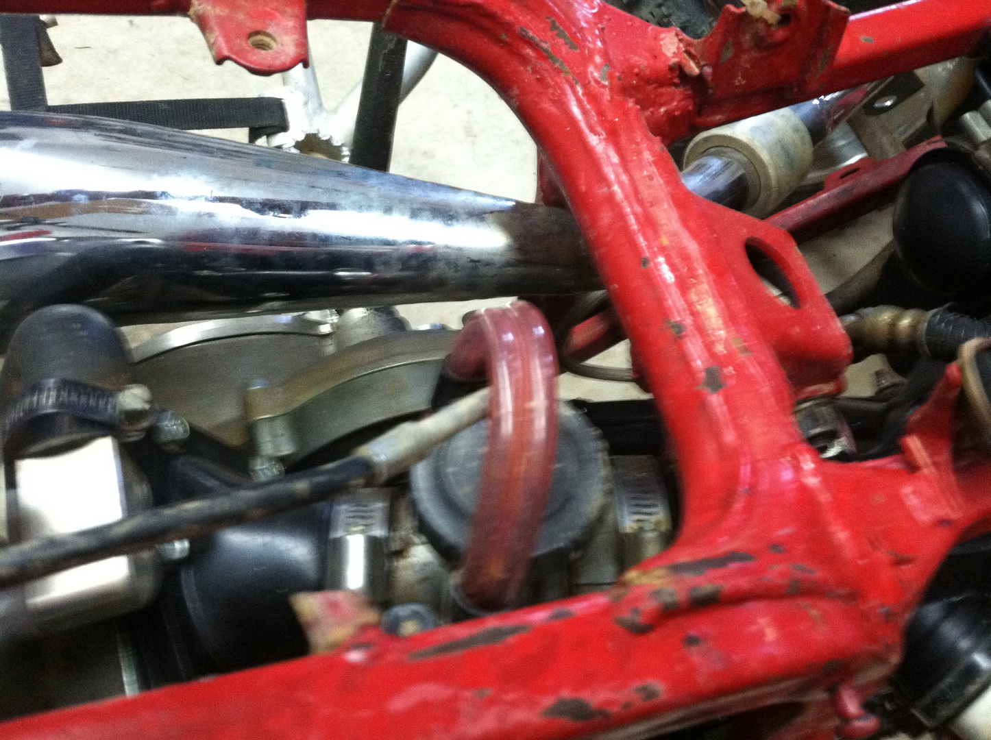

Installation was very easy with just a couple minor issues. The carb inlet-outlet length was exactly the same as my Keihin 38mm A/S so the fitment was just the same. It fit very well in the reed cage and air filter boots. The issue I ran into was that my throttle cable was not long enough. I got this cable about 10 years ago and for some reason it didn't have enough adjustment to let the slide drop all the way down in the carb. But I had bought a new replacement cable to keep on hand, so I tried it on the carb and it worked just. If you look in my posted pics, take notice of the cable that has the extra cable adjustments right there about 10 inches away from the thumb throttle. This was the new replacement cable that I had on hand. This is the one that everyone recommends to buy when you need a new cable. I don't know why my old cable didn't work other than maybe it was made specifically for my Keihin carb. Anyway, with the new cable mounted, the carb slide was good to go.
*Point of note about fitment and adjustment.

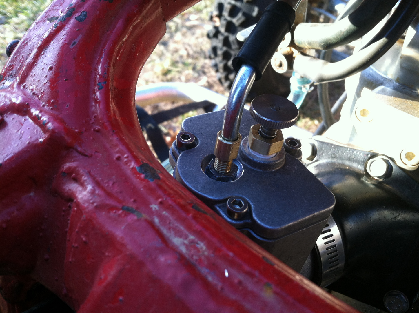

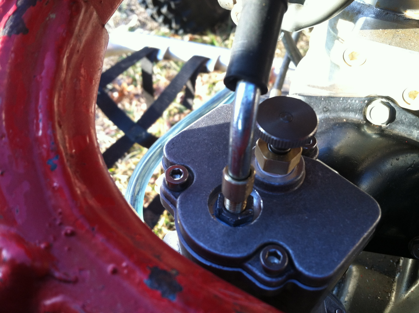

The adjuster screw for cable length that screws to the top of the carb and has a jam nut that is recessed in the carb body. See pics. The directions say to tighten this jam nut using snap ring pliers. This method does not work very well, and I found this nut very difficult to get tight enough to keep it from vibrating loose. I think that a full size nut needs to be used in place of the jam nut, so the depth of the nut will sit high enough out of the carb recess to get a hold of it with a wrench. For the time being, I tighten mine by tapping the nut with a chisel on the corner of the nut and using a tad bit of loctite.
With that said, this completes all the issues/inconviences that I ran into with this carb. The cable thing may just be a fluke or have nothing to do with APT at all. The jam nut adjustment issue, I feel could have been done a better way. But, at least it is a minor issue.

I agree that you should just put a taller nut on it or even make one if needed since you do not need to make a adjustment there, but then you could just red locktite it, that way it does not need to mechanically tight but yet the nut will not move.

You do actually need to make an initial adjustment there, but once it is made, then, yes, it could be loctited down, which is what I did. It did take some adjusting to get the thumb throttle to open the whole throat of the carb. I am running a 400 ex thumb throttle and it just barely has enough travel. And yes, the cavity of the thumb throttle has been ground down as much as possible. I may switch to another thumb throttle I have liked mine for a while.
