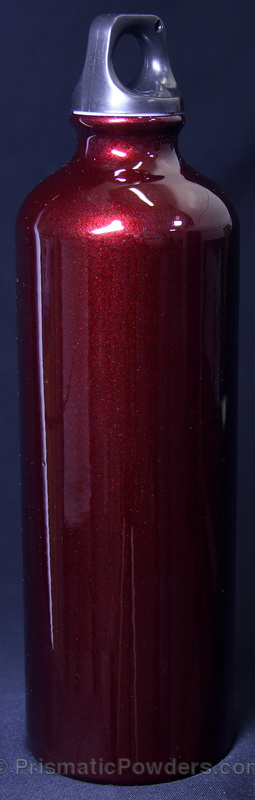

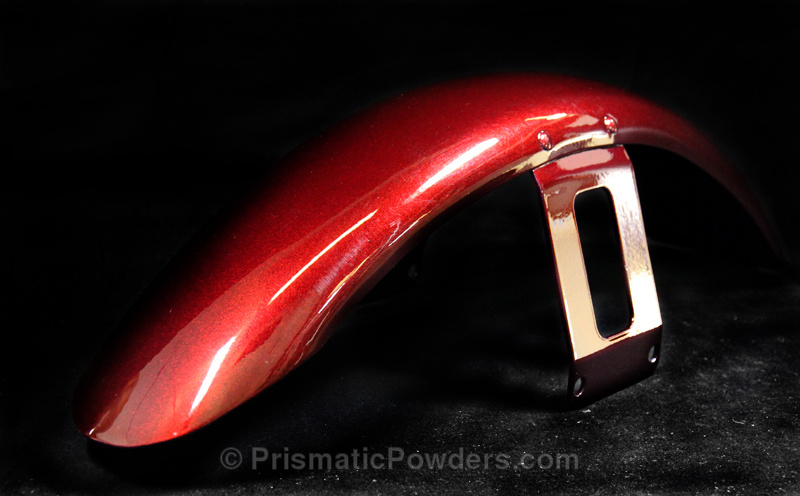

The color there is the lollipop and cosmic blue.
You can do flake, vein, textured, glow in the dark and other creative works.  The metallic look all depends on the powder.  More of a sparkle is in the starlight powders (don't quote me on that) I believe.  Not my cup of tea.  Powderillusions could probably answer better.
For the best answers to color options you could go to these sites for mind-blowing options..... http://www.prismaticpowders.com  and   http://www.powderbuythepound.com
It's insane on what is available.  Hell, chameleon is also available.
Edit:  There are metallics.  The bottle and fender are the same color.  Just different lighting.

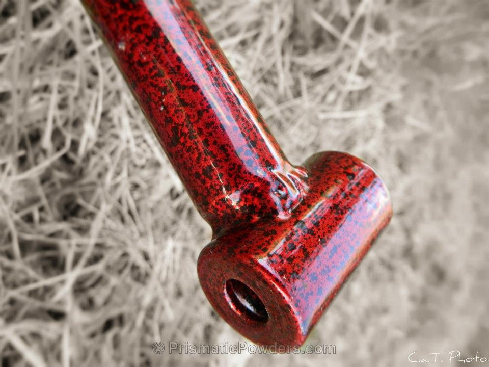

you can get all kinds of frisky with powders--prismatic seems to really like multi-coat powders so you have to make sure what your getting and there is a ton you can do with them but every coat adds thickness cost and sometimes headaches --
here is lollipop red over a silver vein I did on a bike frame

The lollipop red over the heavy silver base is sweet! Pretty much all you do is coat it 2 times correct?
Offline Powderillusions
which red should i powder my frame?
« Reply #12 on: February 18, 2014, 01:47:28 AM »
basically yes, with the above 2 colors---you spray and do a half cure the first coat then pull the part let it cool and spray the second (top coat), back in the oven for a full cure of the second coat --- there are KV adjustments and sometimes I change to a different nozzle for the second coat
