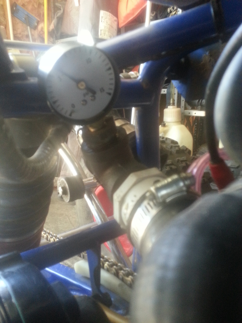

The difference between a 50 and 52 pilot should not be melting down though, and if your riding not idling it really shouldn't be. I always thought it was a pain when I was younger, but I dont think there is any smarter thing you could then leak down your motor after any work has been done that could compromise sealing. I just did mine today. Thankfully it was a sealed up sunday

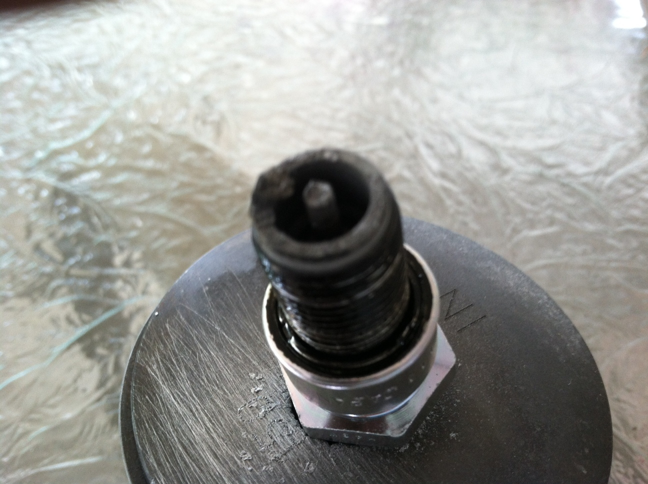

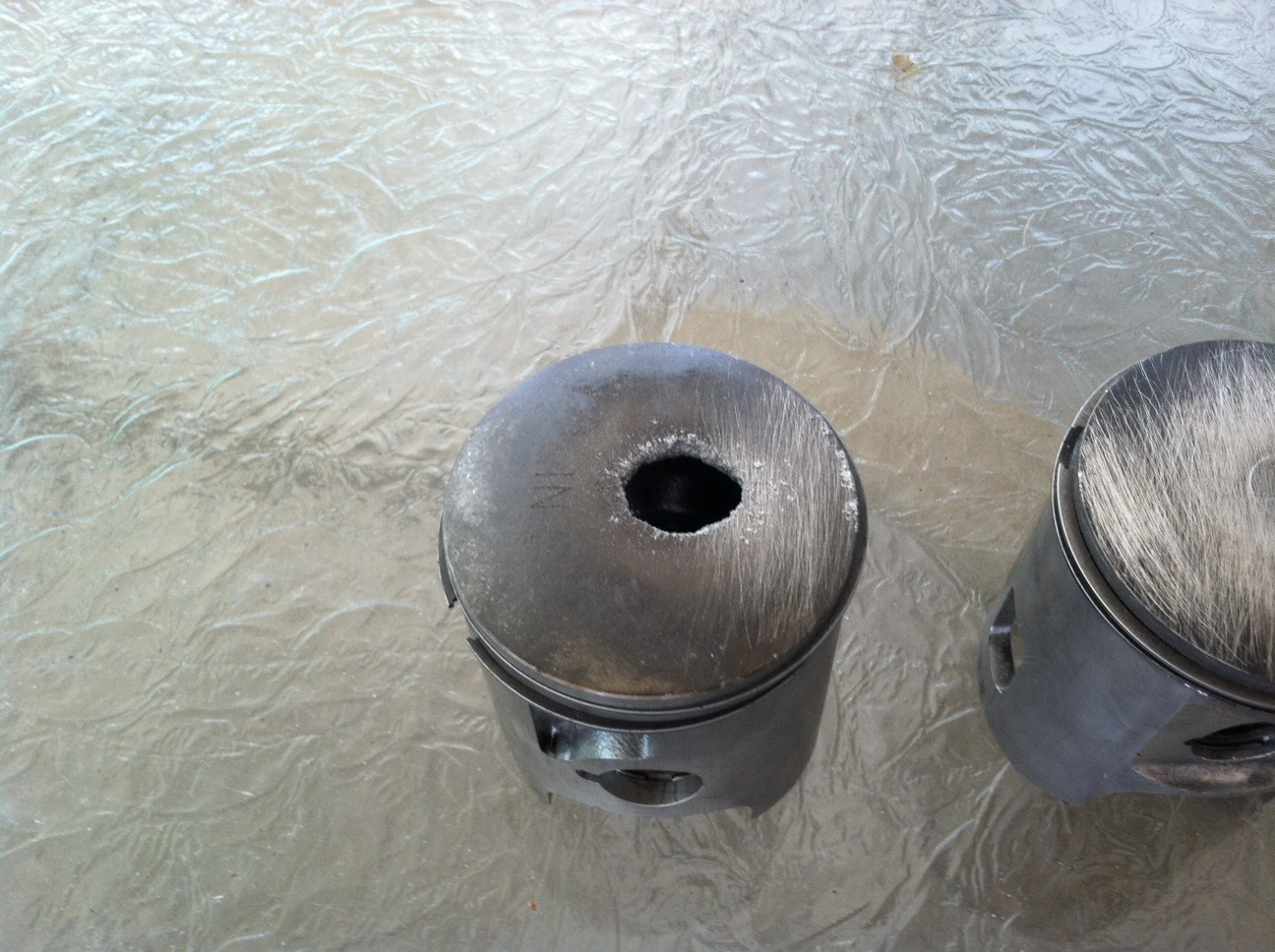

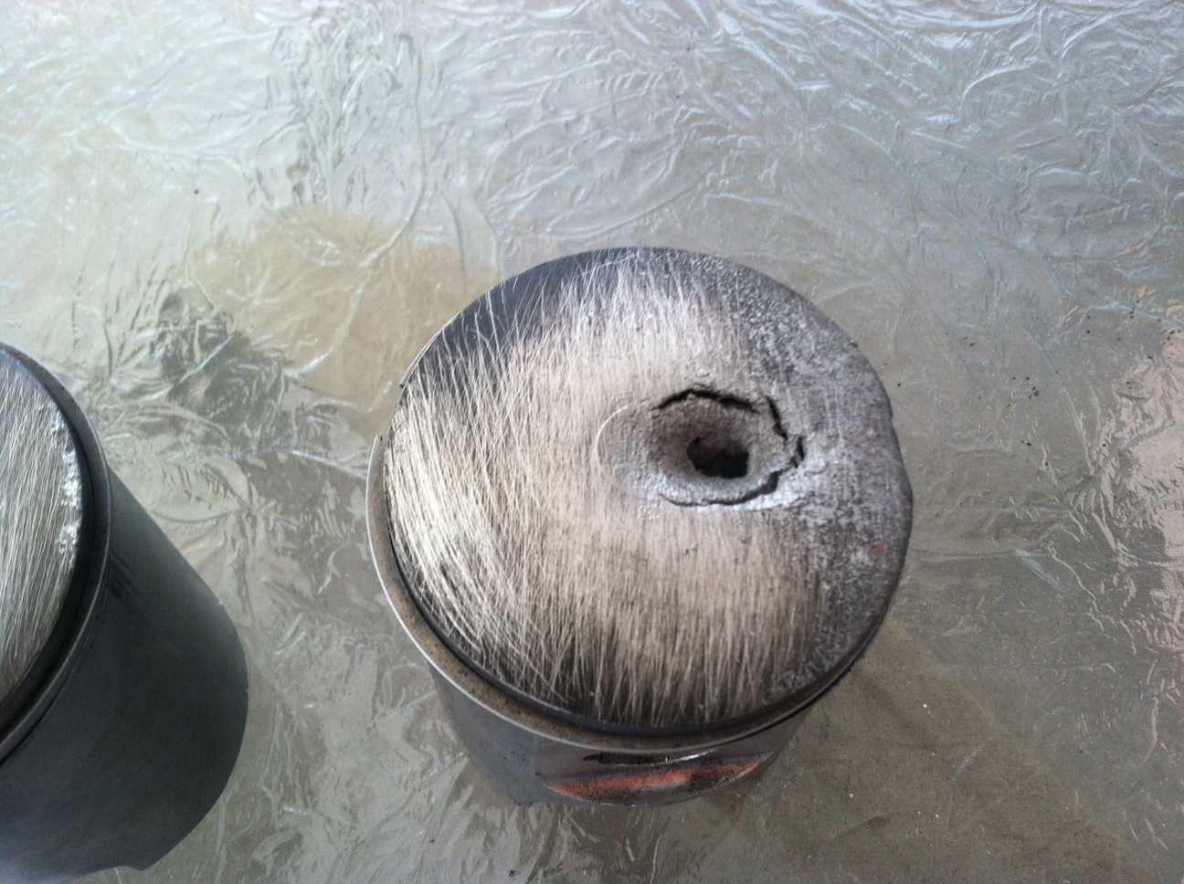

Here are the pistons. The first pic was the completely stock motor with a PWK 38mm. The second one is a completely rebuilt motor different cases, cylinder work by LED, new V-Force reeds, new UPP intake, new bearings, new seals, different crank. Also here is a brand new plug completely melted down. I just did a leak down has an air leak at the stator side crank seal ( a brand new seal ). Is there more going on here though? would an air leak do that to the plug. I can't stress this enough this is happening in less than ten minutes at 1/2-3/4 throttle.

The porcelain is broken off the spark plug so some detonation was happening but that more than likely was caused from to much timing and/or to lean of needle
I would try a differant CDI and a richer needle

the piston exhaust side skirt on the left piston does not show major signs of being lean so I tend to believe that ign timing is advance possiably because of a bad CDI.
This does not mean you dont have to add more fuel also, but IMO it sure looks like it may have to much timing

Agreed I will make it a point to do a leak down every time i do an engine rebuild. Cheap insurance for sure.

You can't see it in the pic but the plug is white. I did find the stator side crank seal is leaking air. I do have another cdi to try.

I think it's ignition and your air leak.  The normal Arlan jetting is 50-52 pilot dej needle in the 4 clip and high 160' to mid 170's on the main. Even at this a bit leaner needle still wouldn't do what's happening like Dave said the rings are free on the piston and the exhaust side of the piston doesn't show scuffing.
