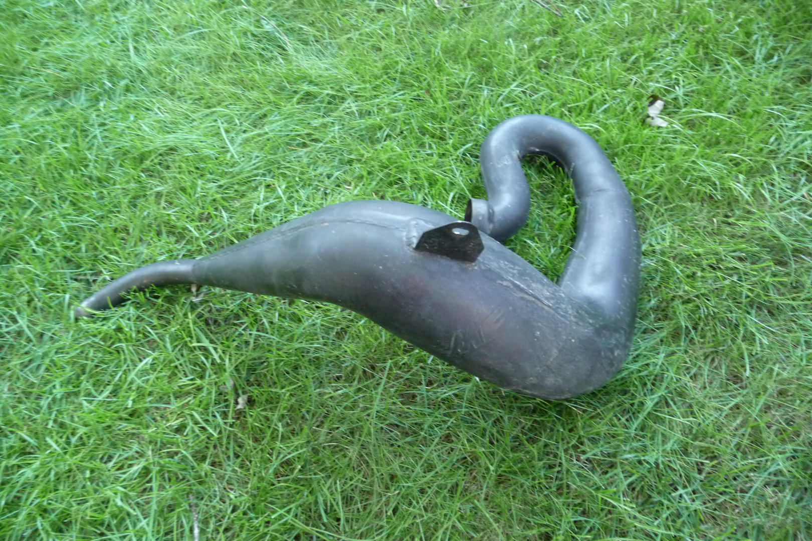

I took my pipe off the other day to fix a leak at the flange, and found that the flange did not fit tight. It was leaking because the gasket blew out, which I'm pretty sure happened due to the loose fit. Are there different flange and pipe sizes? Just curious as to what I need to do. I will post pics after I get out of work.

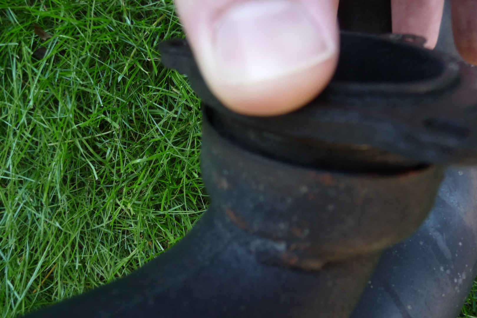

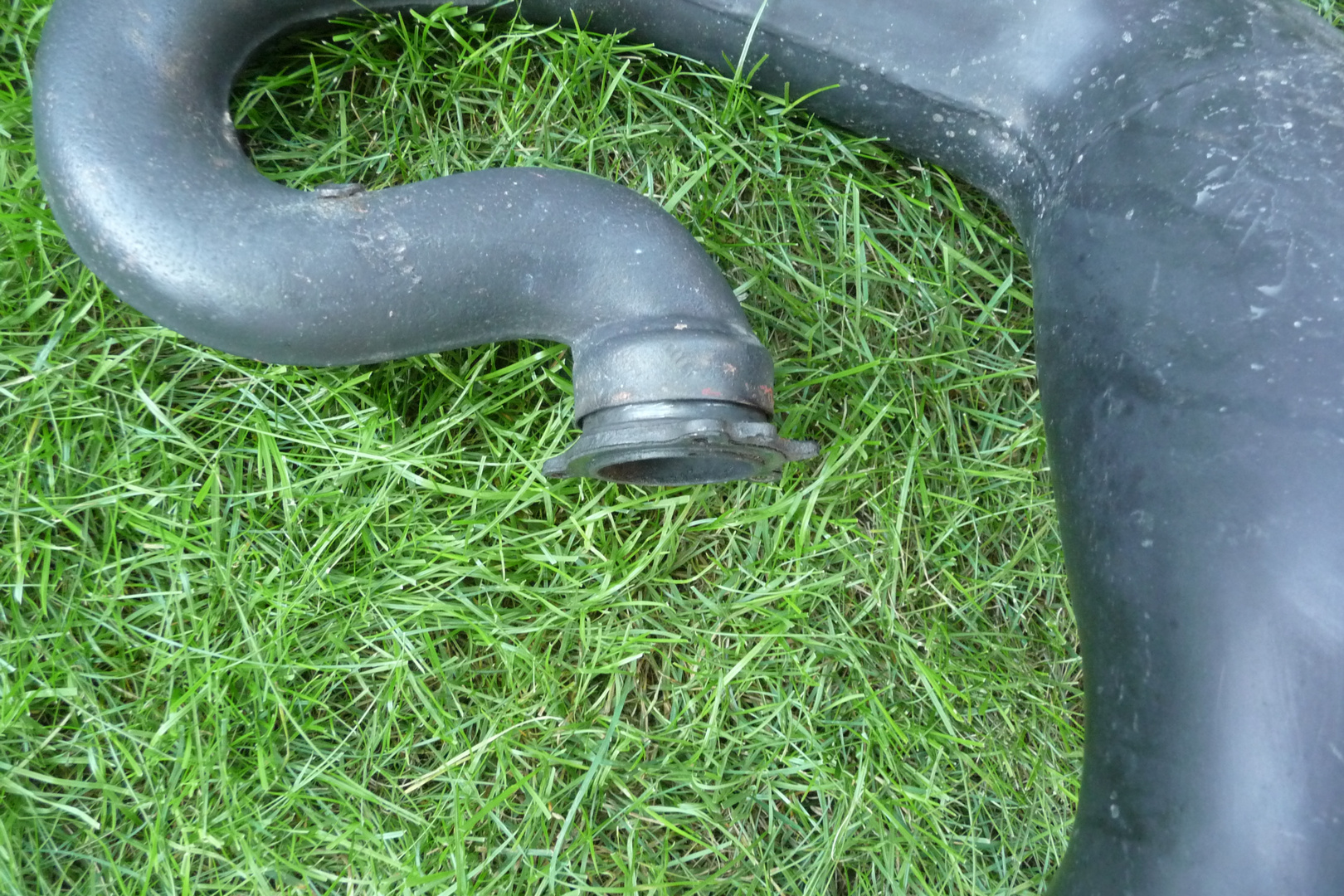

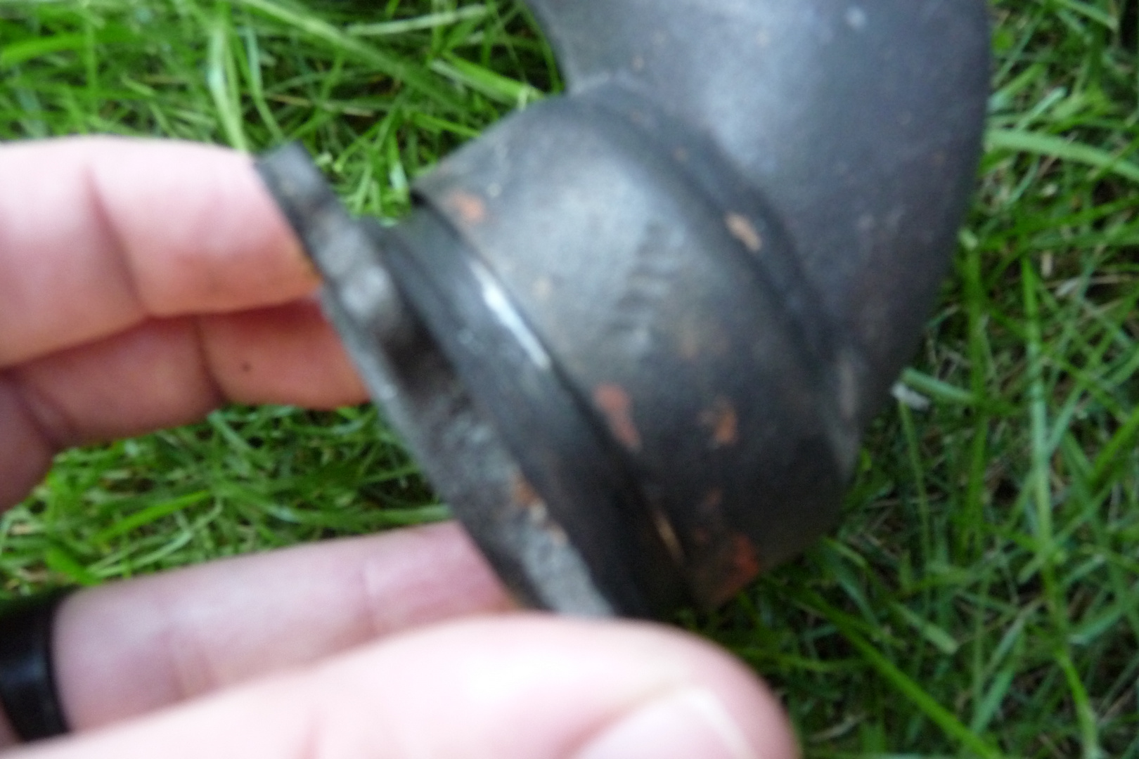

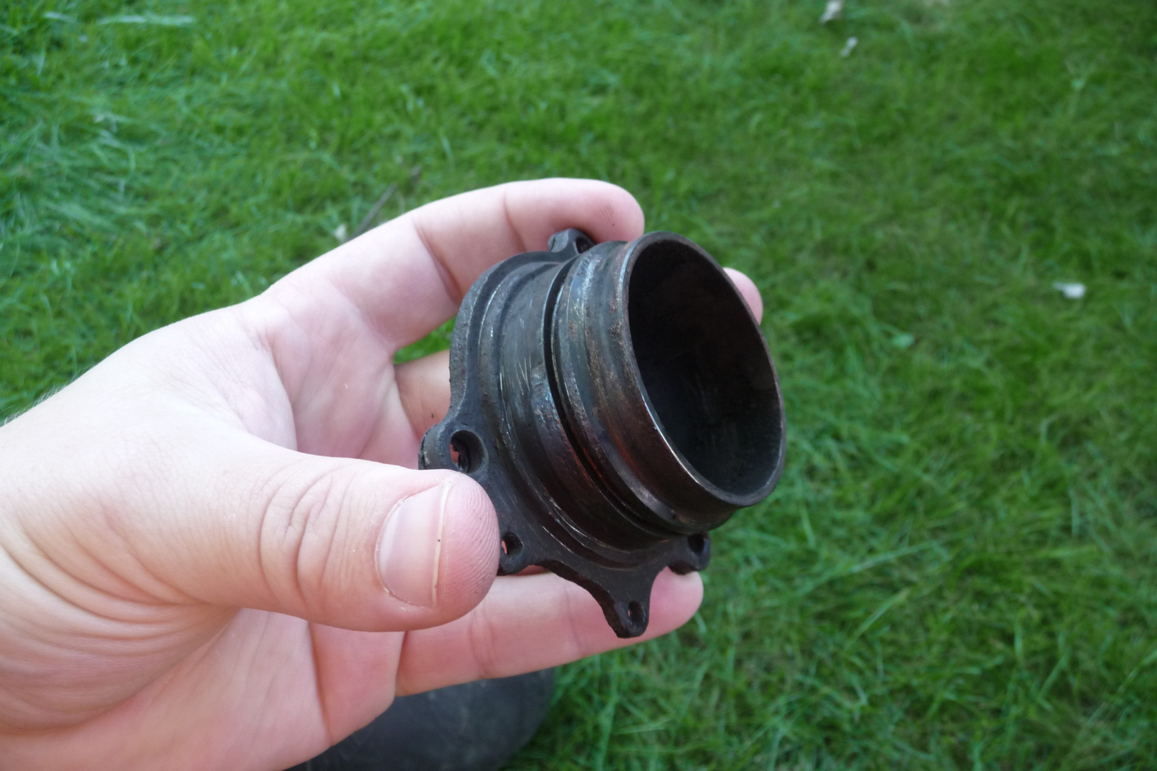

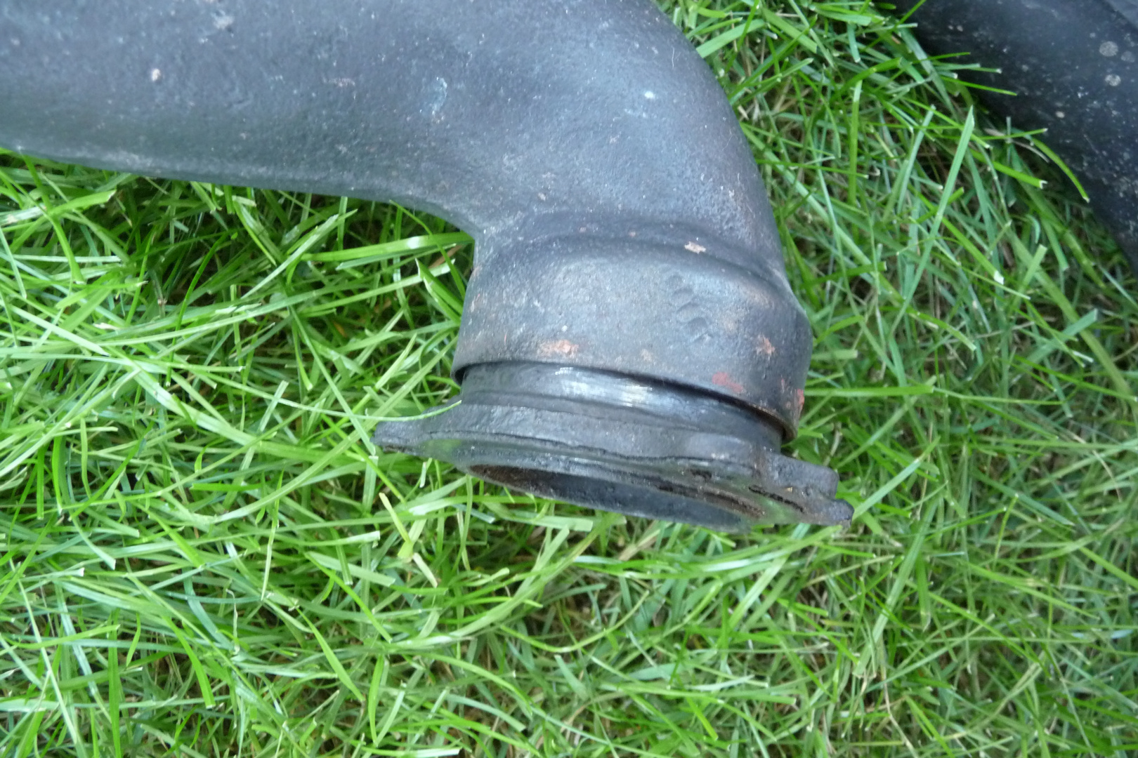

Pics uploaded. The flange is all the way in in the pics and there is still about an 1/8" to the top of the flange. there is about a 1/16" gap between the wall of the pipe and the flange. I'm not sure if the gaskets will fill the void, but it doesn't seem like a good fit to me... The pipe is FMF, and that is about all I know about it. It looks like an atc pipe to me, but I haven't been around this stuff for long enough to tell. Any help would be appreciated!

You are missing the steel ring that goes on the exhaust flange. They have been discontinued but a thick o-ring may do the trick. Thats what I did with my OEM replica's. 2 o-rings to seal twice as good.
