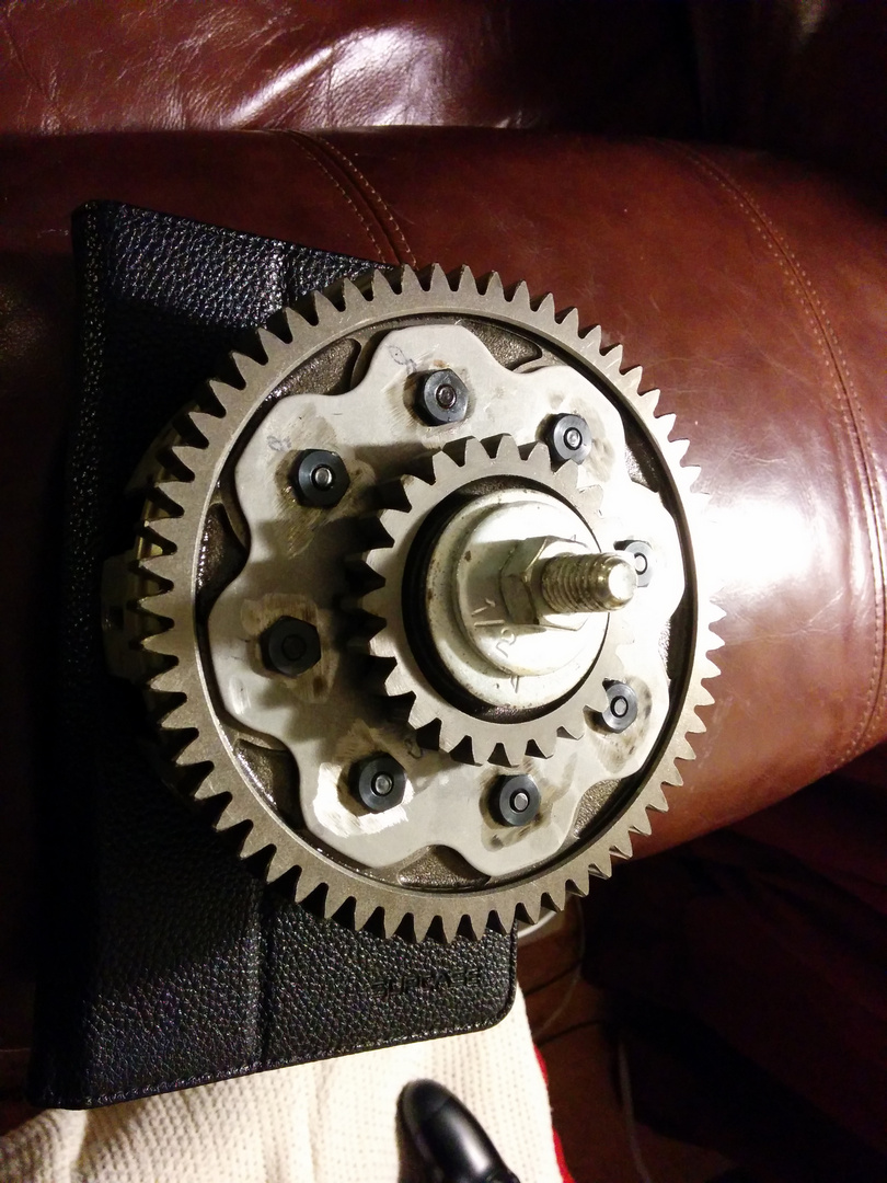

« Reply #24 on: February 05, 2015, 08:55:14 AM »
Offline countryboy9799
Clutch was real grabby!
« Reply #25 on: February 05, 2015, 08:57:52 AM »
Well I got her together. I wish I would have made another heavy washer from the flat iron instead of using washers. On the gear side I used washers but it didn't start straight so I had to turn it over and put a block inside the basket, turn it over and pound on the gear to get it straight. I managed to pound it on all the way and so far it looks good. I just hope I didn't warp it or anything.
« Reply #26 on: February 05, 2015, 09:48:22 AM »
Quote from: countryboy9799;49826
I guarantee you this is the way we all felt after getting the gear on. Seems it would have been a little looser. This concept you are using has been used when putting the water pump bearing in also. Some guys will only use this method.
« Reply #27 on: February 05, 2015, 09:53:15 AM »
Well that makes me feel better. It seems flat on the wife's dining room table lol. If I had to do it again I would definatly use 2 of those pieces of flat iron that I made, I am sure it would have stayed straighter.
