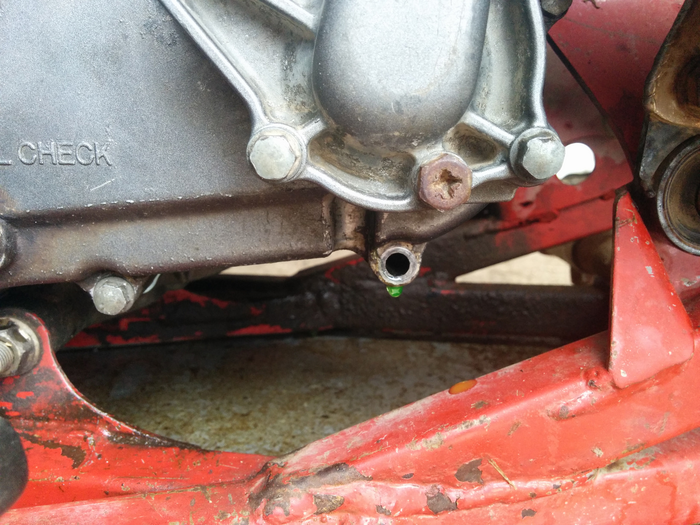

Well I have some leaking out the weep hole. Now I am wondering if I put something in wrong or if I am missing something. It was leaking pretty good so I turned it over a few times to help seat the seals and it did slow down but it did not stop. Anyone have a good pic of how that black seal with the spring was supposed to go on?

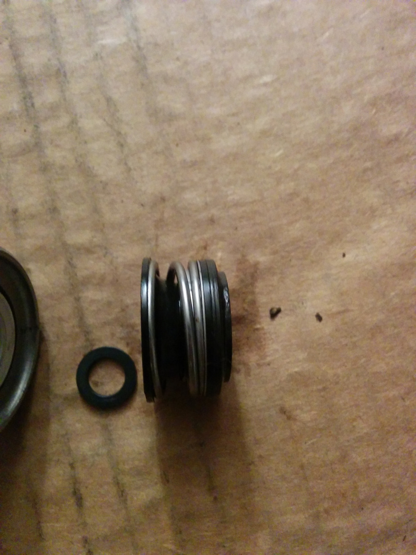

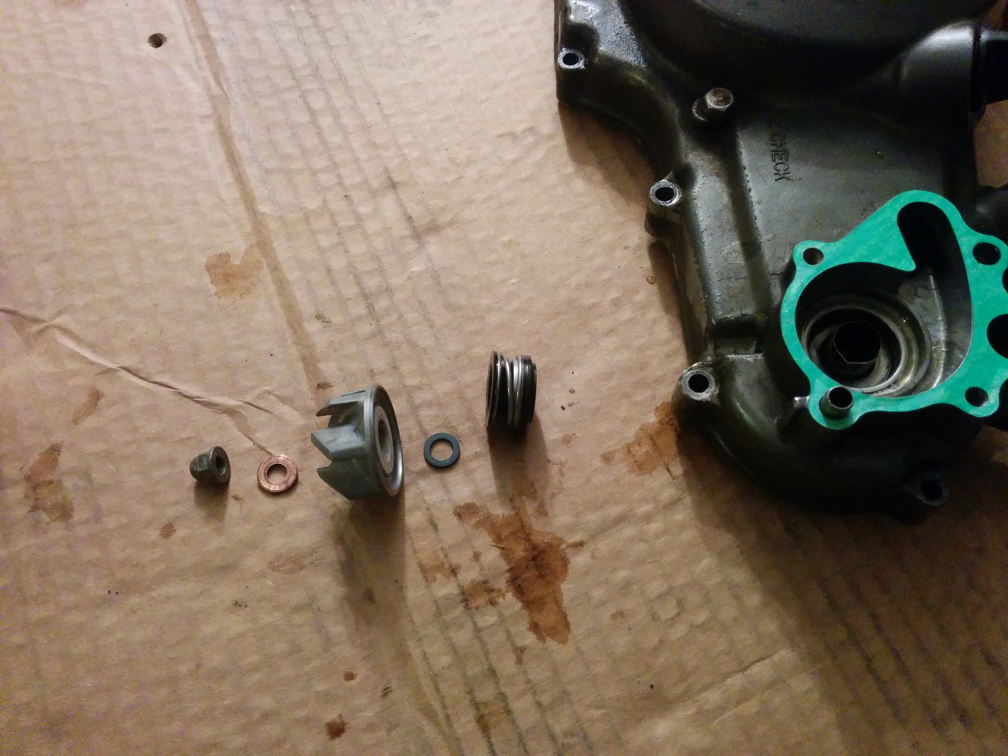

The only thing I replaced is the bearing. It sat for the last 7 years and didn't leak. I might have to get a kit but would like to try it one more time. If you look at the pic that is the way I installed it, is the mechanical seal the right way? The right side went in first. The way its laid out is the way it went in. Is there anything missing?

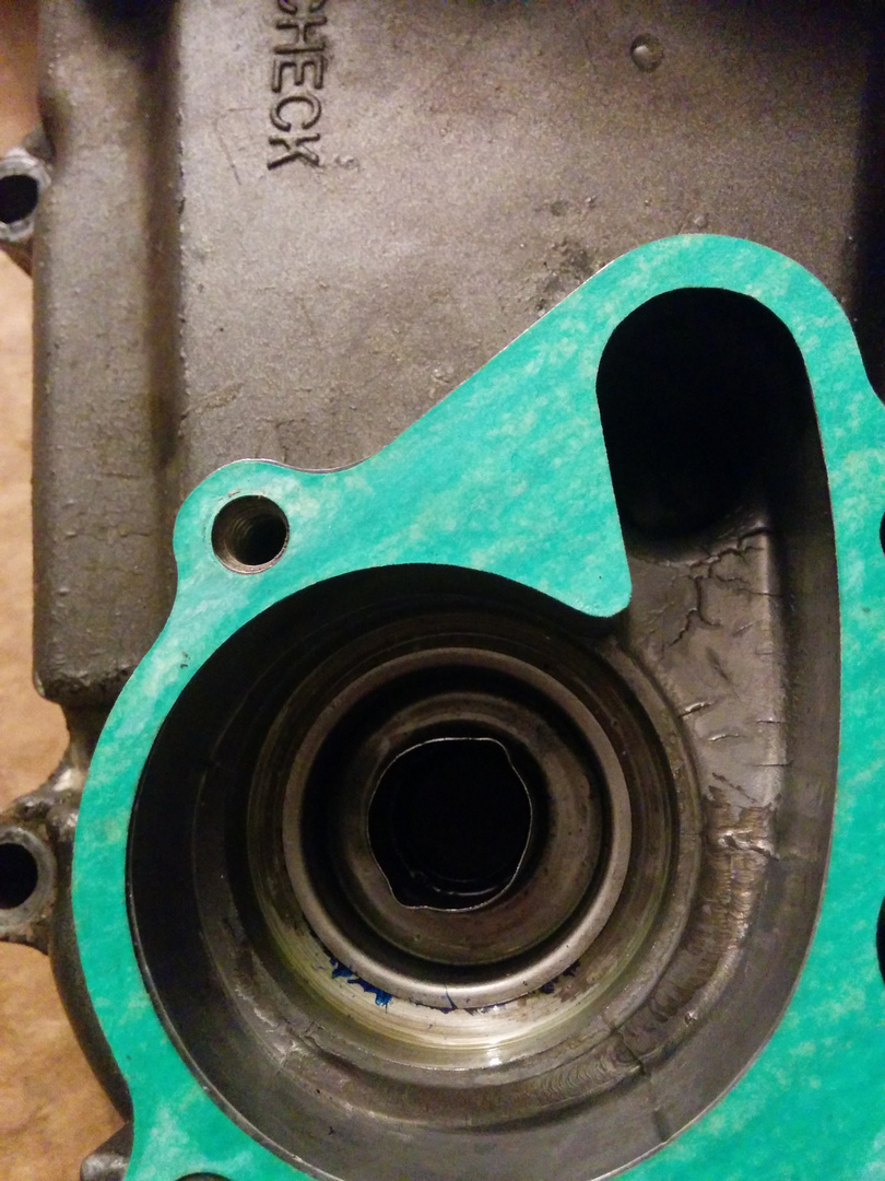

The mechanical seal is all one piece. The metal part of it is still in the clutch cover. We cannot tell from the pic which side you have facing the porcelain. Then again no one has seen the other side as it is attached to the metal piece in the clutch cover. But it does look correct to me. I believe as the impeller turns your seal is turning also.

So which one is the mechanical seal? As far as I can tell there is a white seal that is in the impeller, I never took that out. Then you have a black rubber piece with a spring on it. The metal part in the clutch cover I never took out either. Can you explain whats what? I took some closer pics. If you look at the black rubber piece with the spring on it I put the right side in the clutch cover first, that end is more pointed. It looks like that black rubber piece could be replaced, that doesn't spin I don't believe. I think only the white piece in the impeller spins. Which part do you think is leaking?
