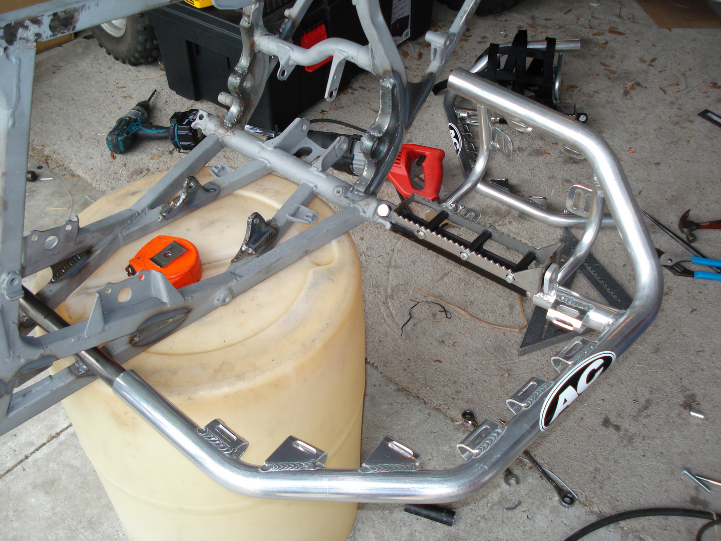

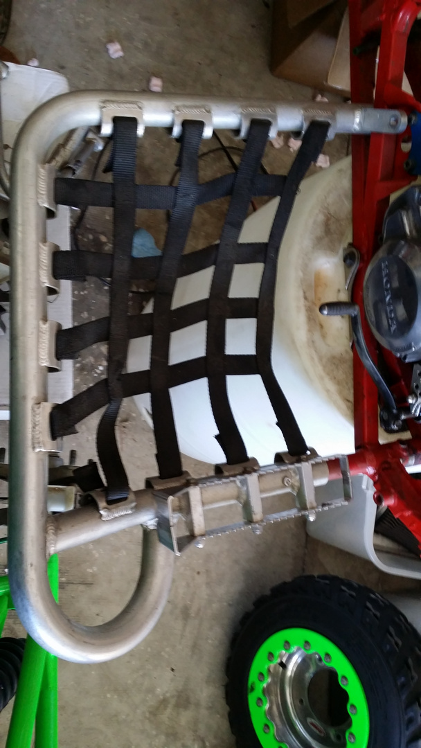

These are 88 on an 87. Just cut the threaded bung off both sides slide a pipe thru( mild steel from Lowes will work fine) and burn a small weld around it. Very simple. It Also places the pegs in a better location. Then u will need a large washer and one of your original footpeg bolts for your rear brake lever. While u r at it u could make a front propeg mount also
The tpop pick was done for a quick last minute fix to ride as I had No pegs or nerfs. It could have been a little better craftsmanship and closer to frame but I didn't want to cut the tabs off nerfs since it was temporary

Thanks for the input and especially the pics. Helps a lot.
