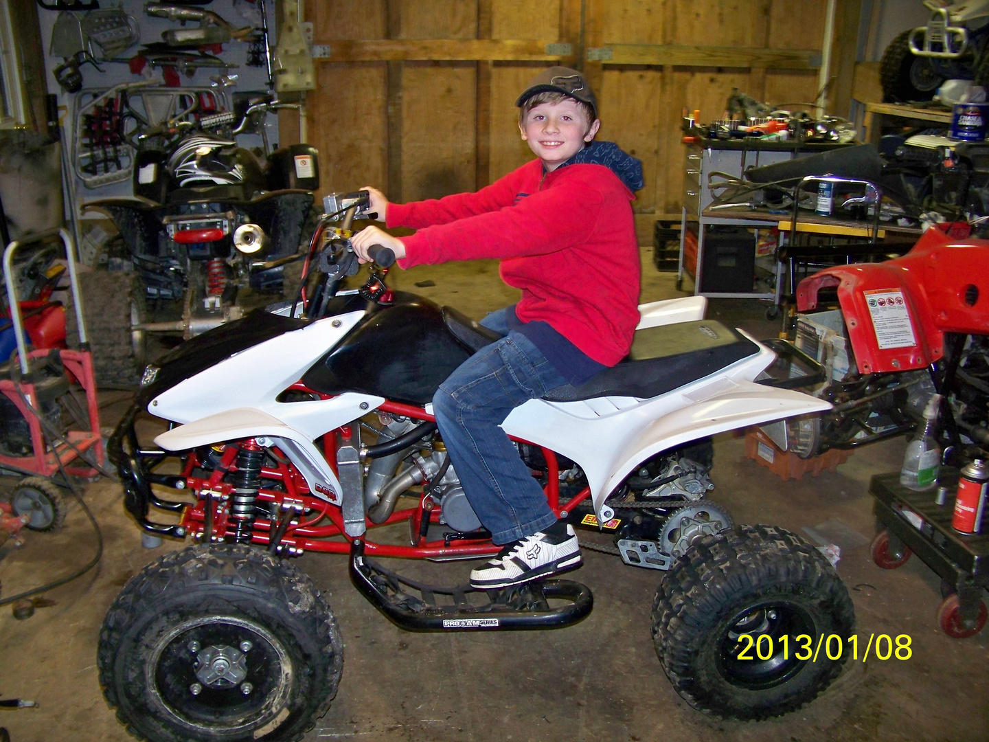

My name is Jim and I am new to the site.I have been riding, building & parting out quads and ATCs for the past 30 years.
This is a quad we picked up a few years ago when my son was still racing a DRR. We just pulled it out and started working on it.

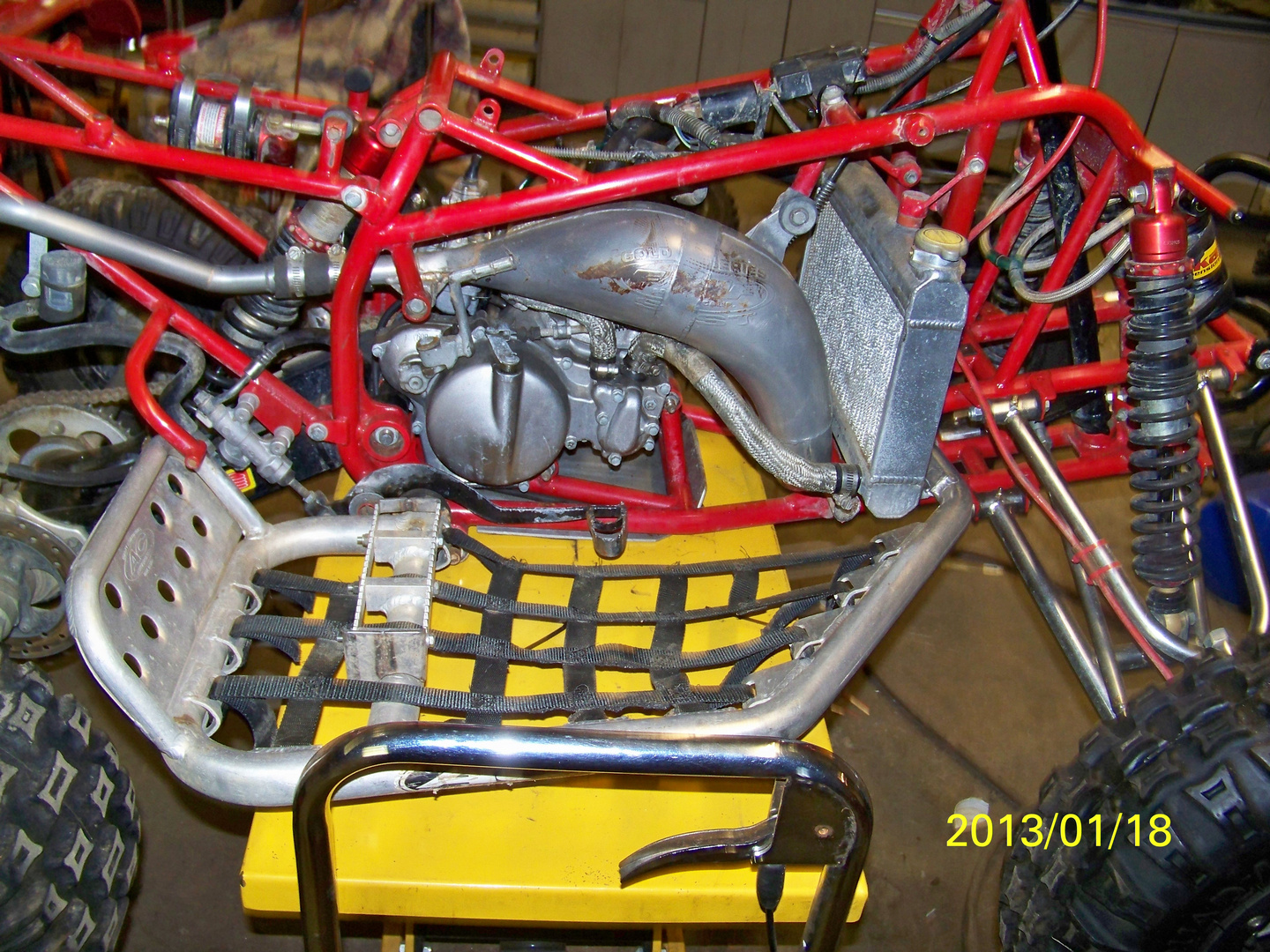

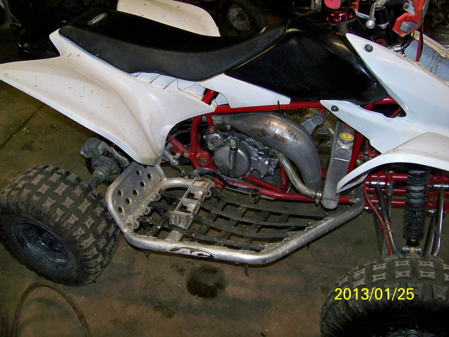

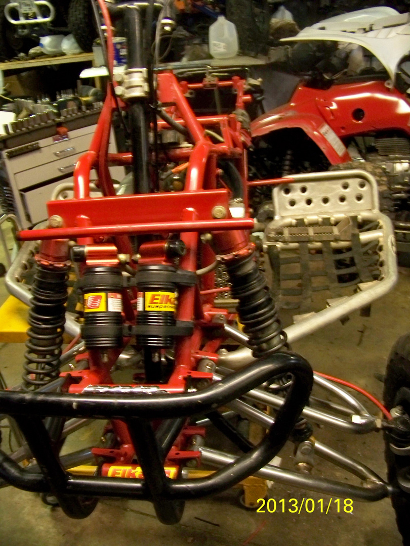

It is a custom built 250R geometry frame, 250R a-arms & 400ex knuckles, hubs, brakes, custom built no link swing arm, custom built stem, 450R rear axle, brake caliper & plastic. We have 3 engines stock CR85, ported 90 stroker & a 105 ported stroked & bored super mini CR85.
We are upgrading the rear axle with a Dominator II, the knuckles, front calipers from a 05 450R & Hardkor hubs. We are trying to find long travel 250R a-arms and shocks with out breaking the bank because We need to have the shocks rebuilt for a 115lb rider. We would like to find MOTOWOZ because we loved them on the DRR
