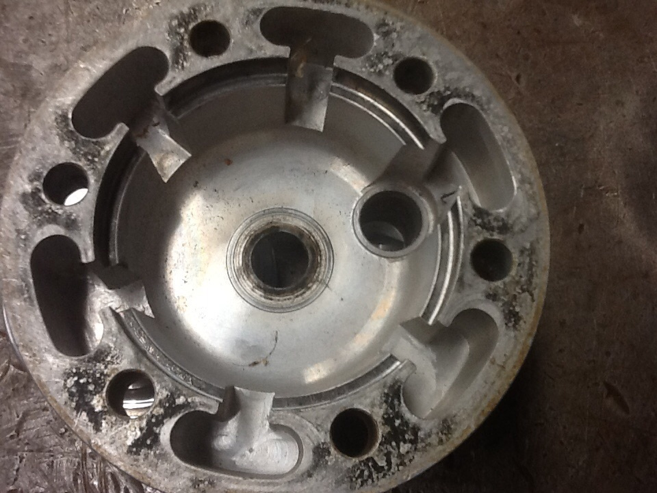

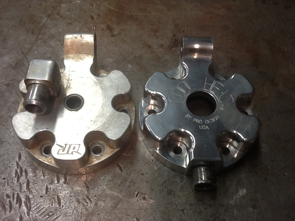

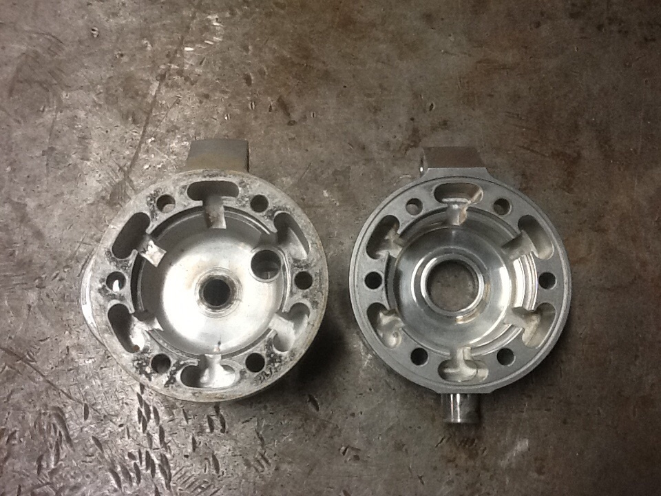

I got this JP head shell in a parts lot & looking for a dome. It looks identical to a pro design head except for the spigot & the dome is a little different.
The dome on the JP head seats against the inside of the head shell instead of going through it like the pro design. If I can't find a dome I might try to modify a pro design dome to fit:

Those look similar but you can see where the hole in the head shell is large enough to allow the dome to sit beyond flush so the plug seat's against the dome. On the JP head the plug sealing washer seats against the top of the head shell & not the dome. It looks like an extended reach plug might be required on this JP head.

I have a couple old Domes I could cut to see if you could use a modified off the shelf pro design, I was thinkin it looked similar to a Sprock Tri Z Dome also.

I measured a pro design dome & it won't work to modify it for the JP head so if anybody has a JP dome they could take pictures of from the top & bottom & maybe some measurements, it would be greatly appreciated. Thanks.
