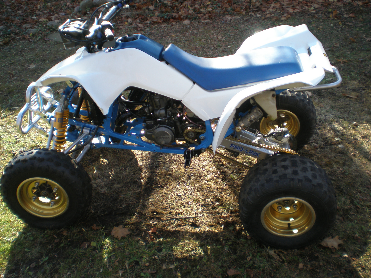

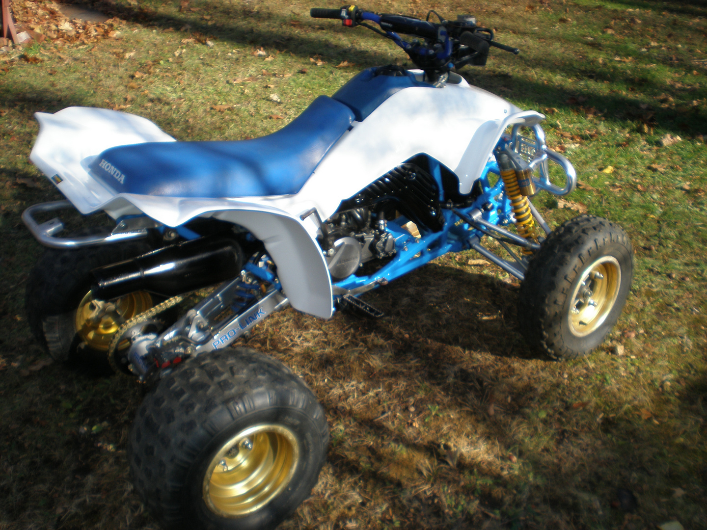

Well I checked the stator and it was super clean in there. I changed it out and it runs great. The only problem is the kickback. It kicks back something fierce. Is th there anything I can do about that. I just built this thing. Never had one before now. I love it. Here's a couple pictures of it. I have spark when I hand crank the engine which I didn't before
