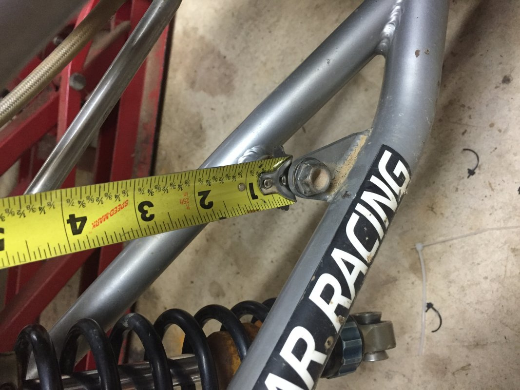

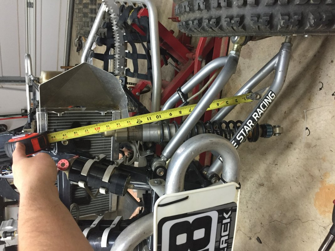

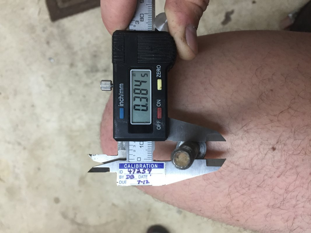

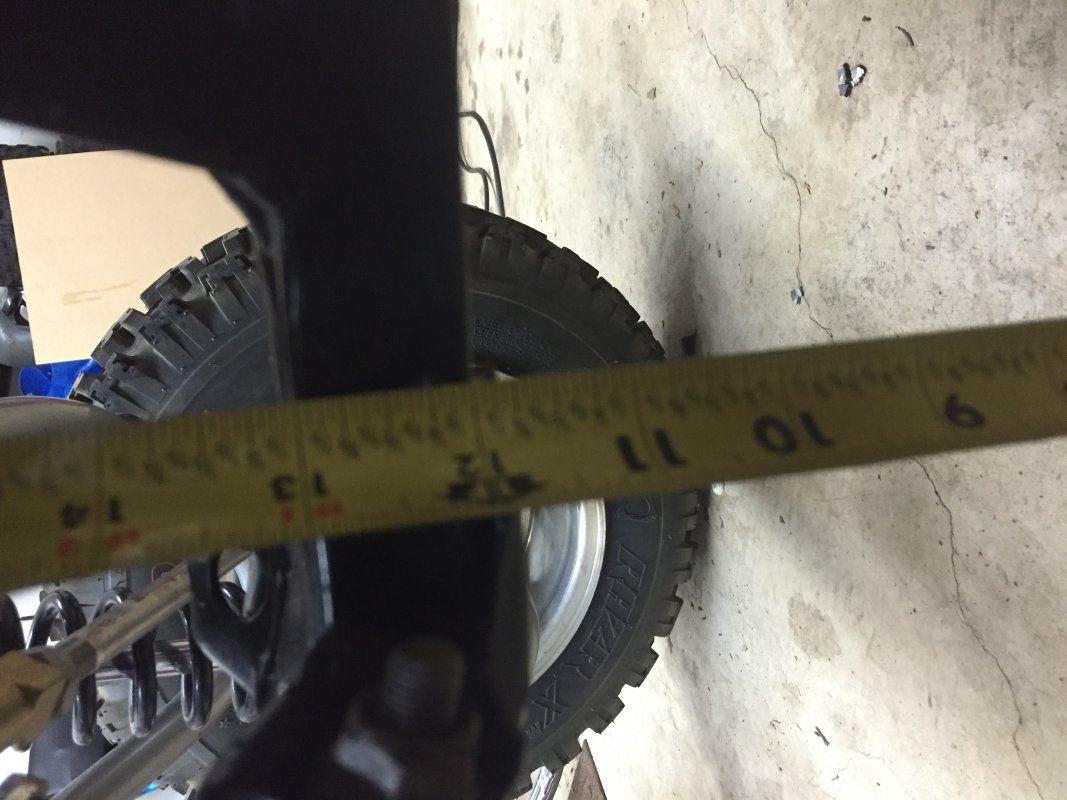

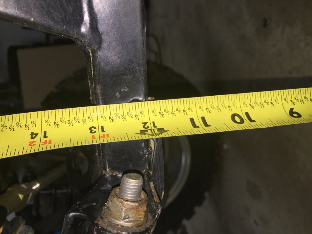

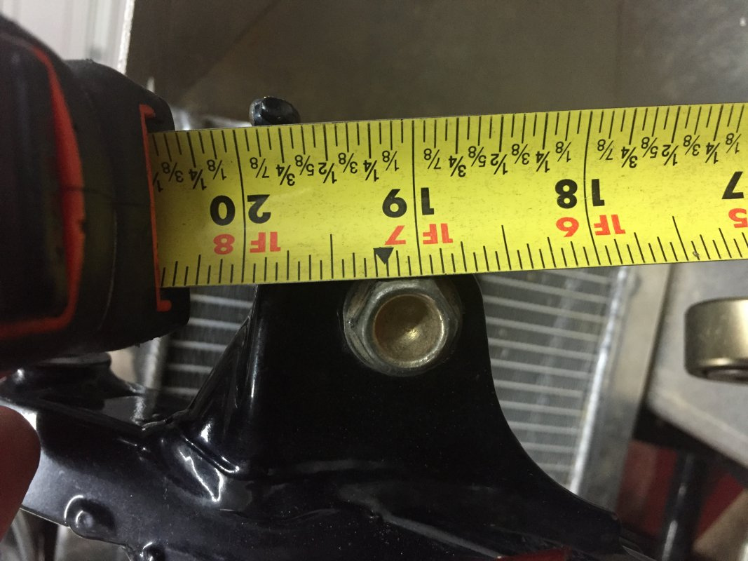

Checked my measurements. Can't speak for the other styles, but the newest style DC-4's definitely take a 19.25 length shock.
Anyone ran Lonestar DC4 +3+1 A arms? opinions?
« Reply #13 on: May 02, 2016, 06:40:18 PM »
« Reply #14 on: May 02, 2016, 06:41:56 PM »
Tape measures shows 19-1/8. Then add in half the diameter of the bottom bolt, and you have 19-1/4. And no binding of the tie rods.
