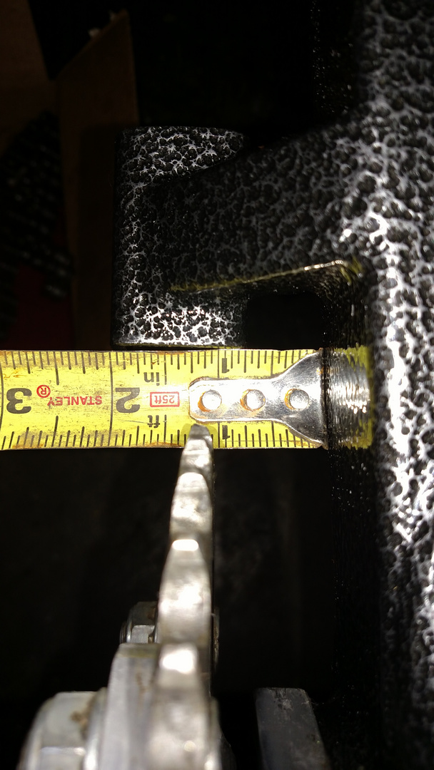

I'm posting pics with measurement tonight.  1 5/8 to the outside

my chain rides a lil to the right on the tm rollers its not dead in the middle but i have no wear issues. hope the pics help. my swinger was new 2 years ago if that info helps. if ya need anymore pics I'm happy to help.

Can you explain those pictures it's hard to tell

1  5 /8 off the swinger to the outer edge of swinger guide. 1/4 inch to inner edge of guide mount off swingarm

OK I will check mine out, I'm pretty sure I'm way more than 1/4" off swinger

Mine is 3/4" inside and 2" to the outside

How old is your swingarm, I guess they have changed them over the years.  Called lsr, sent pics they say it's supposed to be 3/4" off the swingarm.  I might end up putting the chain guide in the mill and making a spacer for it to move it over.
