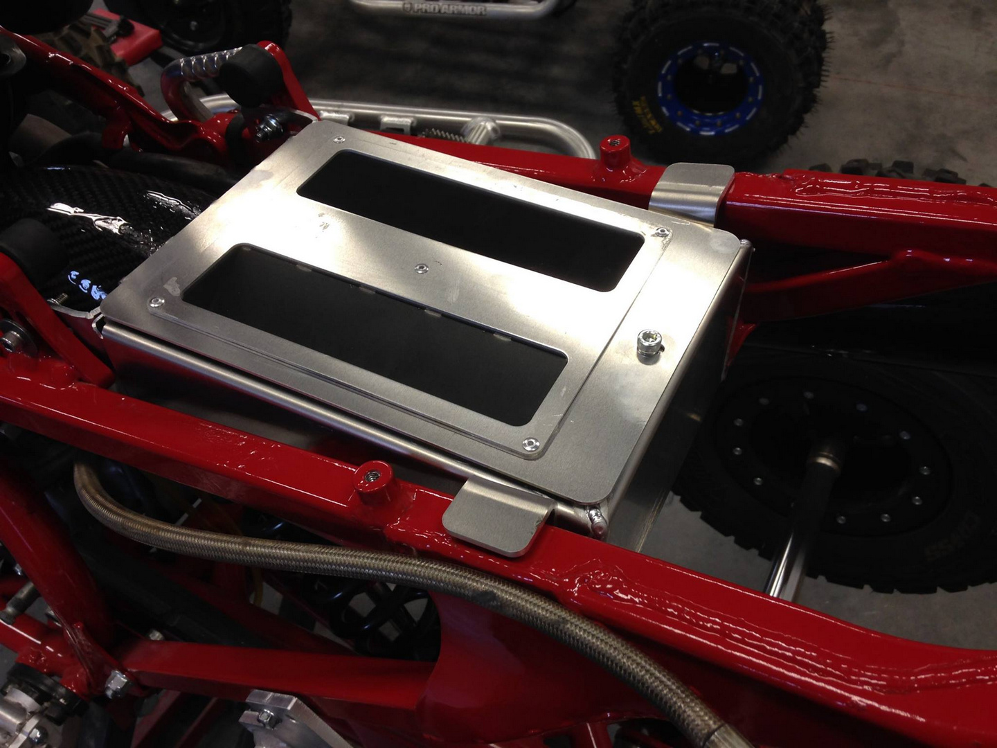

Quote from: troybilt;66788
The air-box eliminator style will come next.  Separate intake design for that....
I got my buddy to buy your 450r intake kit w/ air-box and it looks sick. You can turn it into an eliminator style by unbolting the rest of the air-box right?
Quote from: troybilt;66792
True, but there is plenty of eliminator style intakes out there already like LED, etc.. The guys that race MX/XC are in dire need of some improvements in the intake and air-box area
Amen to that. Troy will an air-box lid like the one shown below will be offered?
Offline troybilt
Robl Engineering Prototype Intake Completed
« Reply #147 on: April 21, 2016, 09:55:35 AM »
Quote from: Tbone07;66807
tbone, originally yes I was going to follow the same train of thought with the 250r airboxes.  The problem is the subframe rails are angled in, so part of the box has to be below the subframe and the rest has to fit in between.  Unless I chop it up and have a ton of welding...  I decided to keep it somewhat simple.  What I can do is offer a package so if you want to run an eliminator style, you'd just have to swap to the bracket.  I tried to do a similar lid, but the lid can't be flat like I was able to do on the 450r.  So far the R has been far more complicated to do an airbox for, even more so than my YFZR setup....  howeve, I'm not complaining, I like the challenge.

Quote from: troybilt;66809
If I back off from using the S&B filters, (which are really good filters!!)...  there is more room to work with if I stick with the standard 250r filters.  I might see if S&B can make a custom filter for me that is similar in size to the standard 250r filters.
Would custom filters be more difficult to obtain in the future? And how fast could we get a filter if needed in a pinch?
It would be nice to be able to go to any online store and buy the type of filter (foam, K&N) that is desired. Whether that's a 450r or 250r filter.
How significant is the difference in flow capabilities between the 450r and 250r filters? I imagine if you're in big Sphynx or Puma territory it would be greater
