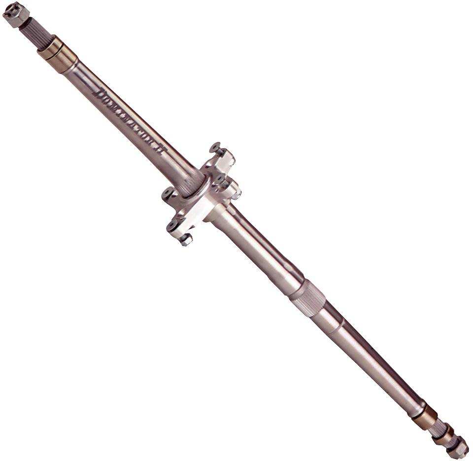

https://www.team-rpm.com/honda-atv-parts/trx-250r-honda-atv-parts/sprocket-hubs.html
http://www.team-rpm.com

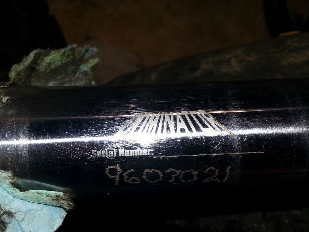

 I found a pic on their Facebook page....Does your Axle look like this ?
« Last Edit: May 24, 2016, 12:53:14 PM by Langbolt »
Offline muthahucker
Axle splines
« Reply #10 on: May 25, 2016, 01:57:41 PM »
Looks very similar to that.  I'm pretty sure its not a lonestar axle.  There are no markings on the axle shaft that I can find anywhere.  Any pics of lonestar I have seen has a flat spot in the middle of the axle with its model info on it.
Axle splines
« Reply #11 on: May 25, 2016, 08:27:46 PM »
Rpm will have the flat spot in the middle   model an serial # I'll take a pic if mine  an post it.
