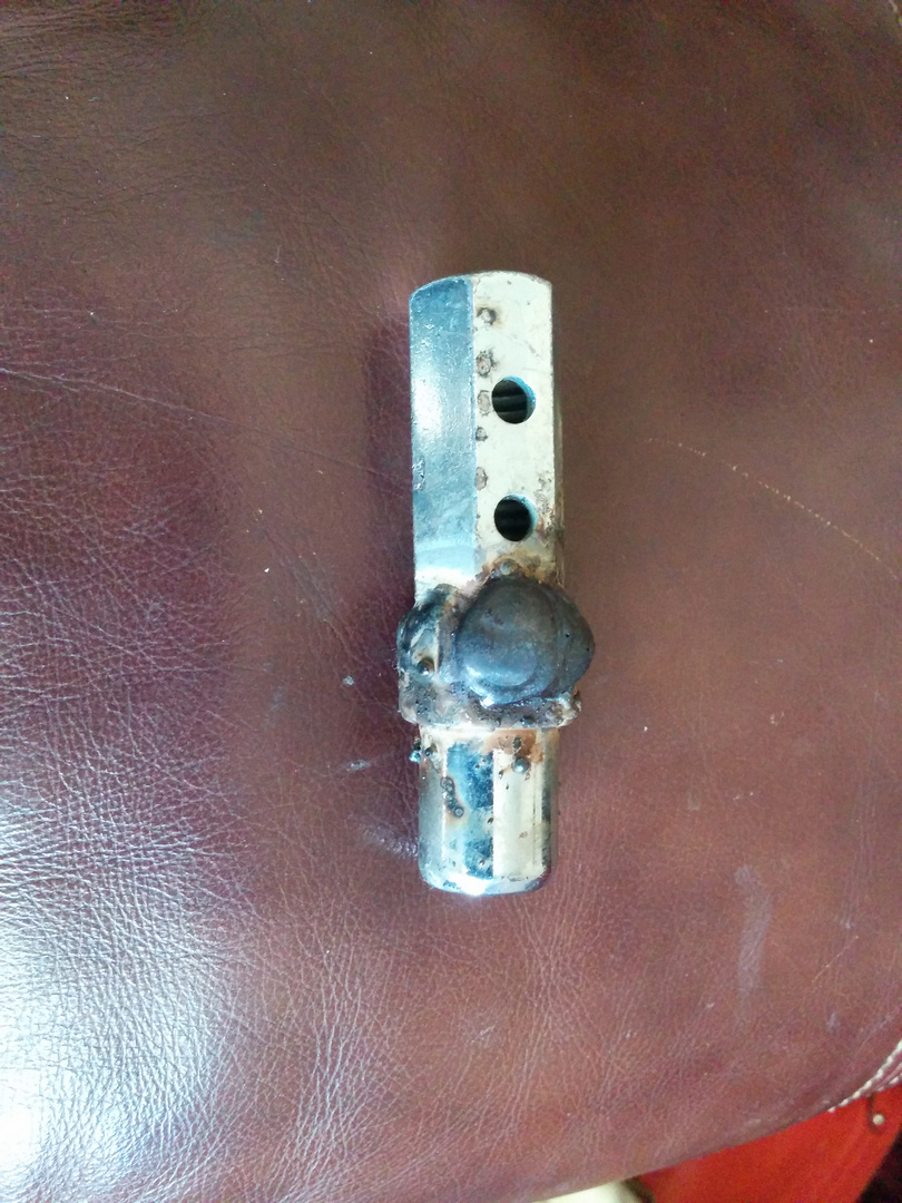

What do you guys think of my homemade crankshaft puller? I made it using a 12x1.25 long lug nut welded to a 1/2" coupler. I will use an 1 1/4 steel pipe to but up against the bearing. This is for the flywheel side. On the other side I will use a 10x1.25 wheel stud welded to a coupler.

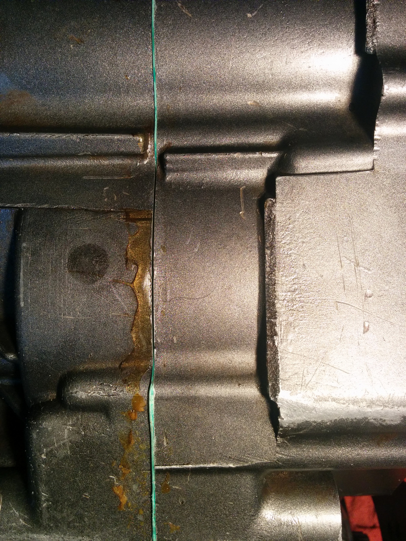

I put the cases together last night without the bearings, seals or gaskets just to see if they were straight and it looks good. There is a very small bit of light that I can see towards the front of the engine where the crank goes but that should seal up with the gasket right?

One other question, is my gasket going to be OK? I had the Honda dealer pull the crank into the bearings so I didn't have any problems with that. At first I thought the gasket got twisted but it isn't in there to far and seems to be straight.
Offline udontknowme
Low compression, whats next?
« Reply #56 on: March 29, 2015, 12:42:41 PM »
first rule of thumb, never let a dealer touch your bike. likely it was a high school kid doing the work. the amount of money you payed them you could have bought the tools yourself
the gasket looks sucked in to me, atleast from the pic it looks that way. buy some tools and do it right yourself.

Actually I have had good luck with this dealer and they didn't charge me much at all. I tried pulling the crankshaft into the first bearing and didn't quite get it all the way. It took the mechanic 10 minutes to fix it.
I just performed a leak down test and that is good now.
