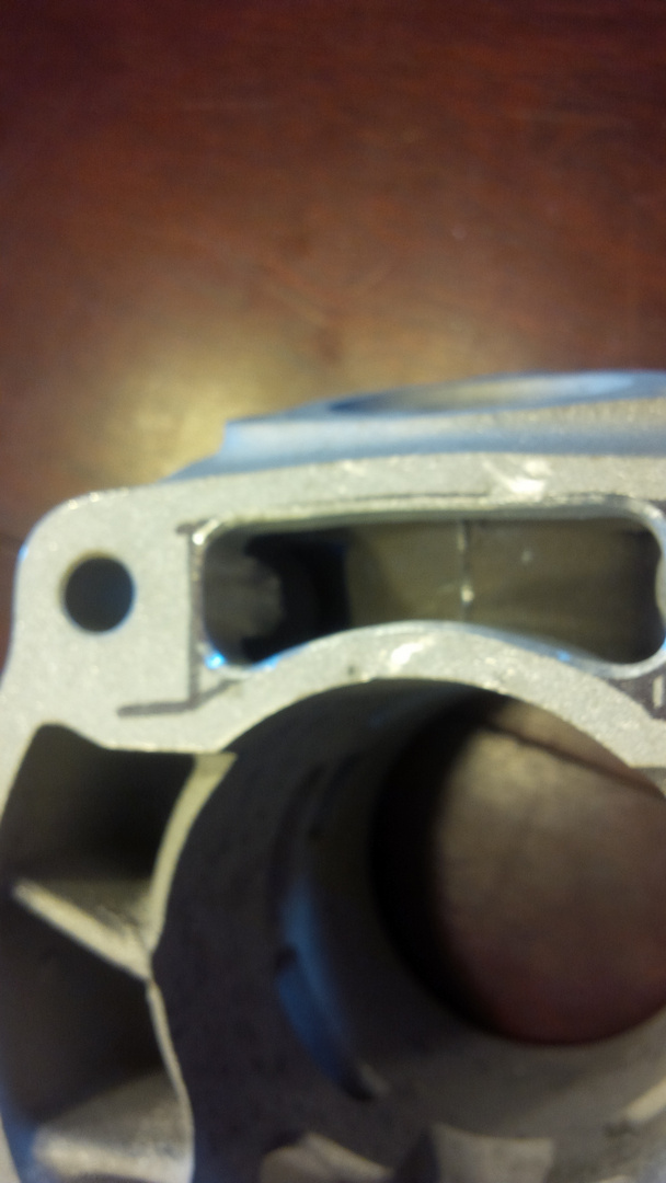

Did some machining on a ESR cylinder casting & you guys might not believe what I found. Will have more info once I can post a pic, so stay tuned to this channel.

That's a nice looking water jacket!  Details details..

Yes it is.

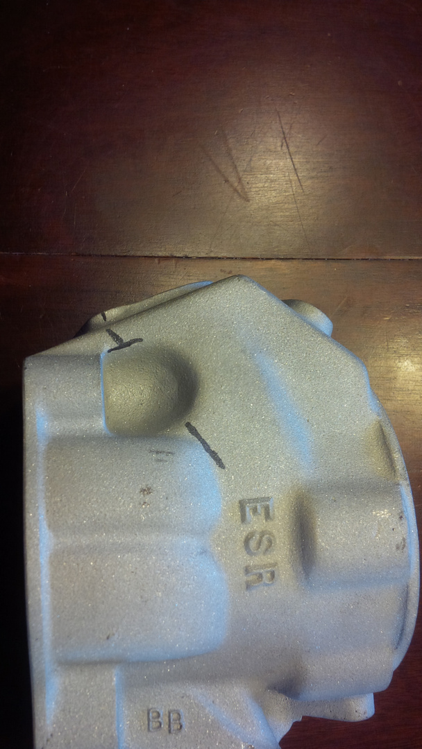

Sad part though, when Eddie came out with those cylinders, I was probably the first one to think they were solid aluminum under the exhaust port. Boy did I make a big a$$ umption.
Notice the number stamped into the casting under the exhaust port. If that number indicates from number 1 to how ever many been cast, that would be number 6 cylinder sold, so this cylinder could be one of the very early ones cast if that is correct.
You cant see it in the first pic, there are passage ways on both sides of the casting, so coolant can flow around past the aux exhaust ports & on down & under the main exhaust port.
The thum like cavity on both sides of the outside, where the case stud & nut sit to mount the cylinder, coolant can flow down past that area between that cavity & the main transfer port tunnels.
Now, since we know for sure coolant can get under & around the exhaust port area, what could be the real reason for so many piston seizures?
Neil

Quote from: Jerry Hall;27301
Please explain your theory why cooling below the exhaust port may be causing piston seizures.
Not causing piston seizures with coolant under the exhaust, that is not what I'm leading to.
My early thinking, back when Eddie first came out with these cylinders, that the area under the exhaust port was solid aluminum & no coolant could get down under the exhaust port to remove heat from that area. Now though, after I've done the milling down into the base of the cylinder casting, we all can see coolant "can" get down into that area.
If the casting were solid, no cooling jacket under the exhaust, then the exhaust side of the casting, would to a greater extent have to run much hotter than one where coolant could get under the exhaust port.
If coolant can get to that area, it should be able to at least remove some amount of heat build up.
The whole idea of this testing on a ESR casting, was to see if I could mill out the area under the exhaust port to create a cavity, then bore passage ways on both sides to the upper part of the casting so coolant could get down under the exhaust. Only trying to make a good product better was my thinking. Never know till you try.
Neil
