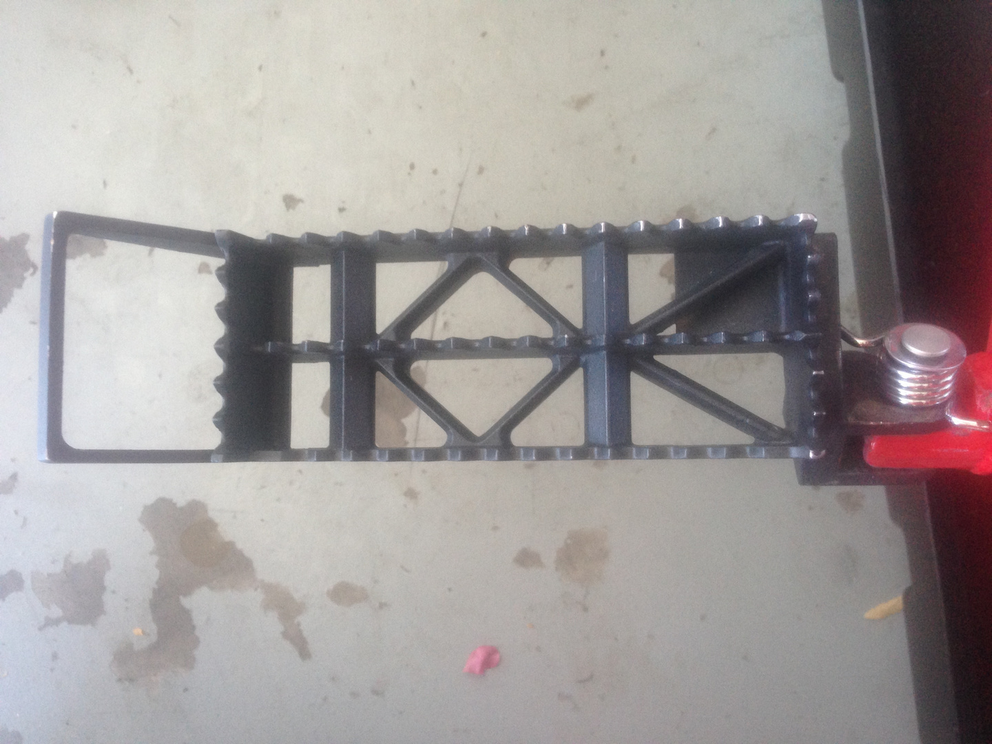

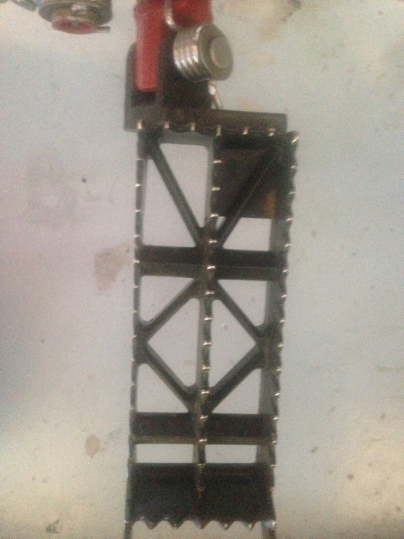

If you are looking for pics for roll pegs how to mount here are my 2 88"s. And believe me the springs will not come off!!

Thanks guys.  The Roll pegs don't have the tab/hoop and the ear has been ground down on the frame.  Anybody want a nice polished Roll 88-89 non-kick up set?  I'll run the black kick up Roll pair until I track down a LSR frame.

Thanks for the pics.  Good to know the springs would work if the hoops were still on the frame!

just make sure you buy new hardware from Honda those old pins you have will be bent and have more play than new ones!
