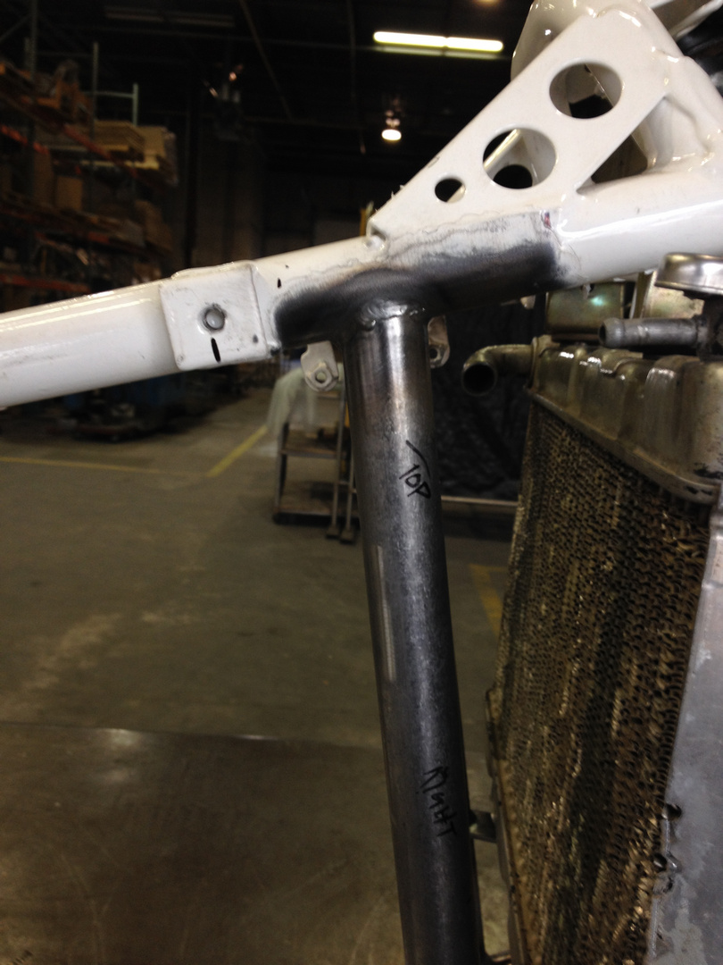

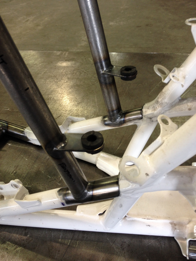

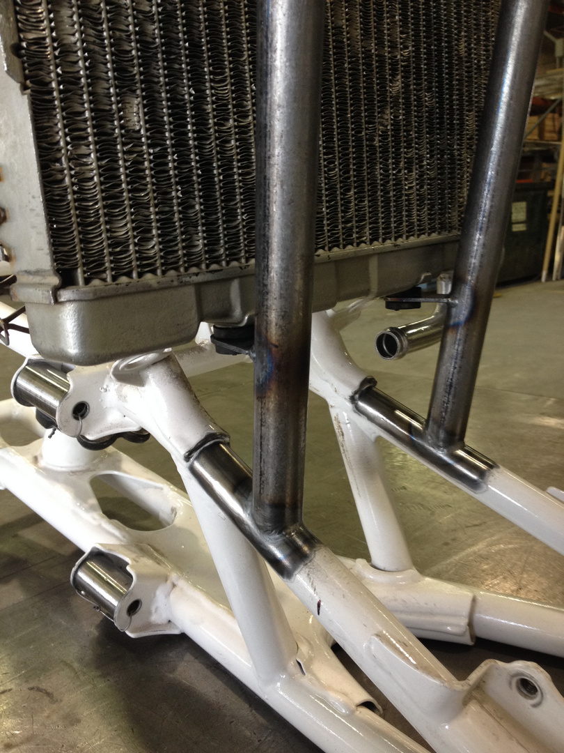

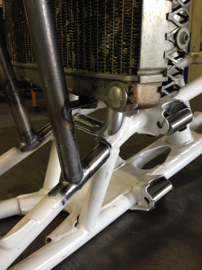

Made some more progress......Got the Rad Supports in and brackets all welded up. Fixed the Radiator to clear the Pipe. Now to fab up the upper mounts and make some new brackets (I borrowed the 250R ones....just to get it into the correct location) :)
