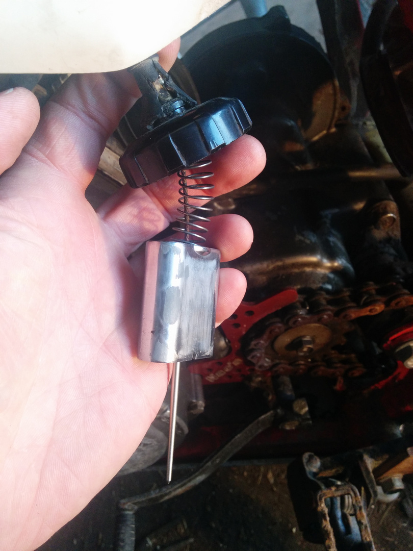

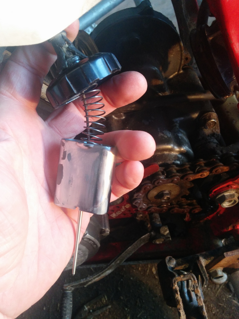

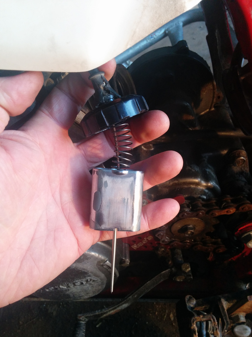

Here is some pics of my throttle slide. If you look its scuffed up in places and also the rubber boot on top has deteriated. I know the rubber boot should be replaced but what do you guys think about the slide?

Anyone have any thoughts on that slide? Is it still usable or are there going to be any problems with it sticking?
Where to get rubber boot for Carb?
« Reply #6 on: January 31, 2015, 10:43:54 AM »
If it was me I'd be worried about it causing a lean condition.

I'd replace it for sure.
 If a new carb isn't in the budget, another used slide should come pretty cheap if its the original 34mm.
I may have a spare slide here somewhere you could have. I'll check for you.
If that chrome flakes anymore you can guess where it will go. Not worth taking the chance for that reason or the sticking possibility.
