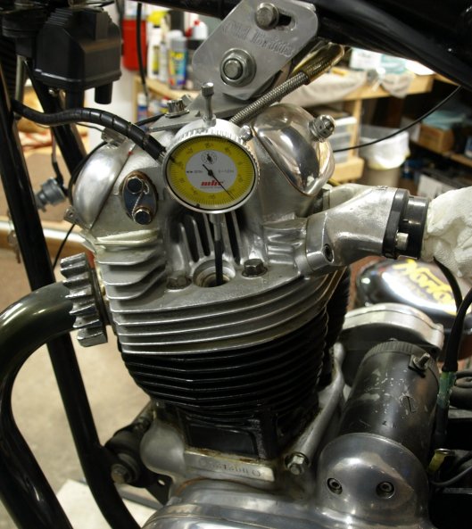

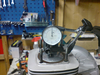

To get the TDC mark on the flywheel it would be easiest to use a dial indicator since a degree wheel can get in the way.
There are machinist dial indicators and mounting bases that would require the head removed unless you have a long extension on it or there is dial indicators that can be threaded into the spark plug hole.
JJ&A sells a nice one
