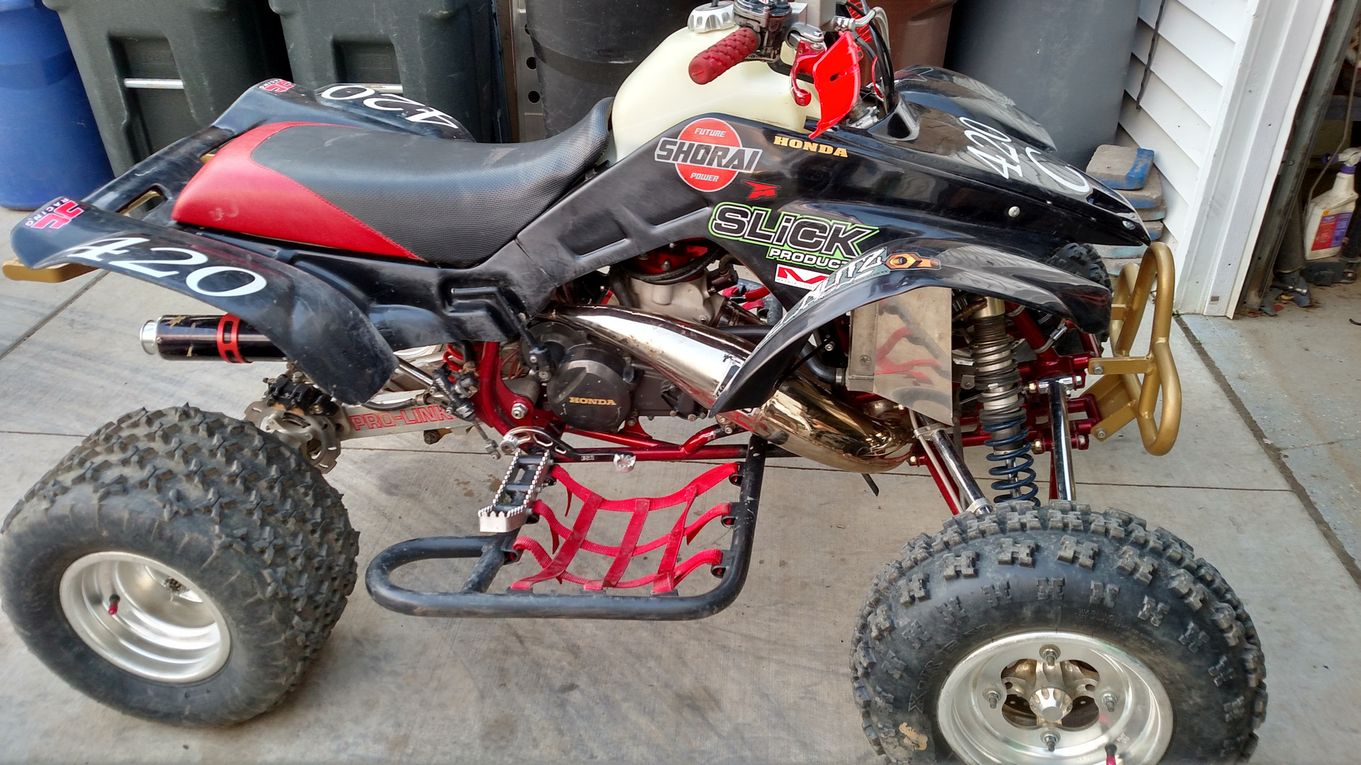

i hade to make a front mount on my arens. the frames were not made with the same mount as the stock frames were. ill look to see if i have any pics
Offline dem3500
Pipe Mounting on Arens Frame
« Reply #2 on: October 28, 2015, 10:16:57 AM »
This is the only pic I have at the moment. Basically I welded a threaded bung to the frame to utilize the stock mount.

Do you think if I used a piece of metal (1" x 3") to extend the mount to the hanger would work?
Offline dem3500
« Reply #4 on: October 28, 2015, 10:32:06 AM »
I think it would be mind of flimsey but it might work.

Give it a try. The only problem I can see might happen is the bolts act as a pivot point. Since the extender bracket would not be mounted in a triangle and may let the pilpe sag a little. It might work if you put some locktite to keep the bolts from getting loose

Does your pipe have a lower mount by the water pump? I used stock style mounts for the 2 on the silencer, and a TM Designs banshee mount for the lower...
Pretty sure Arens were built to use stock style mounts.

Yes it has a lower mount by the water pump. I might have to try the banshee mount i forgot about that hanger.
