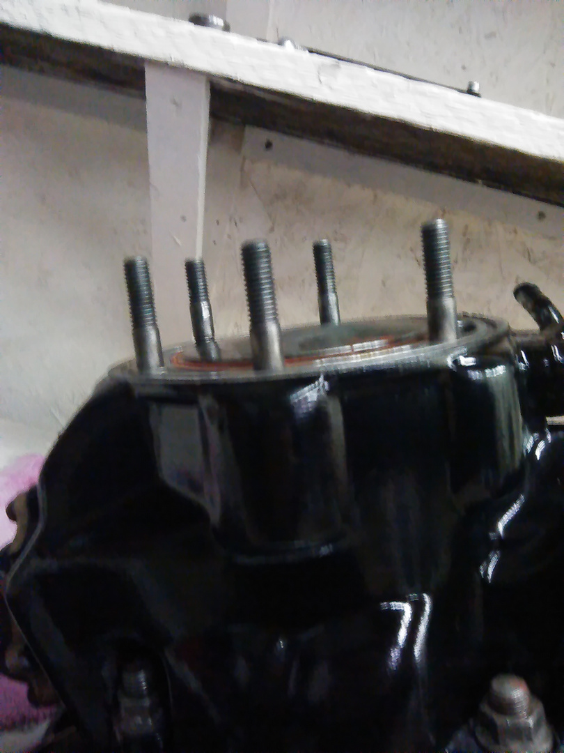

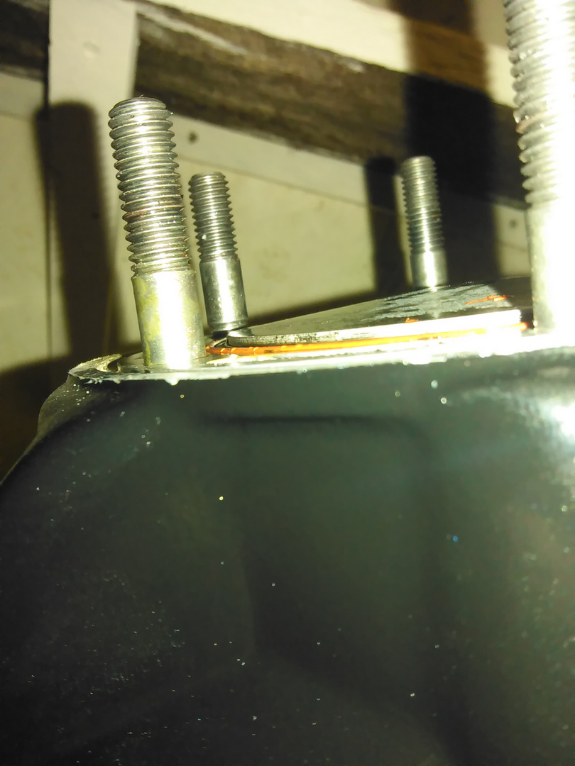

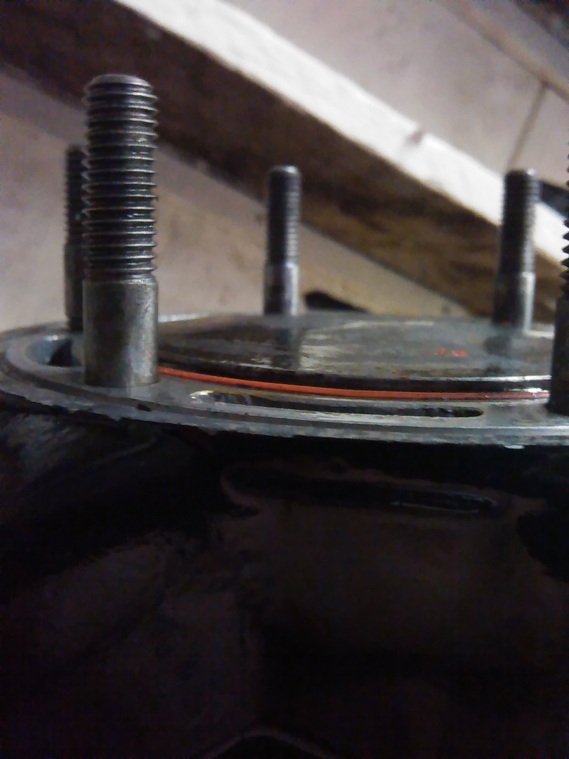

I'll save my question and issue for last and give the story leading up first. My plan was to race in the NECC Racing last spring but my dogs and sockets rounded off leading to a tear down, I put a near new tranny in, all new seals, bearings, clutch, and another long rod crank. So I finally close in on bolting the top end on and crack a beer about a half hr ago. I bolted the top end on and push the kicker naturally to spread the oil in the cylinder and make sure nothing is bound...well the Damon piston is now hitting the freakin head! The old crank was a oem long rod and this one is one with prox rod (109). I'm guessing I'll need to have another head cut but why did the piston clear Sith the old long rod crank and not this one? I always use oem base gaskets so that's ruled out

possibly a stroker crank? had that happen once to a buddy he ordered a standard long rod hot rods crank but it was boxe wrong and he got a stroker crank instead. his piston may have stuck out of the cylinder more than yours hard to tell with a pic. just a thought.

Is that an 85 / 86 style piston in there?  how thick is the spacer plate, and how thick are the gaskets?
awww man wtf
« Reply #5 on: December 18, 2015, 11:29:23 PM »
i would measure what ya got sticking out add that to the plate ya have an see what ya come up with also stick with what brand base gaskets ya got that could change things also , check esr website for spacer plate thickness needed .if not avalible they can be  cut. if ya got a 4mil stroker  it should be easy to figure out after measured

I used oem gaskets last time and also this time so it's not the gaskets. The piston is the same one it only had like 10 hrs on it. So I have oem gaskets again, and same piston/spacer plate. I honestly think the pro x rod is a small bit longer because when the cylinder was snug right before I cranked it down it wasn't bound, only when it was cranked tight

Spacer is approx 3/16

i dont have my 4mil motor here but my spacer is closer to 1/4

You have it apart that far would not be hard to measure the stroke. But if it is a stroker crank I thought there is same clearance issues that have to be addressed.

The 5mm or .188" spacer are the same. You will need the 1/4" spacer. http://www.tlr-online.com/trx250r/spacer_plates
