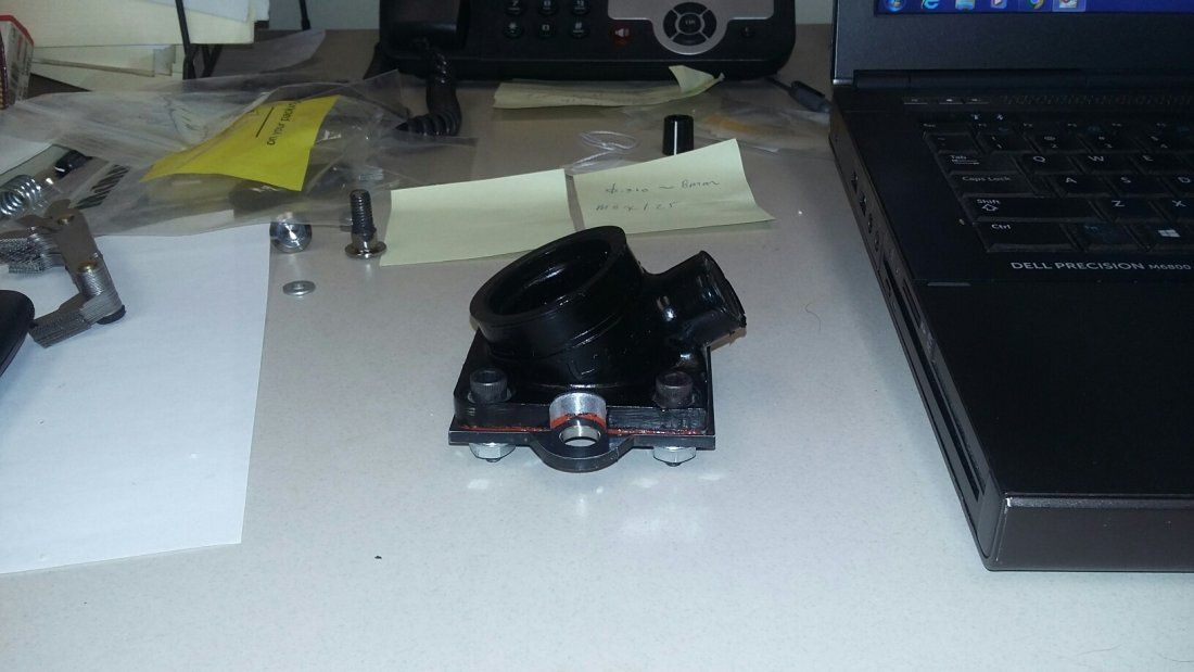

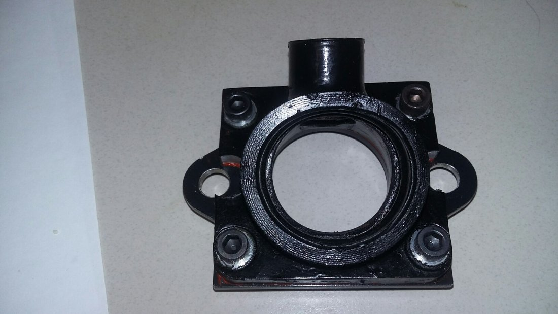

« Reply #111 on: February 21, 2017, 08:09:42 AM »
the intake roughed out:
new carb boot, which will take the angle out of the carb:

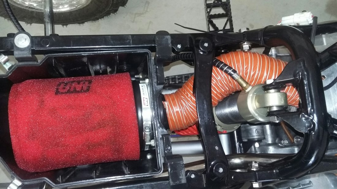

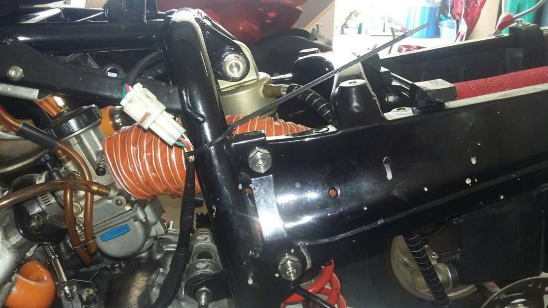

The foot long small diameter orange intake tube caught my eye.  I have not tested that long of an intake on a Banshee but I have done a lot of testing on the 125cc shifter kart engines, 250R Hondas and the 500 single cylinder two strokes that need to run air filters.  None of the aforementioned engines would have liked that long small diameter connector between the carb and air filter.  On the twin carbed Banshee with the stock air box, the development that I did on the Banshees did not like the air filter flanges that  had the 2.5 to 3 inch opening to the air filter.  They wanted a large opening from the plenum to the air filter just like what the engineers at Yamaha gave us on the stock Banshee air box.
There is a tuned length on the intake side of the engine just like there are tuned lengths on the exhaust side of the engine.  Many guys ruin a good engine package by neglecting to incorporate development and testing to the intake side of the engine.
On a small displacement cylinder like on the Banshee I think that the engine would like to see about 2 to 4 inches of about 2.5" to 2.75" ID tubing and then dump into a larger diameter tube that is at least 4 to 5 inches in diameter all of the way to the air filter.  The flange on the air filter should never be smaller than the largest ID of the carb to air filter tube.
An intake system like pictured above will  have 2 to 3 resonating systems.  Well developed engines will usually have only one resonating system on the intake side of the engine.  There is always one primary resonating system from the reed tips to the bellmouth of the carb on any engine.  If the distance from the reed to carb bellmouth is too short (where its tuned length is for a RPM that is out of range of the engine), the length of the primary system can be lengthened by adding some length of parallel or shallow angled tubing to the bell mouth side of the carb.  The system needs to dump into the atmosphere at this point or an air filter with a lot of surface area.  When the space confines of the bike does not allow us to place a large air filter at this dump point, sometimes we can connect the dump point to the air filter with a large diameter connector tube.
Sometimes the large diameter tube that connects the air filter to the dump point of the primary system can still resonate with undesirable effects and can be fooled by strategically placing a Helmholtz resonator to bring the total system into the desired resonating frequency.  Helmholtz resonators (the little white plastic tank that is about halfway between the carb and air filter) are used by the stock TRX250R,  TRX450R and a large number of intake systems in the automobile industry.

jerry, so what you are saying is; sound waves play an important role in two stroke intakes as it does in the exhaust?
this tube I am using does have a resonating effect as far as it has a small amount of expansion and contacting when the RPMs vary.  Increased intake volume and such.  does this make sense?
also, the adapter that comes from the airbox tapers down, so it will not stifle the intake airflow.  I can get a picture to better show what I am speaking of.
I was considering having a custom intake fabricated, but i don't have the time to design and run the analysis.  I used my most basic engineering approach and hope it will work as desired.
what are your thoughts?

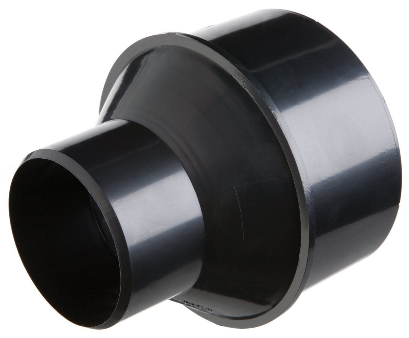

« Reply #114 on: February 22, 2017, 06:14:41 AM »
Jerry, Here is the reducer I used:
What are the approximate diameters for your reducer?
New Project: YFZ/Banshee Hybrid
« Reply #116 on: February 23, 2017, 04:44:13 AM »
Quote from: Jerry Hall;71874
4" ---> 2-1/2".  the length of the taper (45*) is, 1-1/2" long.

That type of flange design will show an improvement on a flow bench over a sharp edge entry, which is a plus on any intake system.  Resonance optimization cannot be tested on a flow bench. I think that your system in the picture may have a resonance problem.  The late professor Gordon Blair from the Queens University of Northern Ireland devoted over 40 years of his life studying gas dynamics, pressure wave activity, and developing computer models to simulate the gas flow into, thru and out of engines.  His graduate students are working around the world using his knowledge to develop engines and further develop engine simulation software.
The intake wave reverses sign when it gets a little past the large diameter of the flange and into the opening of the air filter, not when it reaches the bell mouth of the carburetor where the diameter of connector tube is too small to get a strong sign reversal.  My gut tells me that your orange tube is to long and probably wants to resonate a a frequency that would make a 4000 RPM engine happy not a Banshee that is happy in the 7500 to 10,000 RPM range.
The wave activity in the exhaust and intake of an engine is complex and does not always follow basic acoustic wave theory because of the gas dynamics involved.  An engine is a system comprised of many small resonating systems that all have to work together. If one of these systems is not cooperating it can have adverse effects on the whole engine.  The adverse side effects can be a loss of power, dips and spikes in the power curve, an engine that cannot be tuned, or symptoms of an erratic behaving carburetor.

b.   Eliminate the long orange hose.  Can you install the YFZ450 intake hose on that carb and attach an air filter to it for strictly testing purposes? The YFZ 450 intake hose ID may be too small for the first few inches because Yamaha used the intake tube to compliment / extend the length of the carburetor to get the intake tract length right.  If the YFZ450 intake hose will not fit or the ID is too small, try to use a clamp on foam filter directly onto the back of the carburetor.  (use as large of a filter as space will permit)   After eliminating the orange hose run the engine and tune the carb.  Did the power improve?  if not step c.
