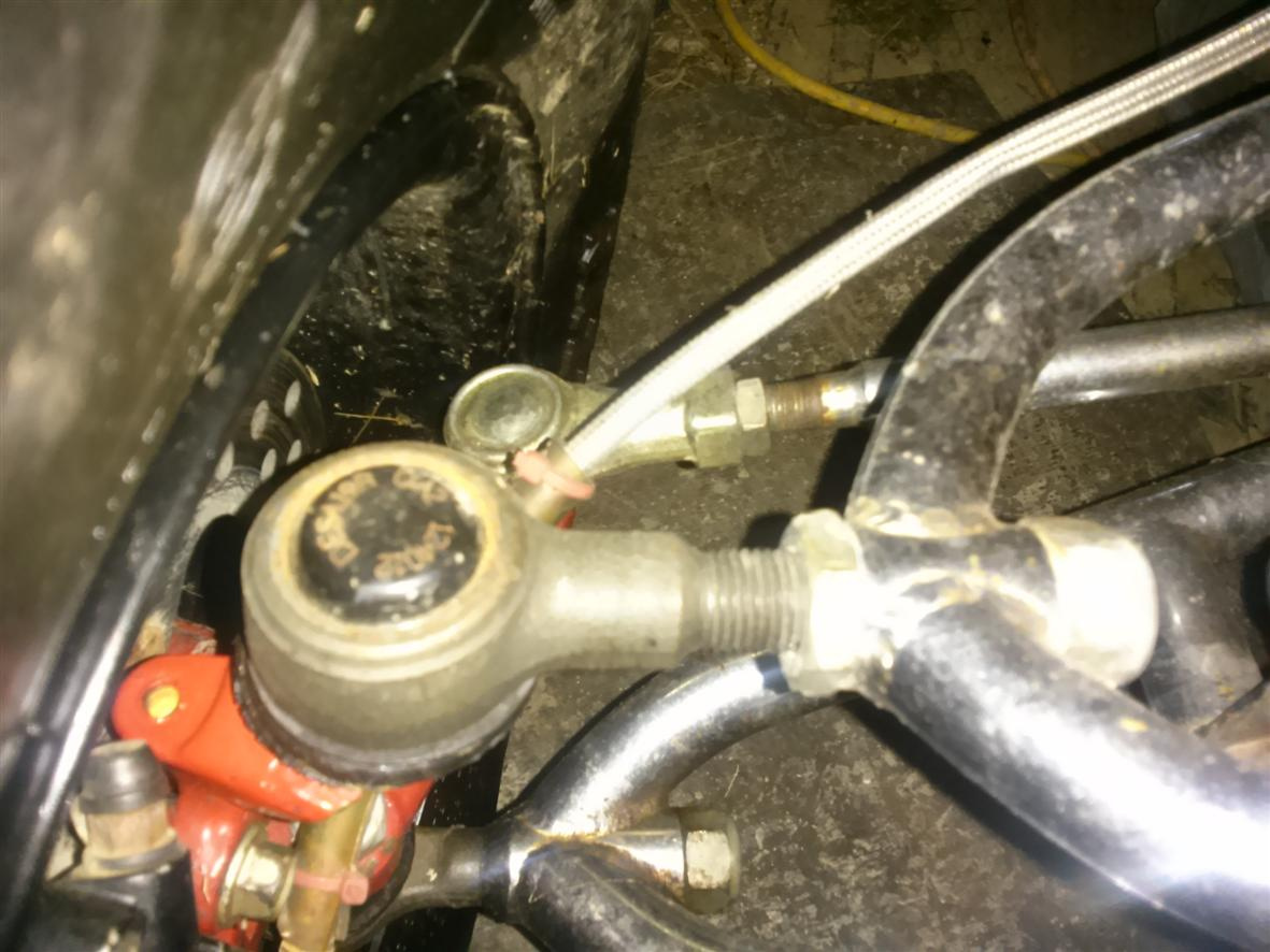

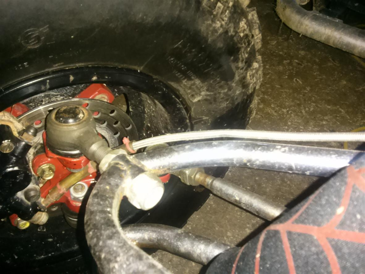

I used the ES419R that I got at autozone for my arms with a 14mm thread 1.5 pitch and they didnt work real well.  The problem I encountered was the 14mm threads were not long enough on the bottom arms for good adjustment.  They were about 1/2 inch shorter than the stock ends I removed making the nut barely get all the way on. There was enough threads on the top A-arm but after adjusting it to match for the bottom there were barely threads left for the nut there either. I red loctite'd just the nuts for a little extra peice of mind but I wont go this route again and Ive also got only about 5 hours of riding and the boots have already ripped.  Steering feels wierd with them too.  It was worth a try for $60 for 4 of them but I wasnt happy with the end result. I think the end needs a slight bend from where the ball joint and the threads begin also. Just figured I chime in with my experience with them.

Thats the problem I have now is that I don't like that the nut is barely threaded on. SO where can you get ball joints that are meant for the 14mm  arms?
