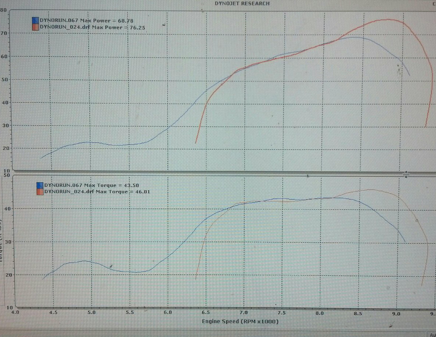

Here is my 363 Sphinx on Alky(with Shearer OOF) compared to 110(trx5cm)
DUNER -86 250R  Flinstone
Offline Rupp250
Post your quad & dyno sheets
« Reply #10 on: May 07, 2014, 10:02:53 PM »
One on Alky & OOF, other 110 and TRX5CM
« Last Edit: May 07, 2014, 10:34:40 PM by Rupp250 »

Rupp looks like a big improvement

Would you display the time VS HP graph of the above runs?
